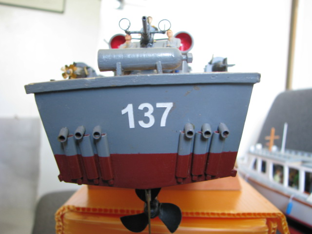

@jumpugly I can see some possibility for confusion here. The mufflers comprise an oval expansion chamber, with an output pipe below and an inlet system with a butterfly valve above. My mufflers were 1" in total size - the oval expansion chamber was about 3/4", which would make that chamber length about 36" in full size - with 8" for the valve above and a 4" stub exhaust below...
My semi-scale EeZeBilts are generally made with eyeball estimations rather than measured scale, but they seem to come out quite close. Here is a shot of the stern of a restored Elco - https://www.williammaloney.com/Aviation/PTBoat/PTBoatStern.jpg
and here is a pic of the stern of one of mine: http://eezebilt.uk/img_2344.jpg
I think they look quite similar. Note that in real life all these parts would have been made by different sub-contractors, and so non-critical measurements would have probably been slightly different. And of course continuous development would have occurred, changing various dimensions as a result of combat feedback...

AI is effectively a more sophisticated Google look-up, and is good for this sort of question. This is what I got back:
On the World War II Elco 80-foot Patrol Torpedo (PT) boat, the six external mufflers mounted diagonally on the stern transom are approximately 14 to 15 inches in diameter and roughly 3.5 to 4 feet in length. Each of the boat's three massive 1,500-horsepower Packard V-12 marine engines required two of these distinct, barrel-shaped "wet type" mufflers (one for the port exhaust bank and one for the starboard exhaust bank of each engine). Design and Dimensions: External Casing Diameter: ~14 to 15 inches. Length: between 42 to 48 inches. Internal Exhaust Pipe Size: The internal copper piping running through the transom and into the mufflers had a diameter of 8 inches, which matches the main exhaust manifold outlets of the Packard engines. The "Dimples": If you are looking at or building a scale model of an Elco boat, you will notice three distinct circumferential reinforcing ribs or "dimples" spaced along the main cylindrical body of each muffler casing.
My EeZeBilt Elco PT Boat is 1/48 scale - 20" long, and I made the mufflers 1" long, which looked in scale to me.
