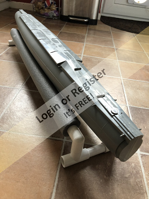

I just make mine out of half inch pvc with T's for legs. I also use the foam insulation that fits the pvc pipe. About 10 bucks total. Sorry this is the best pic I have. Keep up the good work! Dave
[{"id":"166248302632","name":"166248302632","caption":"","url":"https:\/\/model-boats.com\/media\/166248302632\/l","thumbUrl":"https:\/\/model-boats.com\/media\/166248302632\/s","isImage":false,"ext":"file"}]
