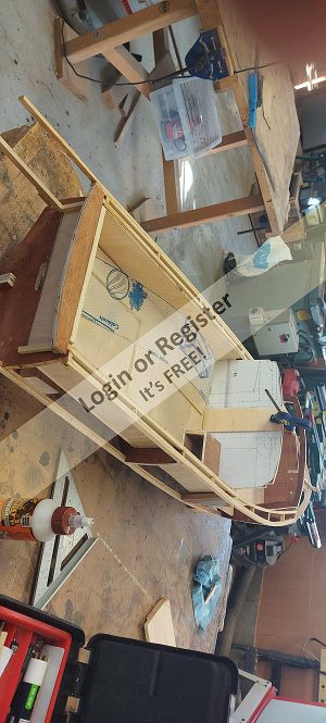

Ok when you are able the repair can be accomplished. At present you have a hull with a transom fully glued in place incorrectly. This is really the only part that need removing and is relatively accessible.
I would use a coping/razor saw to carefully cut thro the joint between the transom and the top deck. Leave the tabs in the top deck.
Then cut thro the joint between the servo tray and the transom. Ignore the tab. The round hole will now be open at the stern so you may need to temporally clamp a piece of wood 1/8"x1/4" underneath to support. I assume this is to give access to the rudder. When finally finished you may need to open the round hole to the original diameter with a round file.
Then cut off the join between the bottom stringers and the transom which can then be removed. You could cut round the join or cut flush and remove the stringer bits later.
Get some large rubber bands ( I get mine from discarded Postal services rubber bands) and put them round the hull fore, middle and back.
Insert the two side skins and align with the bow and hold in place with the bands (you may need to pin in places).
At the stern mark the edge of the skins with the bottom stringers and the servo tray.
Measure the thickness of the transom and use this to mark the correct position on the servo tray and cut using the outside (stern) of the marked line.
Try the transom for correct fit (top to bottom) and carefully sand (using a flat sander) until you are happy it aligns on both sides with the side skins.
Refit the transom to the underside of the deck and the bottom stringers. This will again require some careful sanding so take your time. It sometimes helps to take a break at this point and return refreshed before proceeding.
When happy glue the transom back in place. When set cut the stringers flush with the transom and sand smooth
To support the servo tray I would use a small fillet 1/8"x1/8" of wood underneath the tray, attached and glued in place.
You could order new parts but that will require much more work to remove the parts already glued in place and once built there will be no evidence of the repair I am suggesting.
Hope this helps for when you are able to proceed

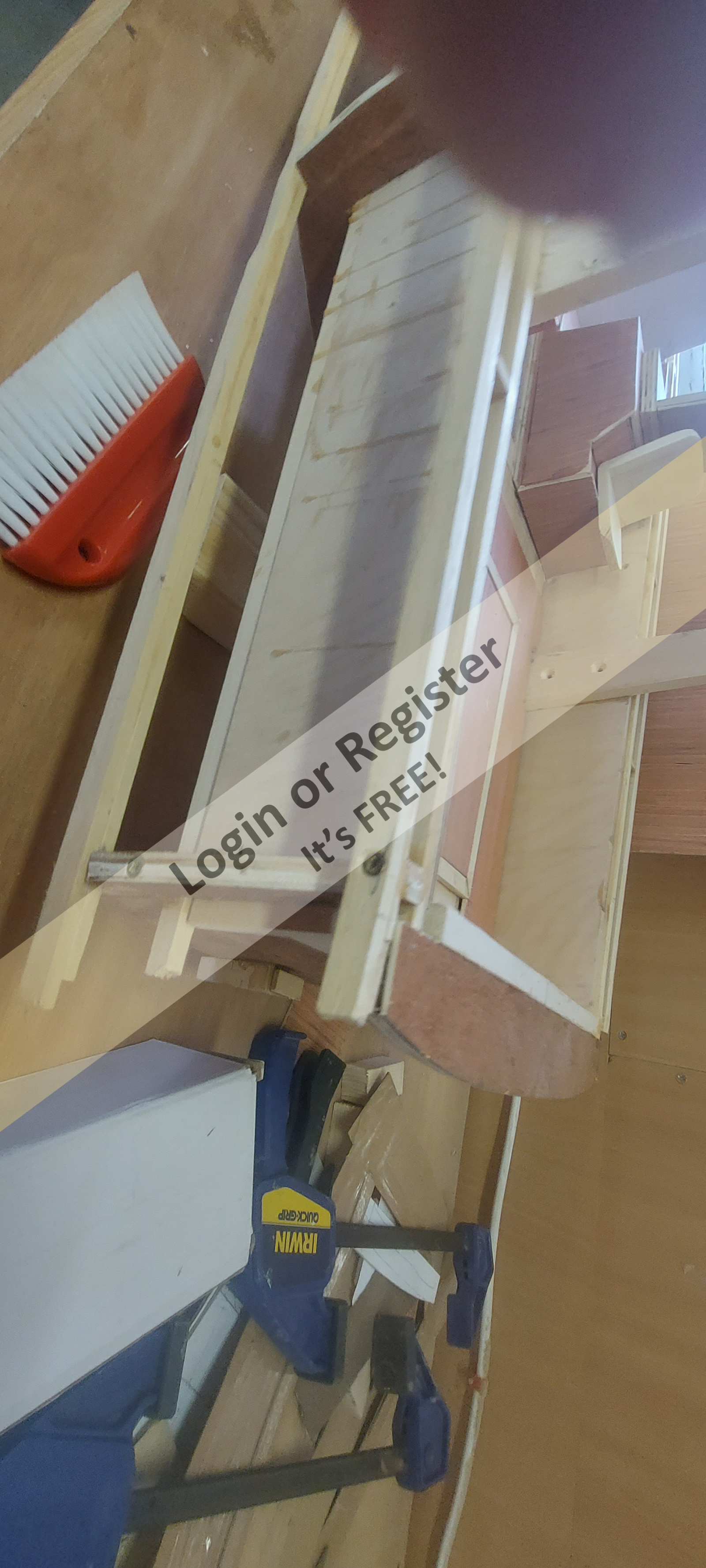

Has Anyone Built The Wooden Boat Company Police Launch?
Just looking at the photos. Is not the transom in place now just an inner skin, and you need an outer transom skin on as you complete the hull.
My Huntsman is like that see pics below for an idea what I mean I apologise for quality.

The sloping rear transom is there for a reason and, sorry, but you will need to remove the rear parts and rebuild as designed and aligning with your side skins. Your model will tend to dig in at the stern if you leave with a vertical transom and may be swamped by a following wave or when reversing.

Looking at your model and reading the build instructions, in step 6 Part 8 the rear transom should be angled and yours appear vertical. This might explain the issue. All models will require some fettling to final fit and doing a dry fit is sometimes useful to identify what may be required before finally glueing in place.
I would check that the side skins are big enough the fit. If not you may need to alter (angle) the rear transom.
Thank you for your replies to my post.
The reason I asked if anyone had built the model is because I wanted to find out if they had the same problem that I have experienced.
I contacted the manufacturer via email explaining my problem. I have to say that they were of little help and did not seem interested that I was having trouble.
My problem is that when I came to fit a part at the stern it was too small for the hull frame that I had built so far. Their only suggestion was to send me a second identical part and said to cut the two parts down to make one bigger part so that it fitted. I received the part and made a new part from the two and fitted it okay. Moving on with the build I then found that another part was too small. Knowing that it was unlikely that I would get much help from the manufacturer I did emailed them again saying that I was disappointed with the kit and that I felt I had wasted my money and had stopped building the model. I did not receive a reply.
The frustrating thing for me was that if the parts were the correct size, which I suspect they were, I could not see where I had gone wrong when building the first part of the hull to cause the next parts not to fit.
Now having had my surgery I hope to take another look at the kit and the problems in a few weeks when I can start to use the hand again.
I have attached the same images that I sent to the manufacturer for members to see.
