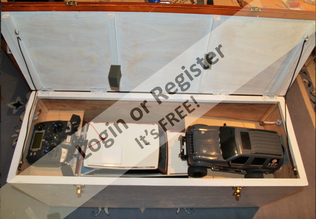

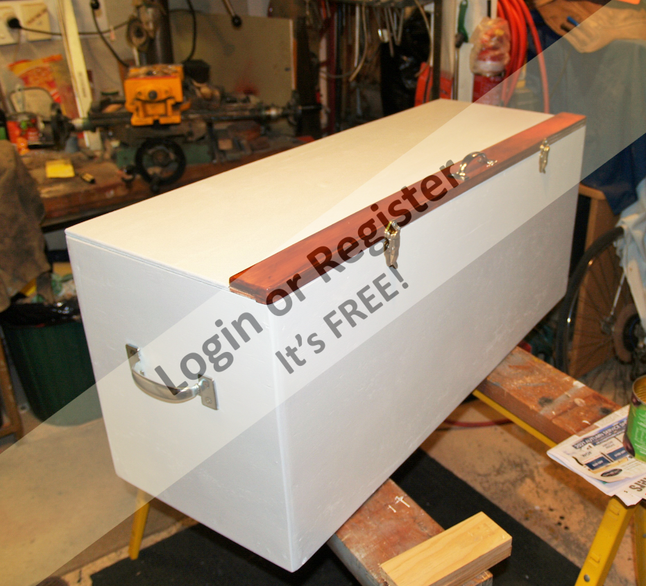

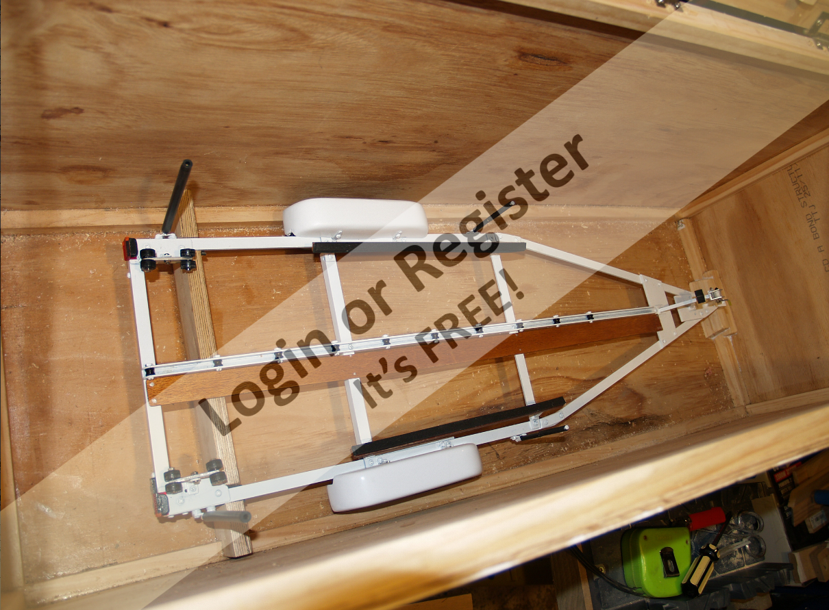

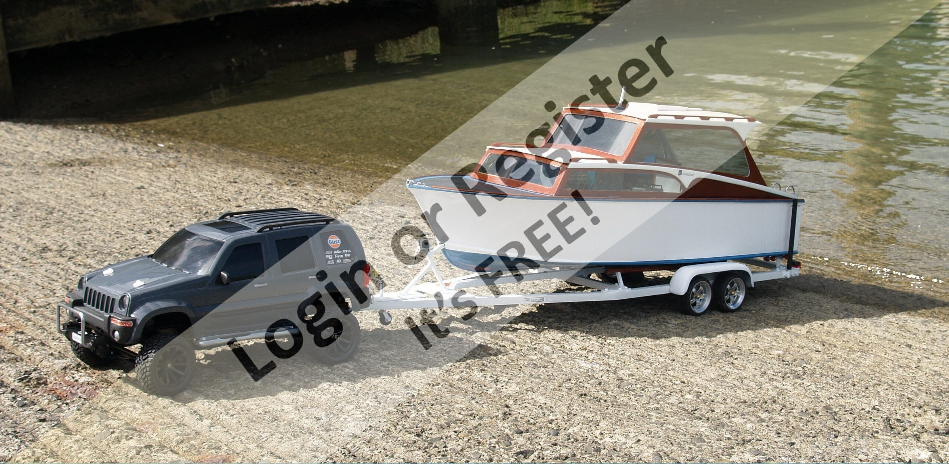

Managed to fit everything into a large box which I can carry with a padded shoulder strap. Complete set-up weighs more than the box. Boat and trailer clamp down to the box with tabs, and there is a sling which fits under the trailer to get the boat in and out. Whole boat/car set-up is 5ft long, so a job making it compact enough to carry. Easier to carry with 2 people, as it's fairly large (especially at my age 😀)

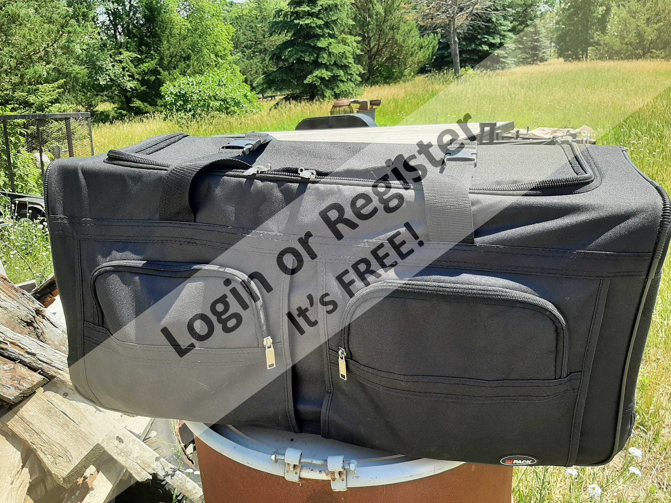

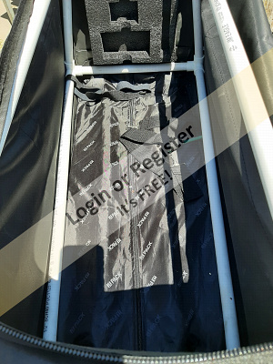

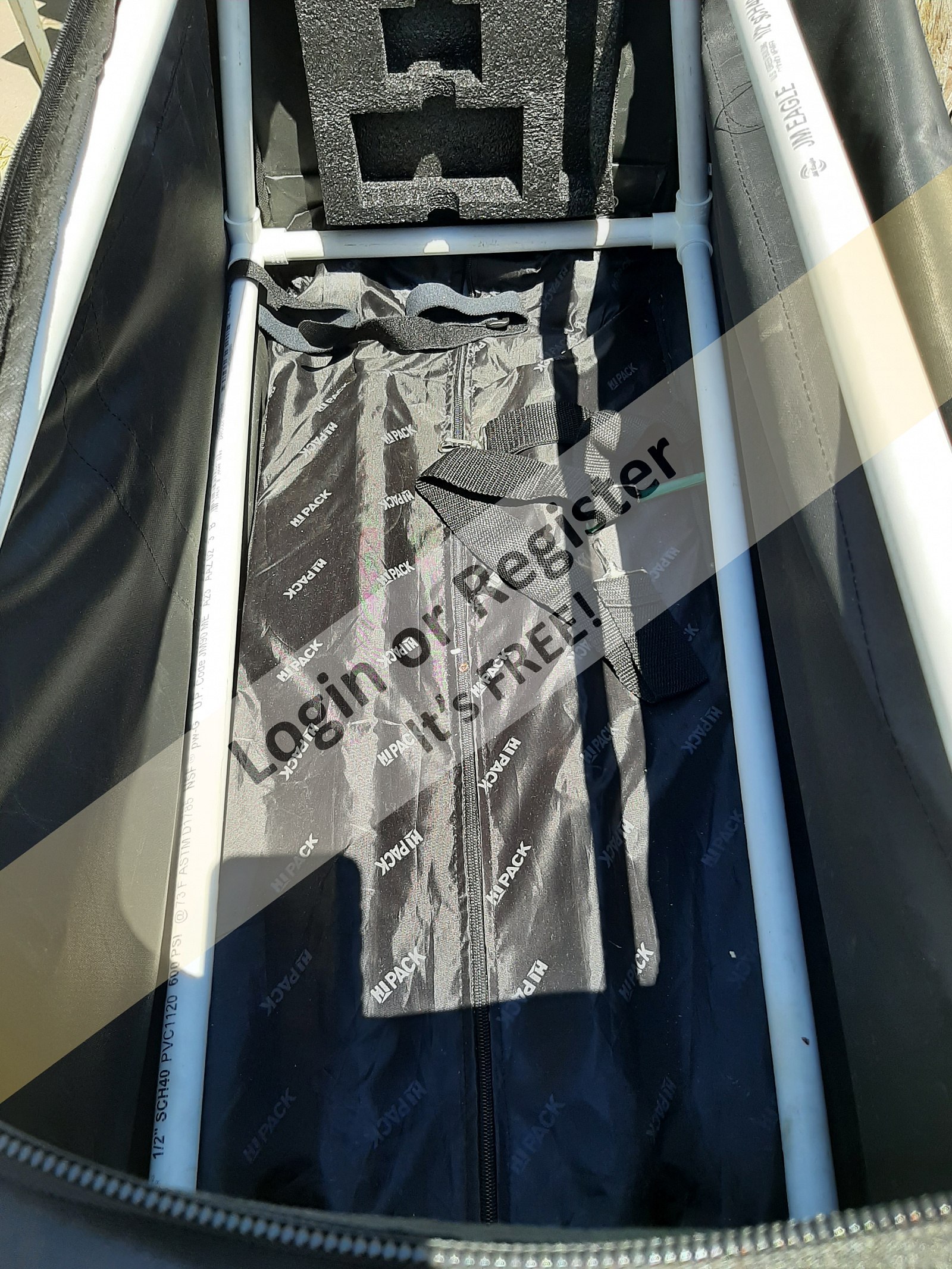

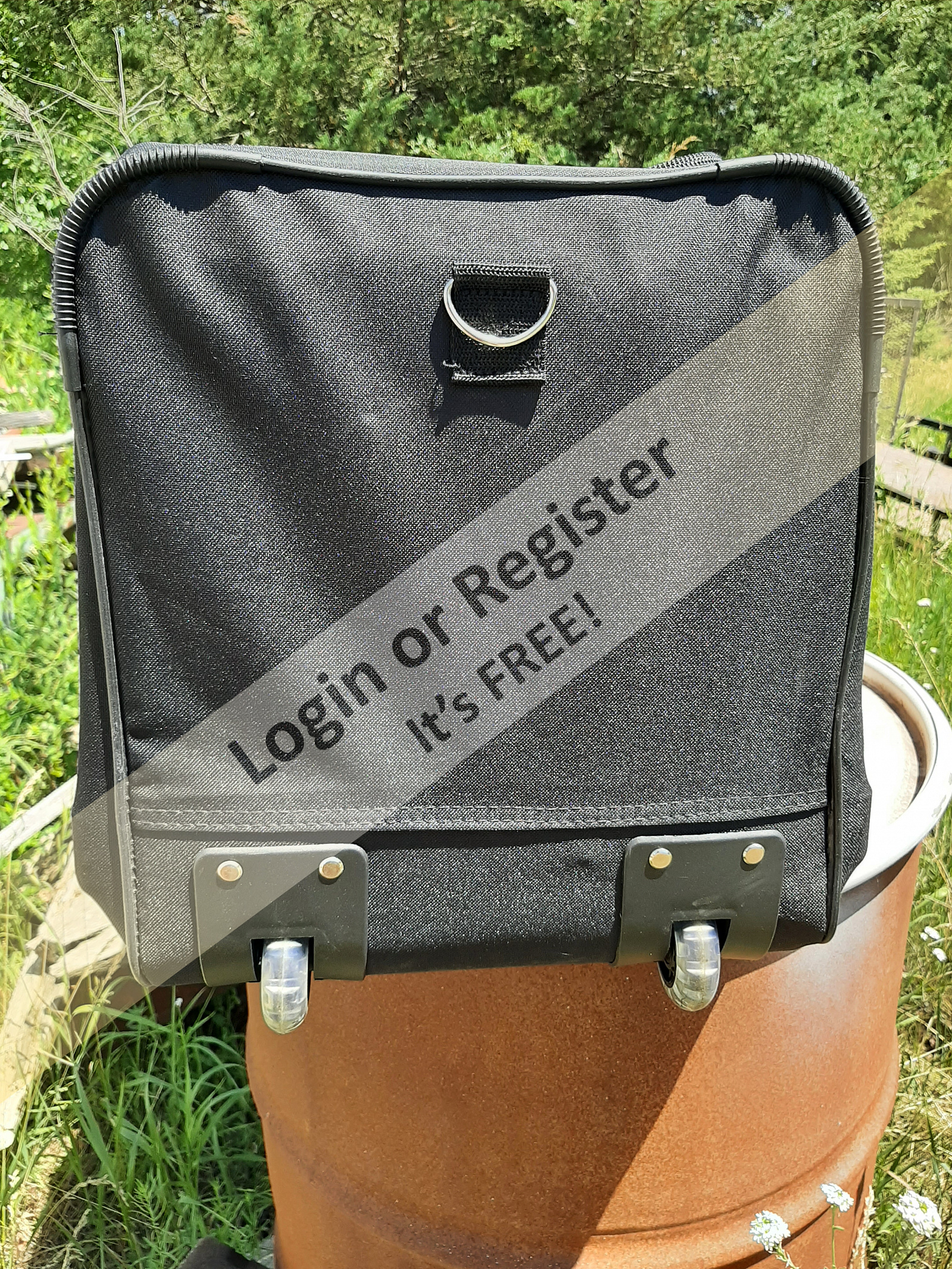

Now that I have shown the examples of my much more talented club members designs, it's time to show my solution (maybe more in line with the OP's notion of "simple").
I have taken a wheeled Sports Equipment bag, lined with with a PVC frame, and I strap the boat on its base to the bottom of the PVC frame. The bag has wheels and an extendable handle for transport.
Not elegant, but it gets the job done. It has the added benefit of exterior zippered pockets to hold batteries, etc.

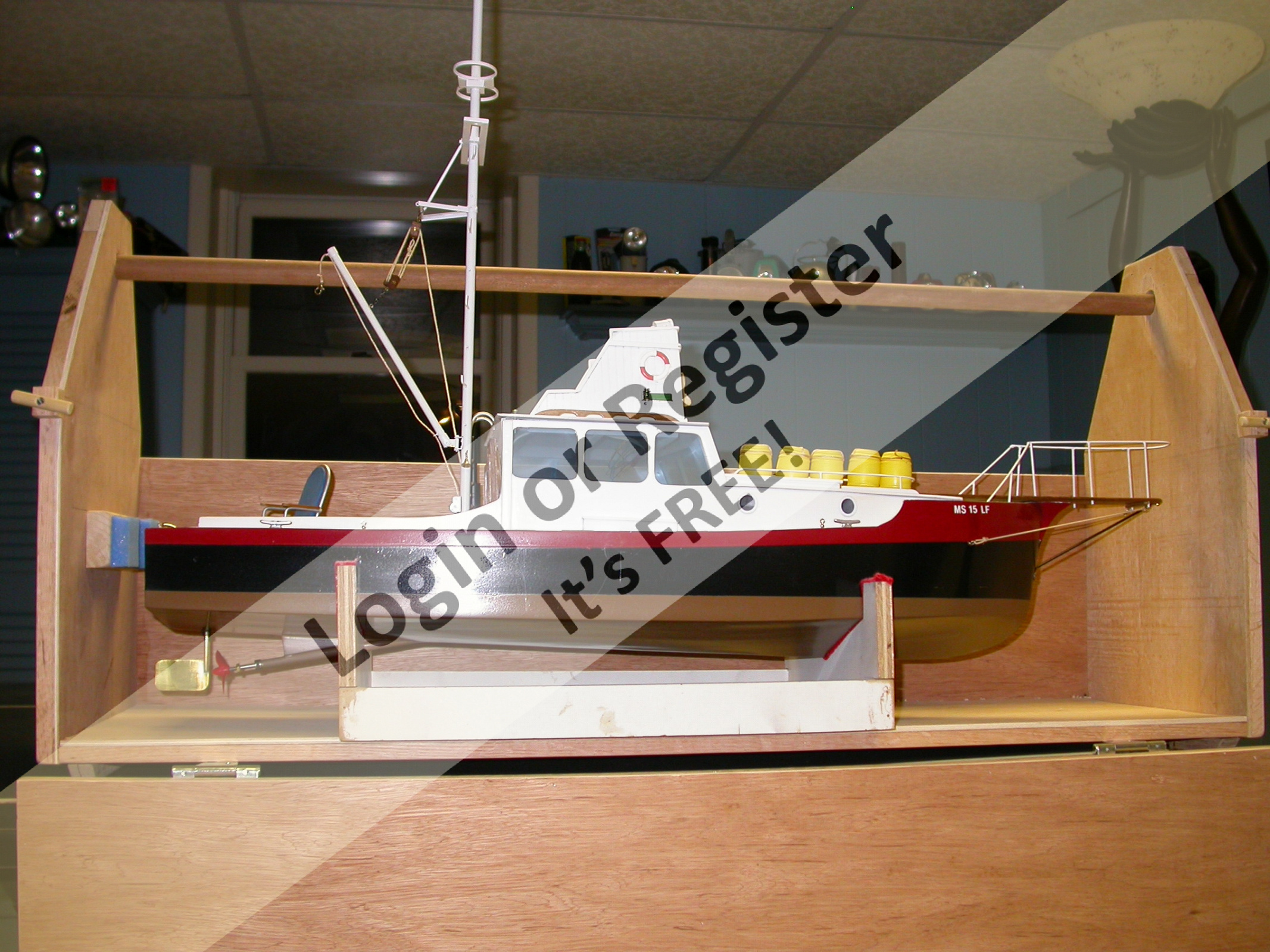

Hey all!
Very good ideas! Thanks for all your tips!
As I don't set up all my boats and keep the rest on a rack in my ‘workshop’, I will create a closed version of each. It is important that they are kept away from dust.
Sliding cover, folding versions . .simply brilliant ideas. Thank you!
Bb Michel-C.
Ps: My first box at the time for my Commodere ‘Michelle’

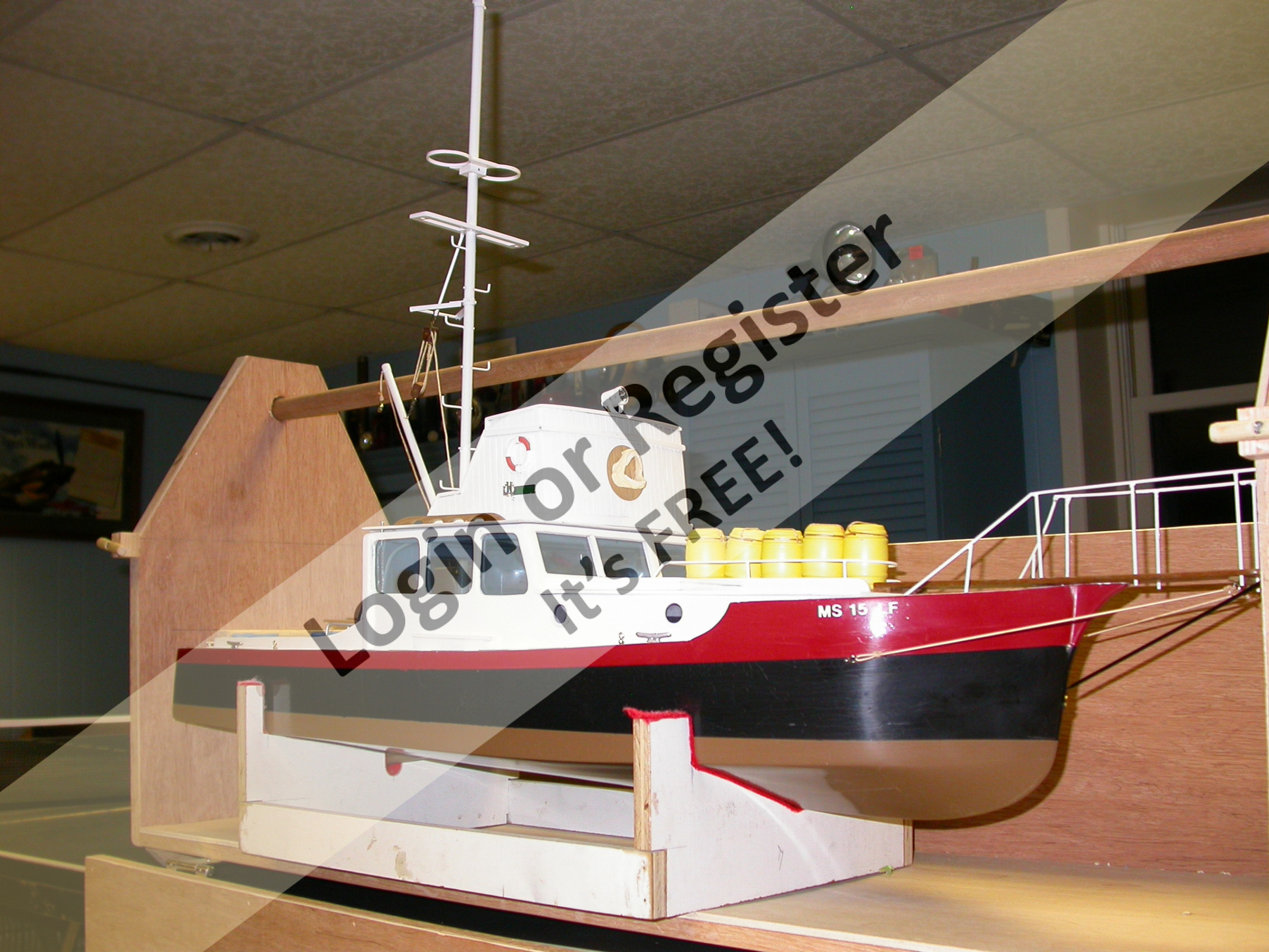

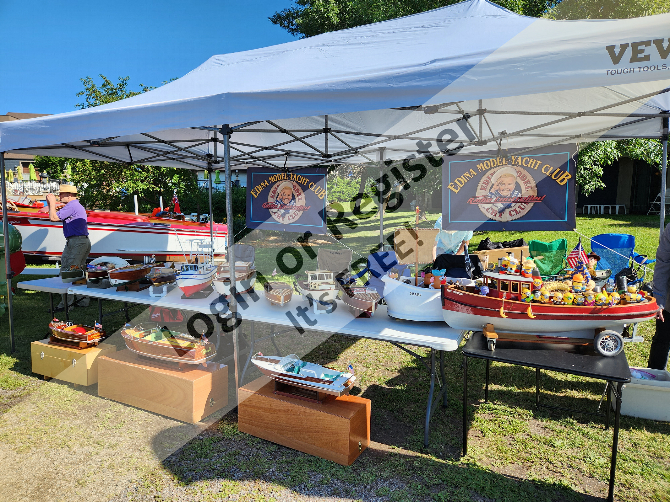

Again, not mine. But here are a couple more examples of transport cases belonging to fellow club members.
The two on the right have recessed handles on the top, so they can be stacked. The top lifts off leaving the boat in it's cradle on the base.

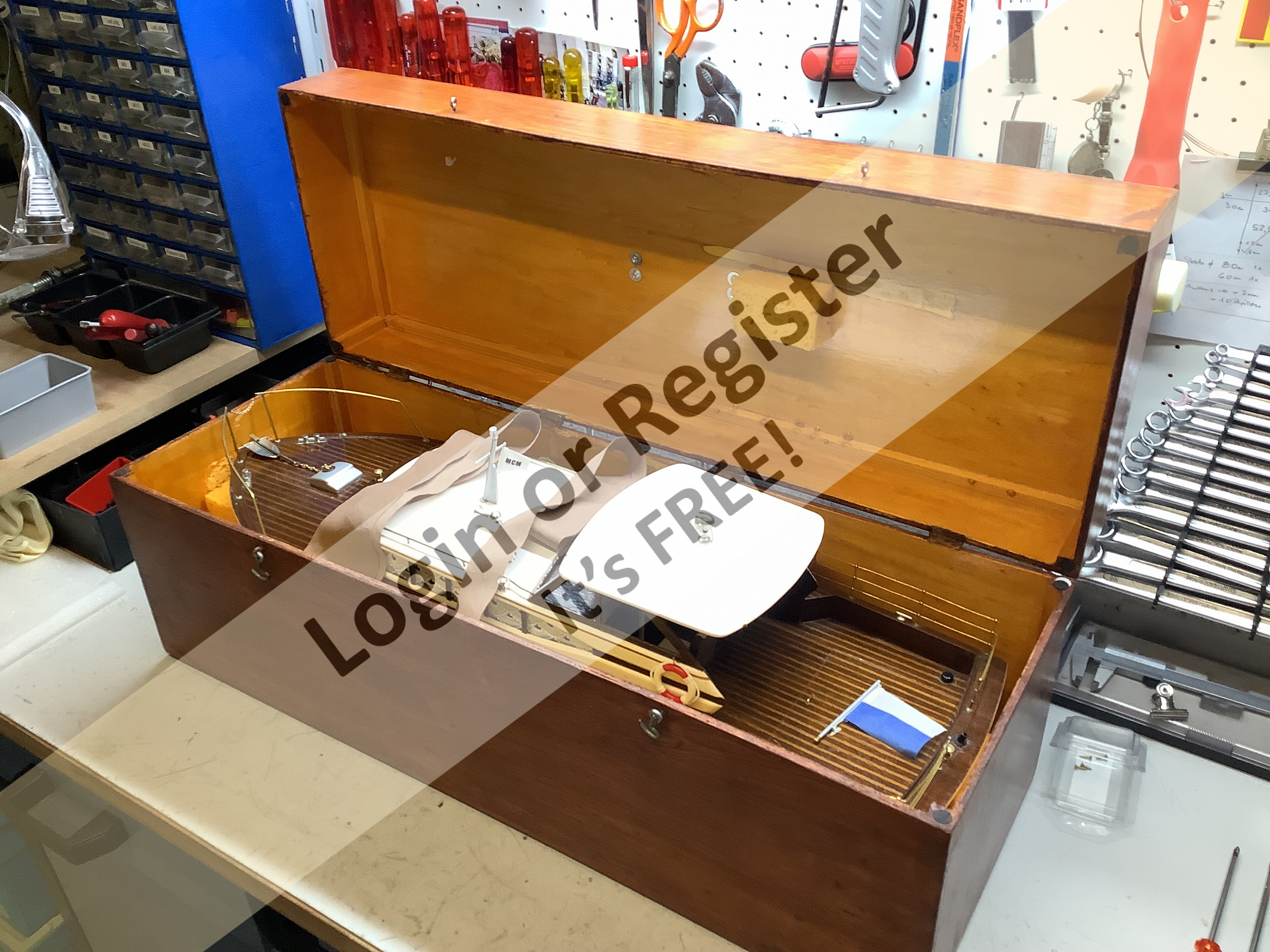

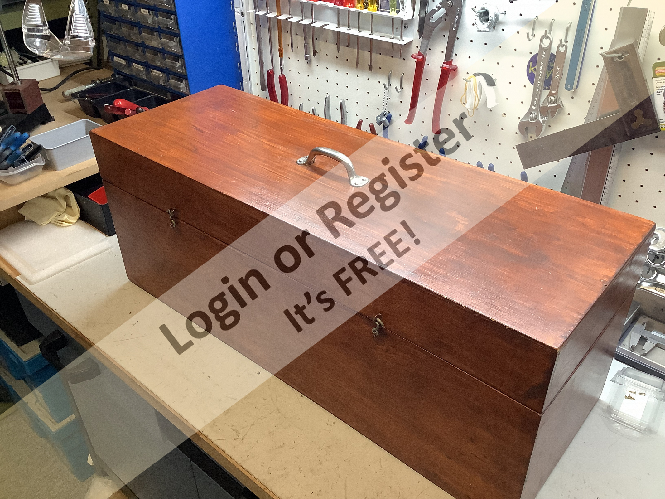

This is not mine, but it belongs to a fellow club member.
He has done a beautiful job creating this case.
He has used piano hinges, and has 3D printed the cradles that hold the boat secure.
This is beyond my skillset, but should give you an idea of how a well built carry case is done.
