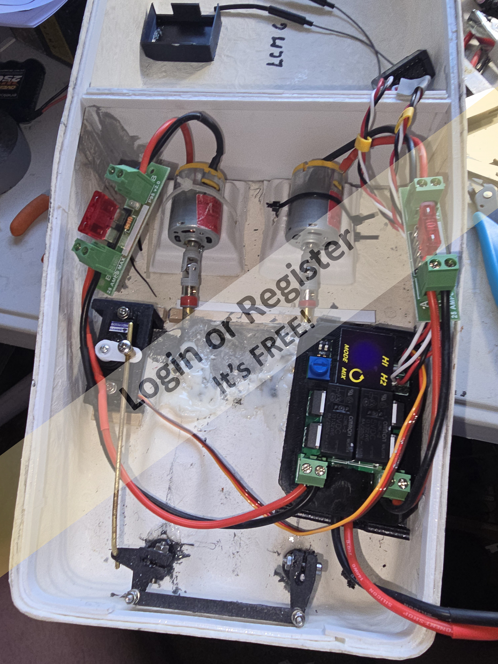

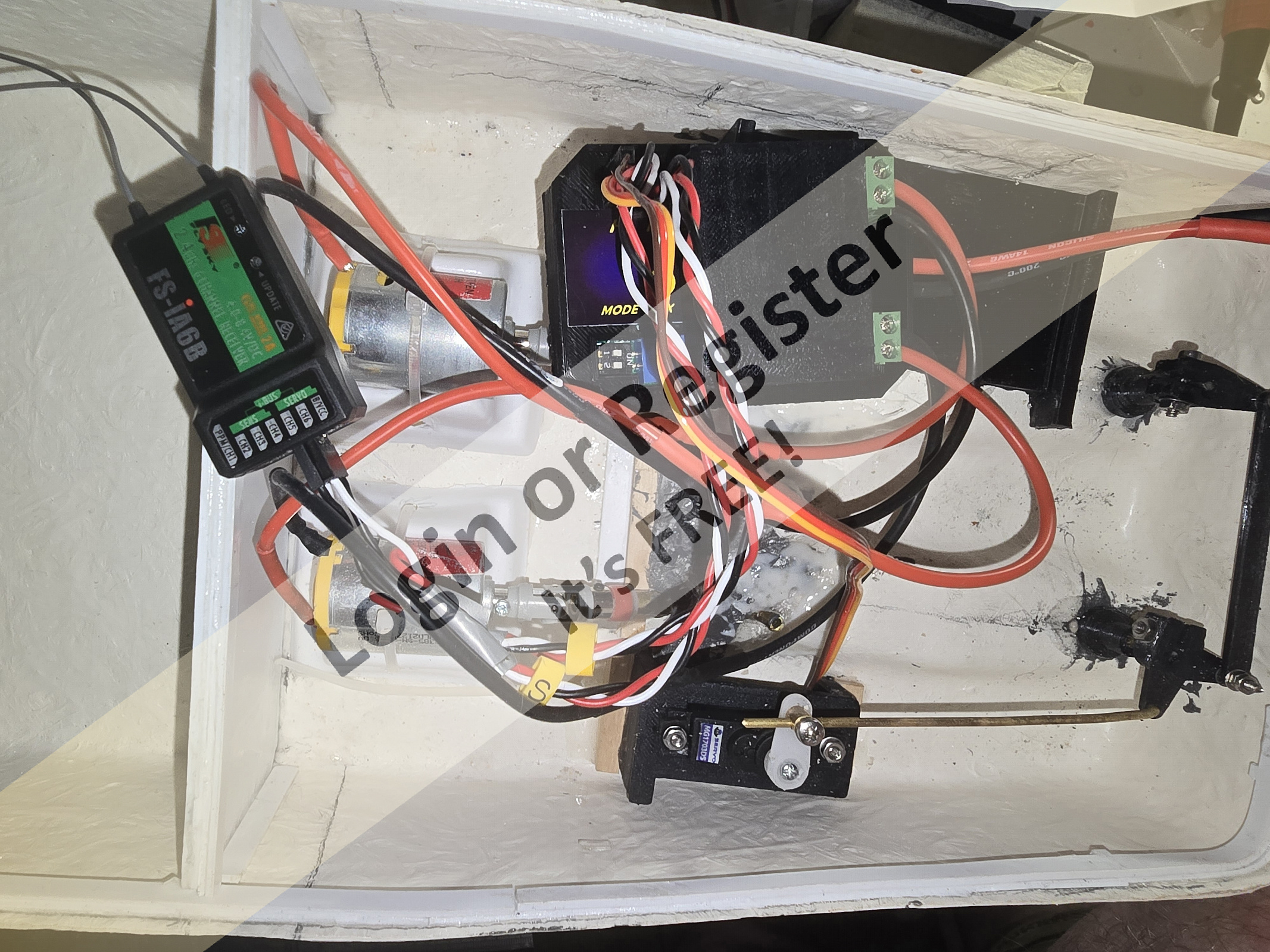

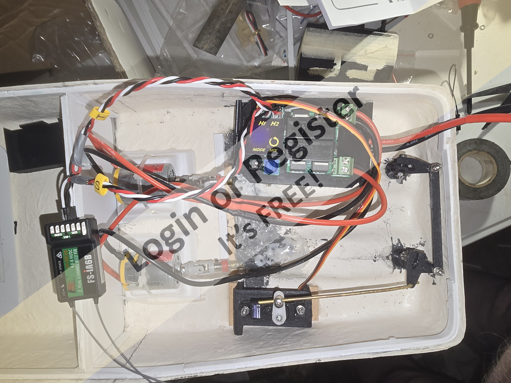

Job done! All wired up and working well. Shafts need greasing but I will wait until the paint job is done befor filling with lithium grease.More photos and info on LCM6 build thread. There is a lot to fit in a very small space..

If you don't want to use a separate RX battery then just reconnect ONE of the red wires from the P94, but NOT BOTH😉 and all should be well.
Unusual channel selection on the RX though!
I prefer to use stick controls Chs 1 and 2 or 1 and 3 for motor and steering.
Let us know how you get on.

Hi Doug. Hope these photos are clear enough. I was wondering where the power to the receiver was coming from with no +V connected, I didn't want to try anything drastic in case the magic smoke appeared!

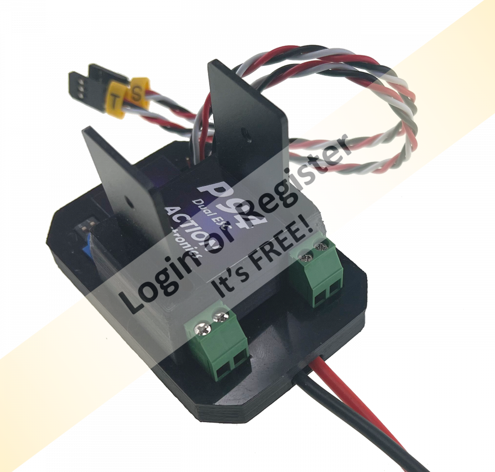

Third: the physical differences are:
The P94L is the 'Lite' version with 10A rated FET output transistors per ESC.

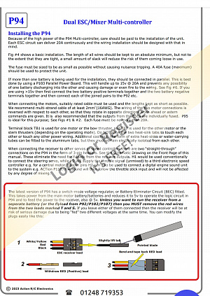

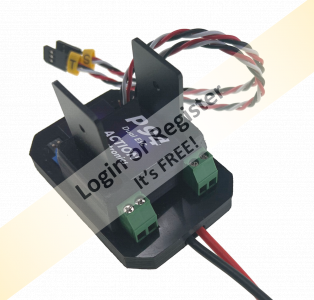

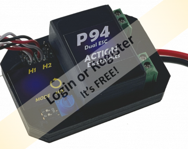

The P94 has different FETs rated at 20A and needs two heatsinks which stick out through the lid of the case. See attached pics.
Please post photos of your version and wiring, or a wiring diagram / Sketch.
