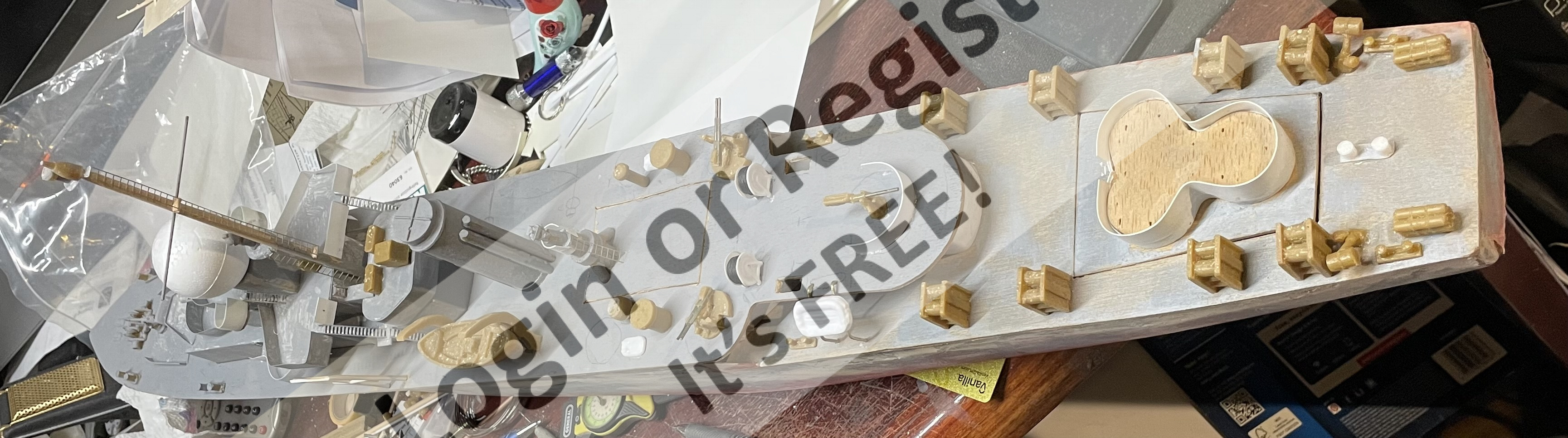

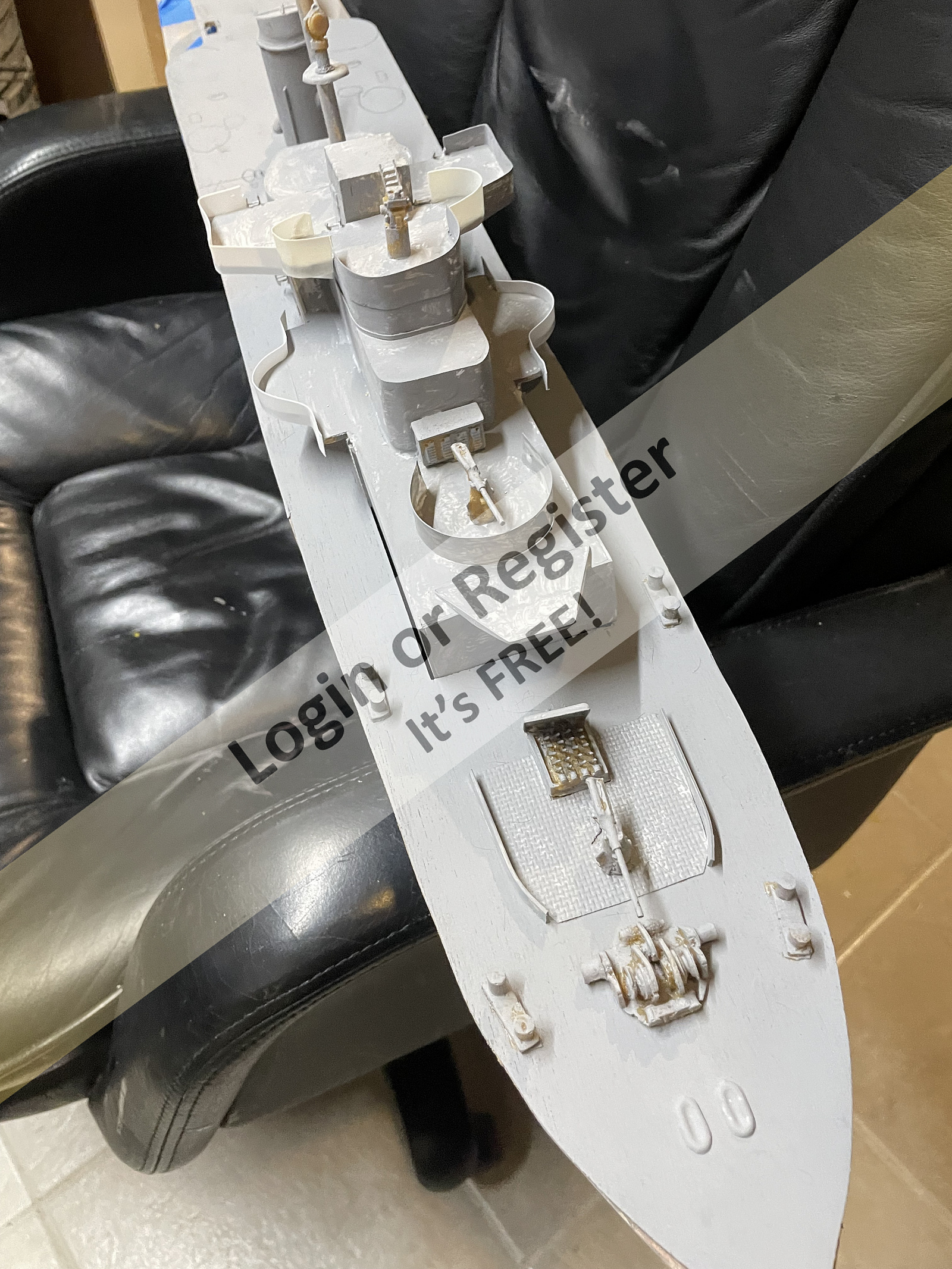

Bad Tacoma class frigate added some cast resin parts found a foam ball that simulates a radar dome I saw on a pic of the ship. I attached the pic. I might finish this ship this week and put it on Facebook n eBay.
Need done primer spray n more Bondo putty for the Crockett to move on. Building mast using tubing not wood. Debating on lighting the mast now with hollow tubes. If I can get it primary painted this week if weather holds.
Howard hager

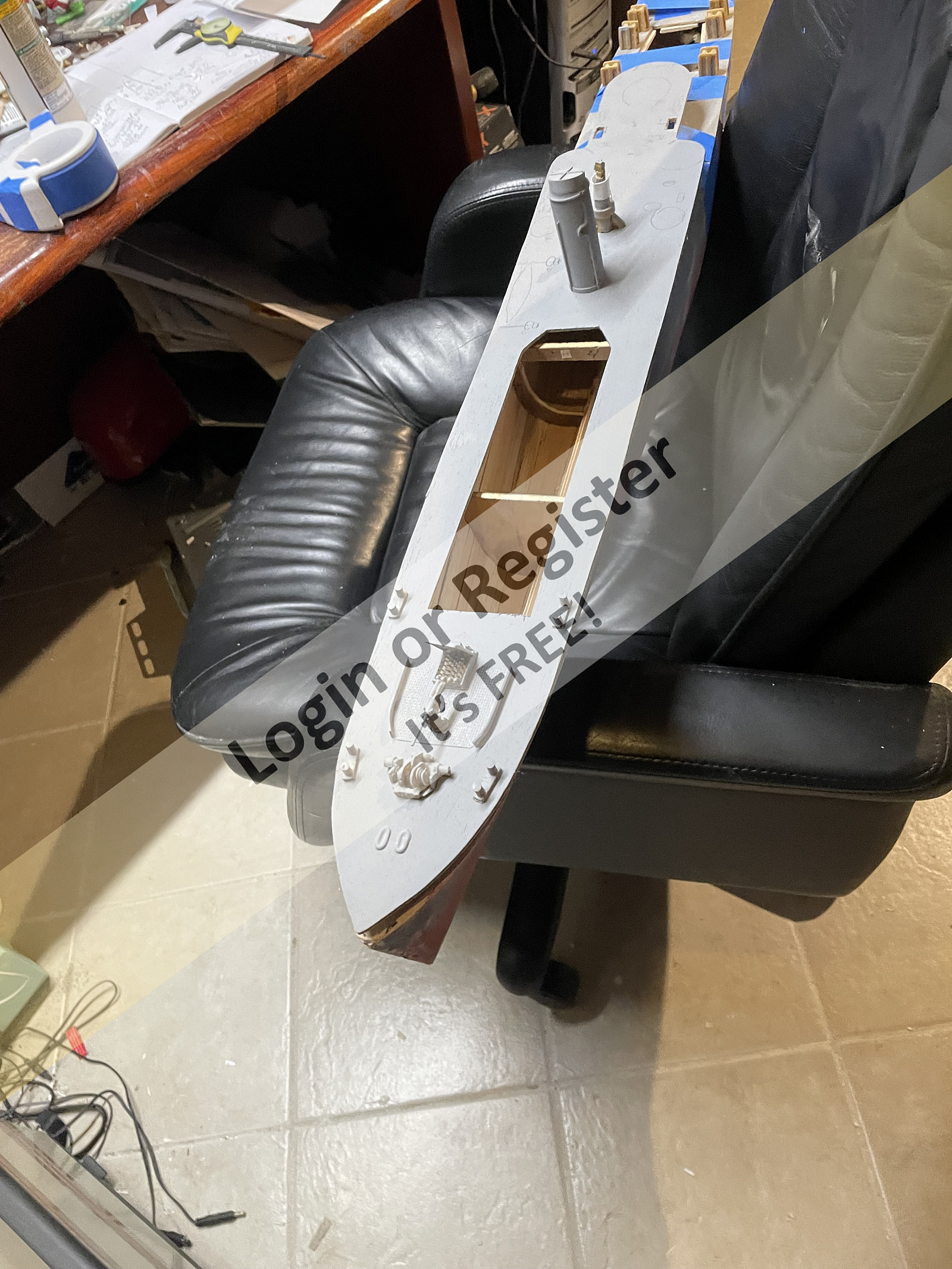

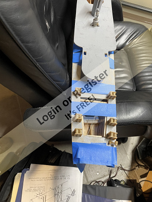

Dumas Crockett build
While waiting on 3rd epoxy coat over fiberglass I went back to the BaD shop. The hull was ok after gladding. Not a lot to clean up. So I put rudder n servo in the ship. Then glued diwn the rear deck section. Masking tape held it until glue dried. Went Bach and trimmed deck when glue was set. Started touch up with bondo patch tube. I’ll sand the bondo tommorow. Then glue front deck. Add detail parts and if lucky do a primer gray spray. Touch up on sanding. Then paint n detail, add windows n hand touch diff color paint where needed. Once done propellers attached and done. Then I’ll sell that one. The Crockett needs another day to set the epoxy. Then sand n fill time again.

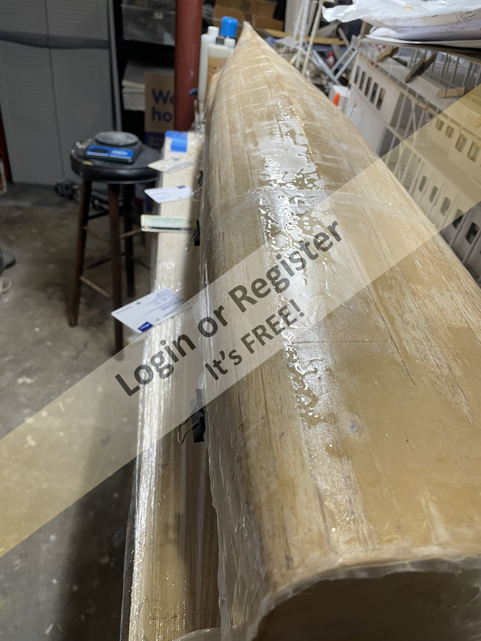

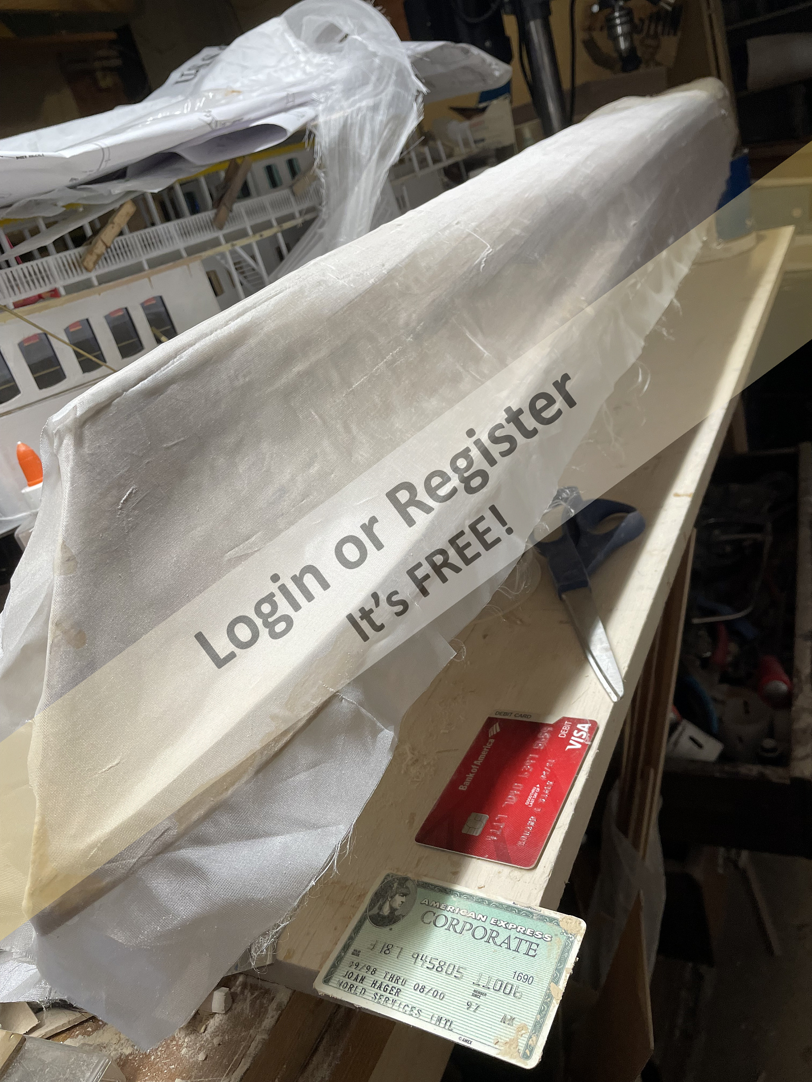

Started to lay cloth on wood used 3m spray to hold it. Doing half hull at a time. I’ll do other side next. Once done I mix epoxy n go. This way I smooth the glass. Once epoxy goes on I will use an old credit card as a trowel to smooth the glue on the glass. If I get it right my sanding n filling is a lot less. If I find depressions or holes to fill I’ll use the tube of Bondo patch. Hopefully the hull will be done this week.

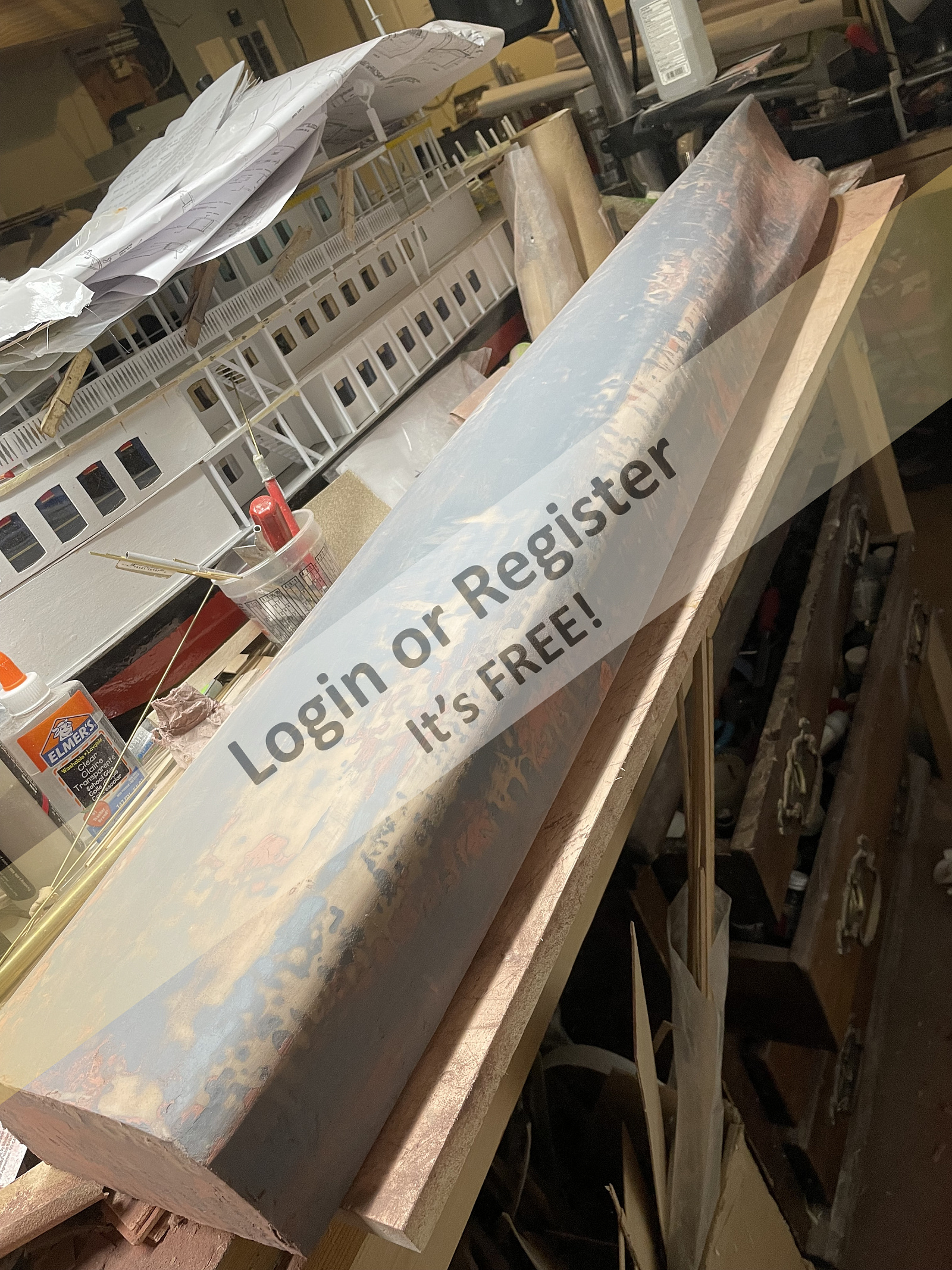

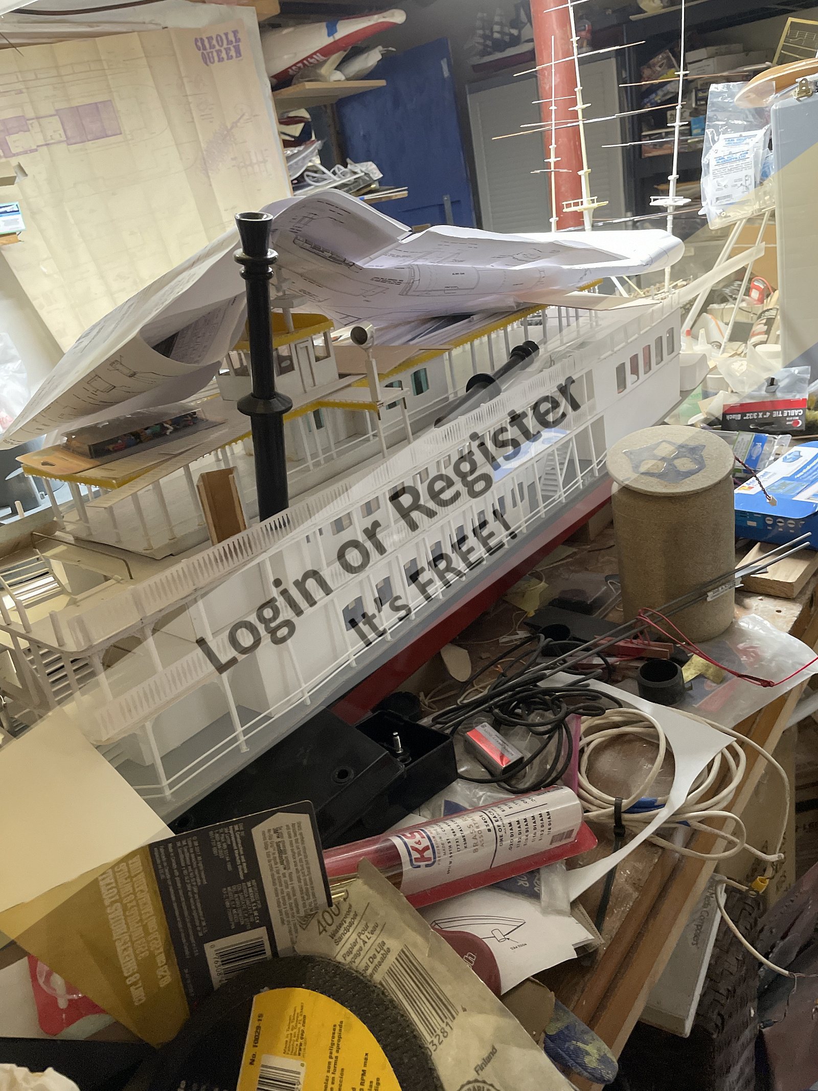

Lots. I might just part with some not even finished to clear the bench. I have a USA constitution large scale n a cutty shark. Rigging mostly to do on them. Too many models. I saw the 3 m trick on here n tried it. Yes tacks cloth. Last model I used really light this one a little heavier, which I used on steam paddle boat hull. It’s easier to tack n trim if it’s heavier, don’t know the once’s. It’s a rainy day here so I might have time to start glassing. I like the building of planes n ships. But once done they collect dust. I have a big PT boat, SS United States Glencoe, paddle side wheeler, space Odessa 2001 ship, electric heli and more. On a desk that was used in sea quest, a large electric RC plane w flaps n lights. It was the dude door control panel. It’s a mess here. I’ll take pic. Oh the Nako is a space plane that was at NASA when ussr wall came down. It was left there n I got it from auction. It was ussr version of a future sst plane. They were trying to build for fast internet country travel. There is a ton more here in these two rooms n garage. Been building since 12 years old.
Howard hager

#12 1
Hey H!
What am I looking at? A Mississippi sternwheeler?
I can't get enough of it . . .❤️❤️❤️❤️
You still have some work ahead of you!
Good luck!
Final sanding last nite I’ll cut the glass cloth n stick it with 3m glue spray. Epoxy it this week. I glued front half of deck last nite too. Rear half to flat. Trim n sand deck then that is done. Also put in rudder blocks n drilled pilot hole while rear deck is off. Enough room to get rudders done when deck on. If not I’ll do some sawing

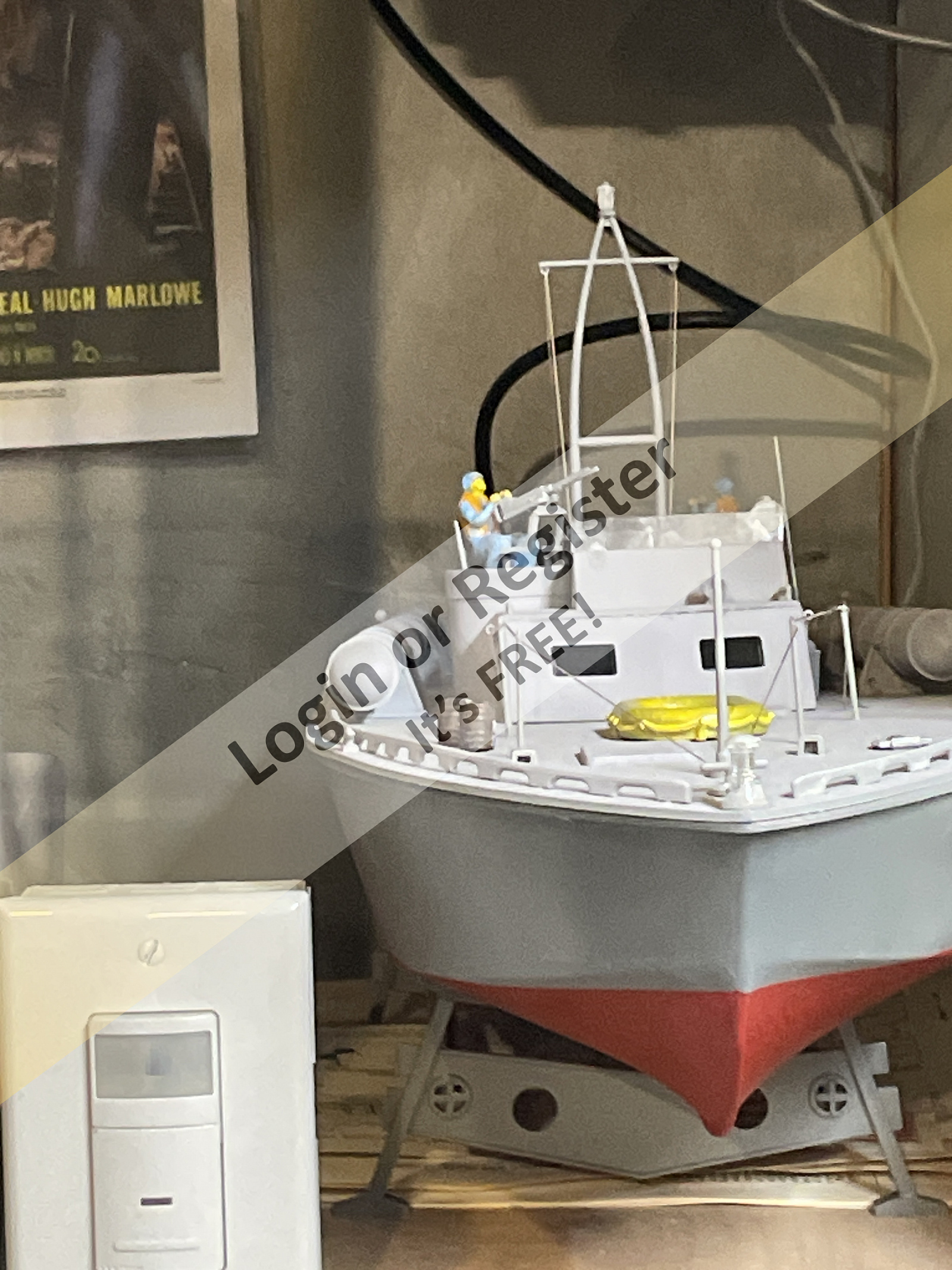

Pic of balcony in hall and the ships I mentioned.
Howard hager

Yea BaD has crappy wood n instructions. Lots of ok molded parts n vac firmed parts. When done on Dumas ship I’ll 3d the Bad parts where not ok.

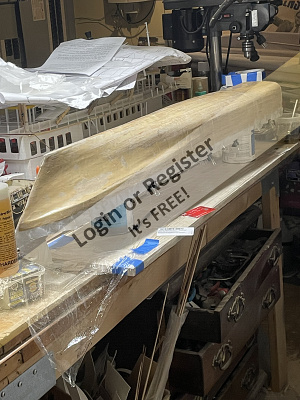

Dumas hull is final fill using DAP wood repair. It sometimes needs a swift of water to get it to flow. Used old credit cards as trowel to hit the hull bends better. Lots of sand dust. One more day of sanding then I’ll use 3 m ( learned it here) spray n place glass matting. I have large bottles of flowing type epoxy from other projects. Once done with ships weather will be warmer I can get outside more n dust off my Air Command Gyrocopter n get it ready to sell. That should be last builds for a while.

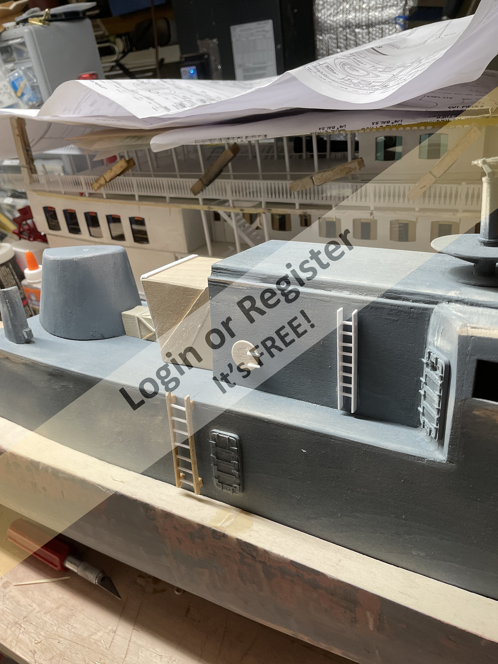

🤑I got a good price on eBay n bought the Dumas Crockett. When I di I was in middle of a build from BaD ships. What a diff the Dumas is so much better. I just fiberglassed the BaD and put it aside. The Dumas is bigger, better wood and plans. I watched several videos first. I have one more plank for hill to do. I did sand what I built so far and did fill it. List of sanding. I’ll fiberglass next week in garage m. I built the cabin, guns and one other parts while waiting. I also did several 3d parts for it. Some pics attached. A lot of sanding on all parts to do. Looking at attaching the deck befire fiberglass is applied. It is huge. I will use wood filler from DAP. Seems to work well. I used CA n freeze spray to hold planks but applied Titebond iii. It’s waterproof version. Using cay to tack the planks allowed me to mover faster. Clamps used too. I am working on the mast. I’ll use aluminum tubing so I can run wires up for lights. The big gun I’ll add a servo to move it. Having been in Navy I see a few more details I can add with 3d.
