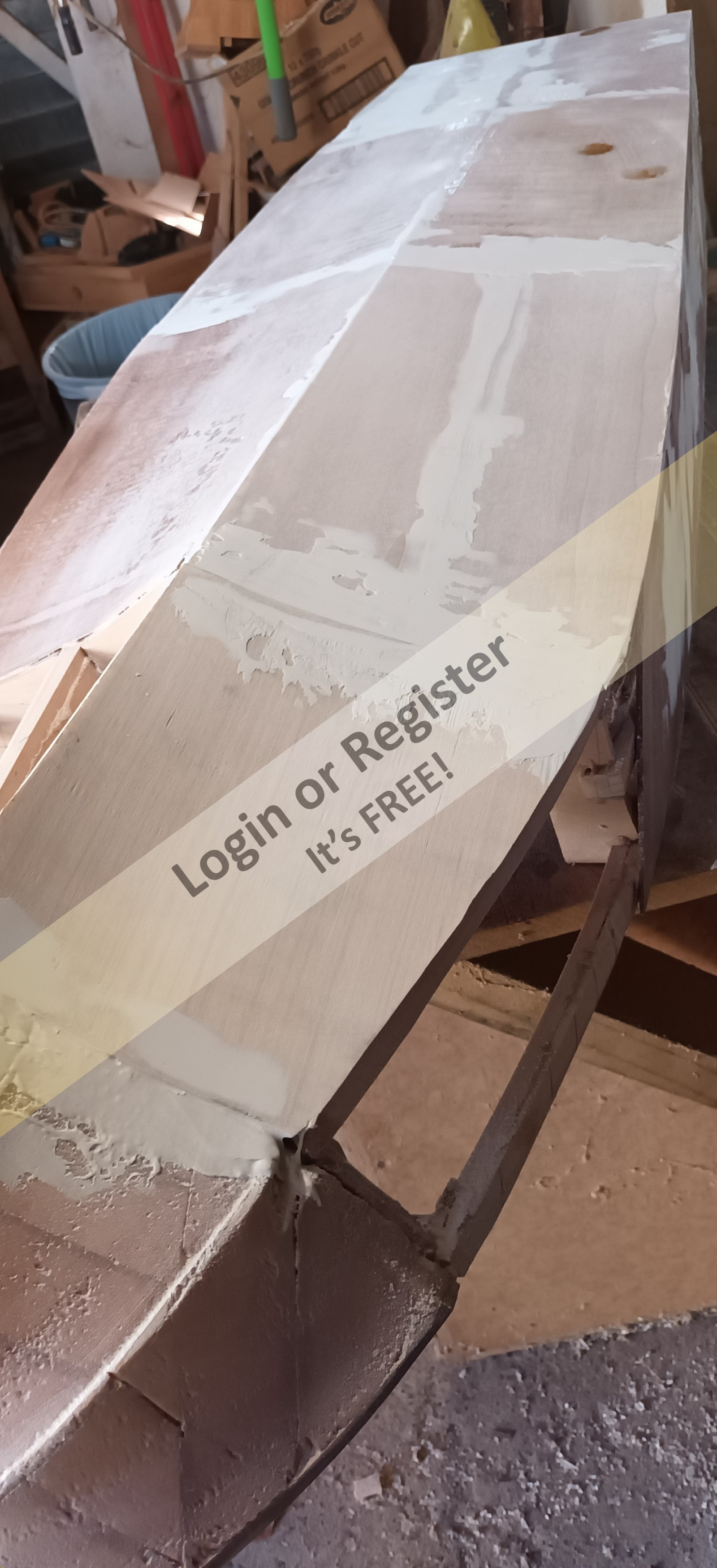

Sorry for the lack of updates, Been crook as last couple of weeks,
Well most of the bottom is sheathed with plywood now the exciting task of sanding before fiberglassing and fairing. Watch this space Lol.
