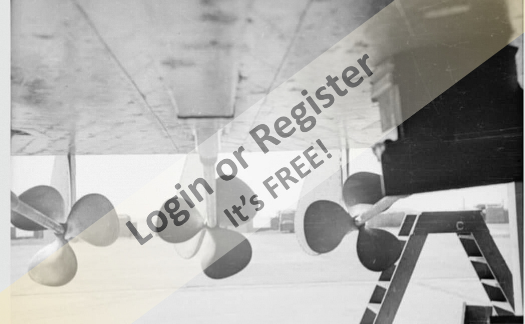

I believe this question may have been asked on Mayhem Forum and to which I posted several photographs of fast plaining vessels, to show which way the props turn. But, having said that, we will try this way .... normally you would have your 2 outboard props turning inwards; and, depending on the design of the vessel, the centre prop will either rotate port or starboard. However, on lifesized vessels, they have the ability to control the speeds of the props whilst the vessel is turning. Slow the inboard prop down and speed the outside prop up, depending on which way the vessel is turning. Normally whilst performing manouvres like this the centre prop is slowed down, so, it doesnt influence any turning. In model ways, we can assimilate this as there are mixers on the market which we incorporate with our speed controllers which allow us to do this. One of them is from ACTion which has the speed controllers and the mixer combined. This allows you to add a 3rd speed controller for your centre prop. There are obviously other mixers on the market.
As far as prop walk - it would be very negligable on our scale models unless all the props are turning in the same direction when it does have affect.

US built PT boats during WWII were built with all three propellers turning in the same direction. Right handed, or clockwise when viewed from the stern looking forward.
Contrary to some comments here, there is a "prop walking effect" when going forward. So, the original question was about a model PT boat and that is what I will try to answer here rather than something non-applicable.
There were some complaints way back when about this affect and the helmsman had to correct and compensate for it, mainly at lower speed. At higher speeds, the hull acts more like a rudder helping keep it on course. I read a lot of books and articles on PT boats.
As for a model PT boat, my 1/20 scale Elco "77" does not have much of a walk, but I must admit my center prop has a left hand pitch to it. This counteracts the two outer right had pitched props.
