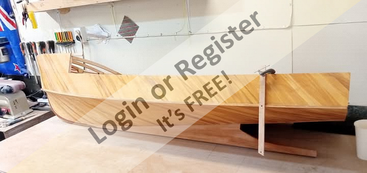

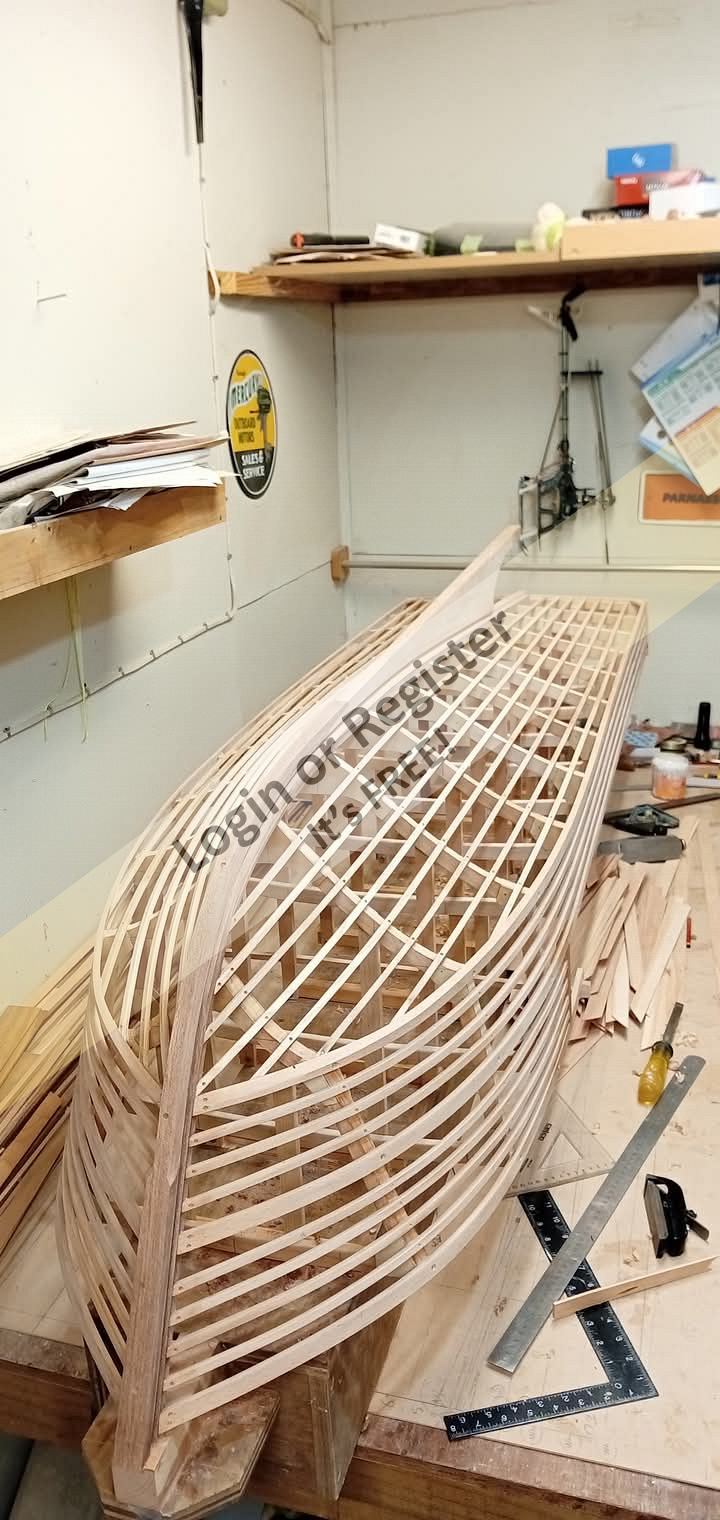

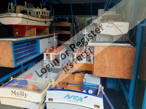

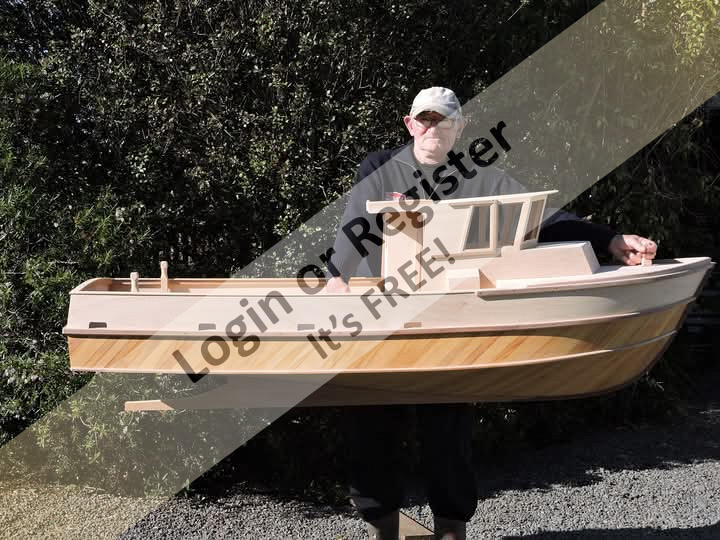

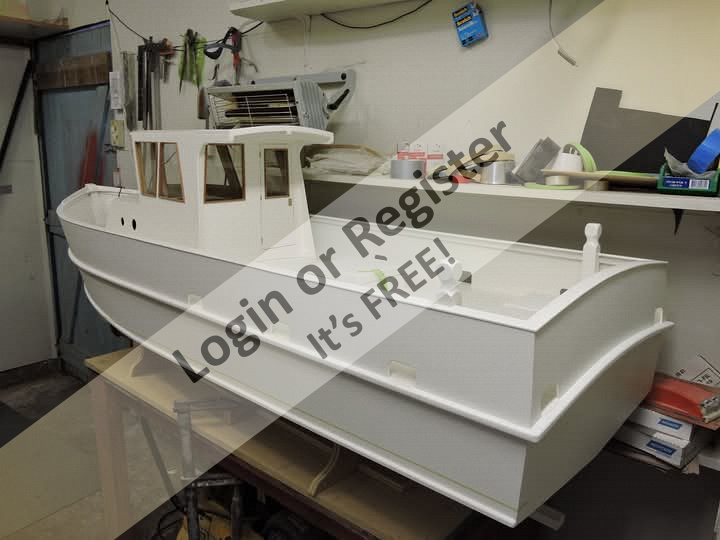

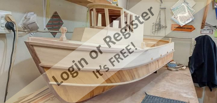

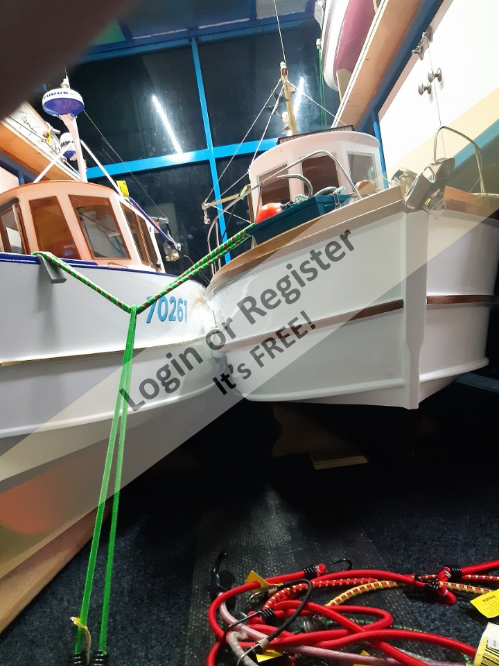

Thanks Ian 👍 ..yeah they go not too bad ,but they are big and this one is 22kgs .. bit of a handfull moving it around ..when the beam is 18 inches ..🙄.. molly is a lot better only 16inches beam

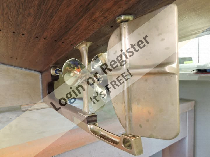

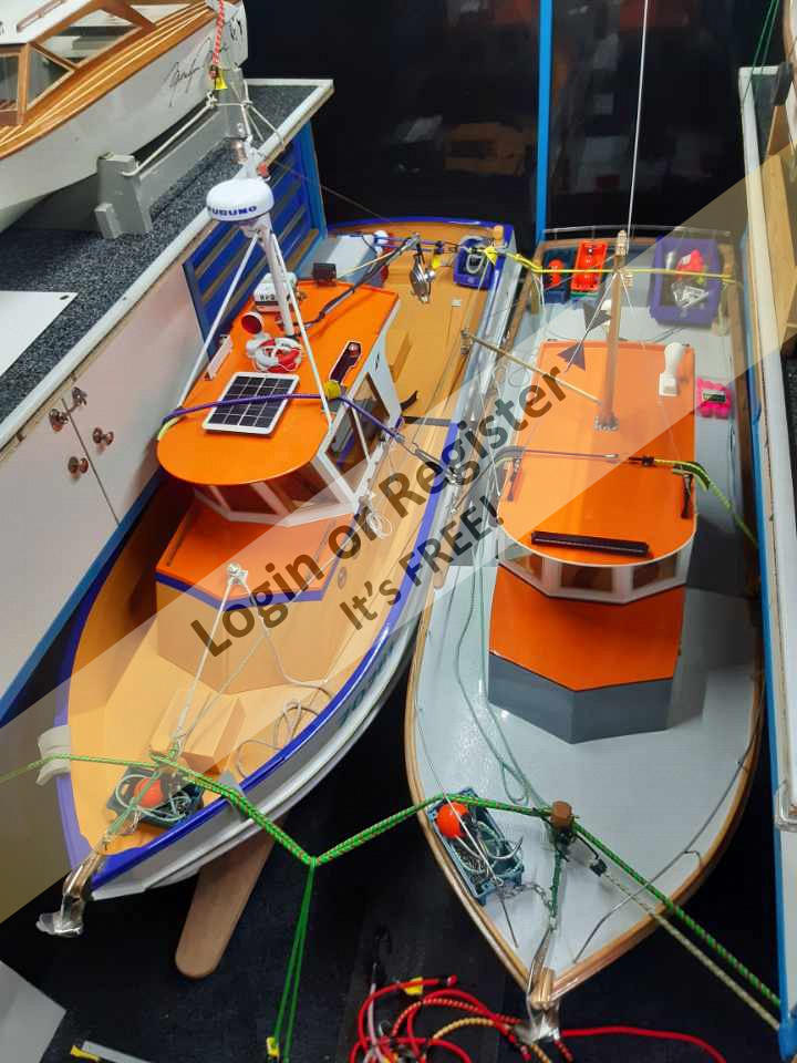

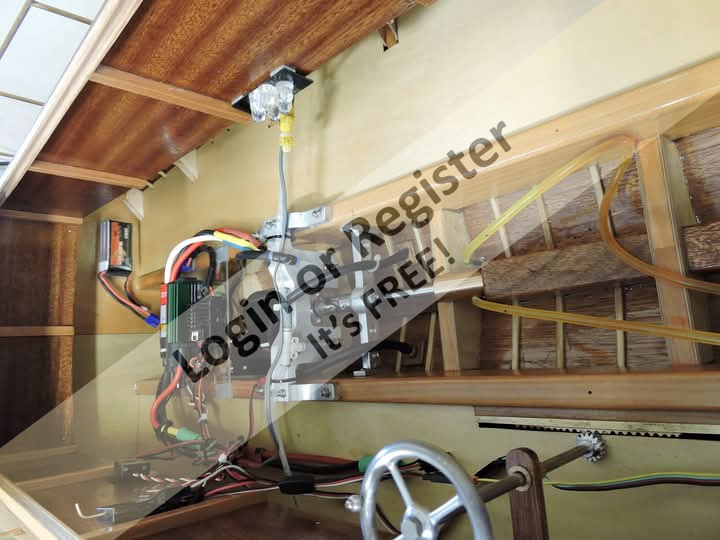

These other models are powered by 220 kv motors ,running on a 6 cell set up .180 amp controller .. running a prop shop 4inch 4 bladed prop ..thanks for asking 👍

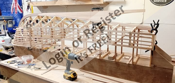

Hi Gav, you almost fall into the category of model builders, but rather a real builder with this incredible scale.
Is it the same engine and propeller as the whale chaser?
