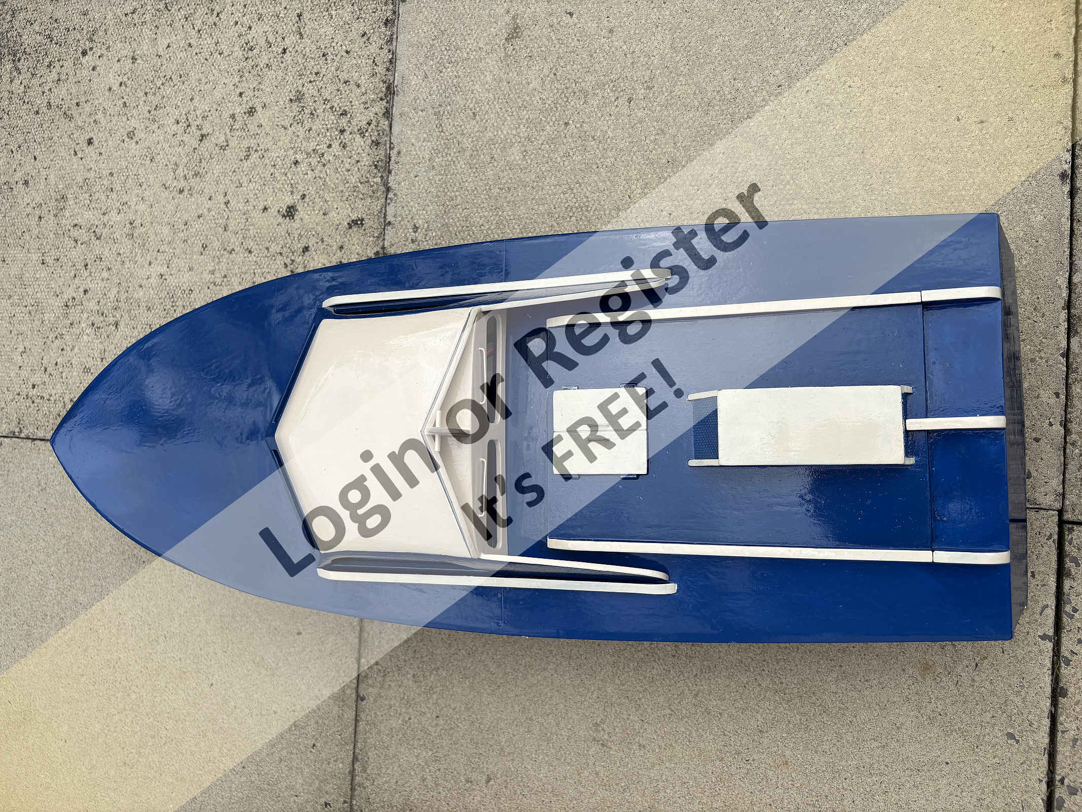

For my Kopy Kommander I used an oil based “non-drip” gloss paint for the red, white and blue colours and mixed the blue and white to make the lighter blue deck colour.
Non-drip paint is thixothermic, so when it is stirred it works like a standard oil based gloss paint and can be thinned or mixed.
……and it is oil based and has proven to be very durable on my Rapier.
I also used it on my Remora….

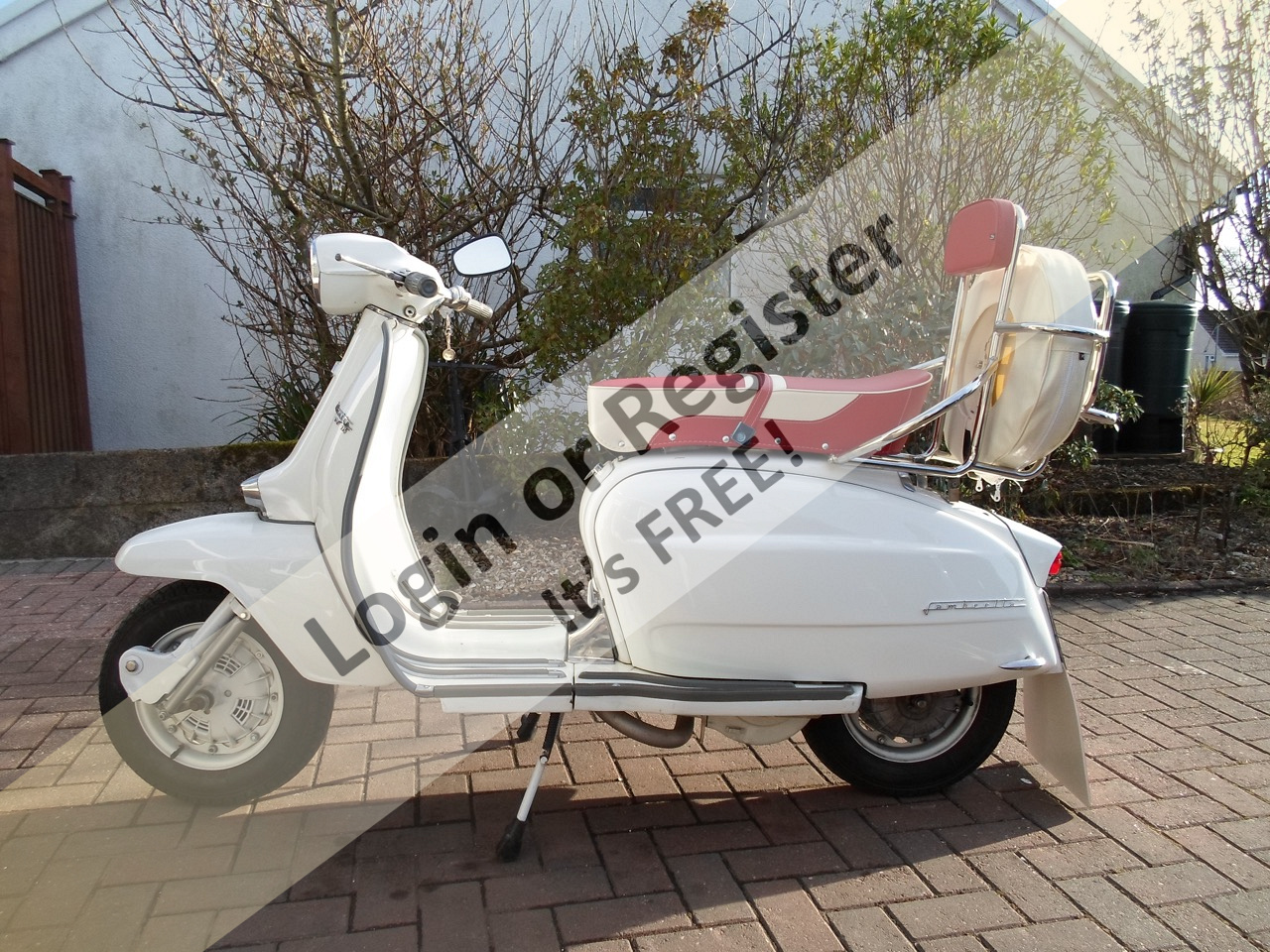

Alessandro you will be interested I hope that I still have another TV 175 that I bought a few years ago.

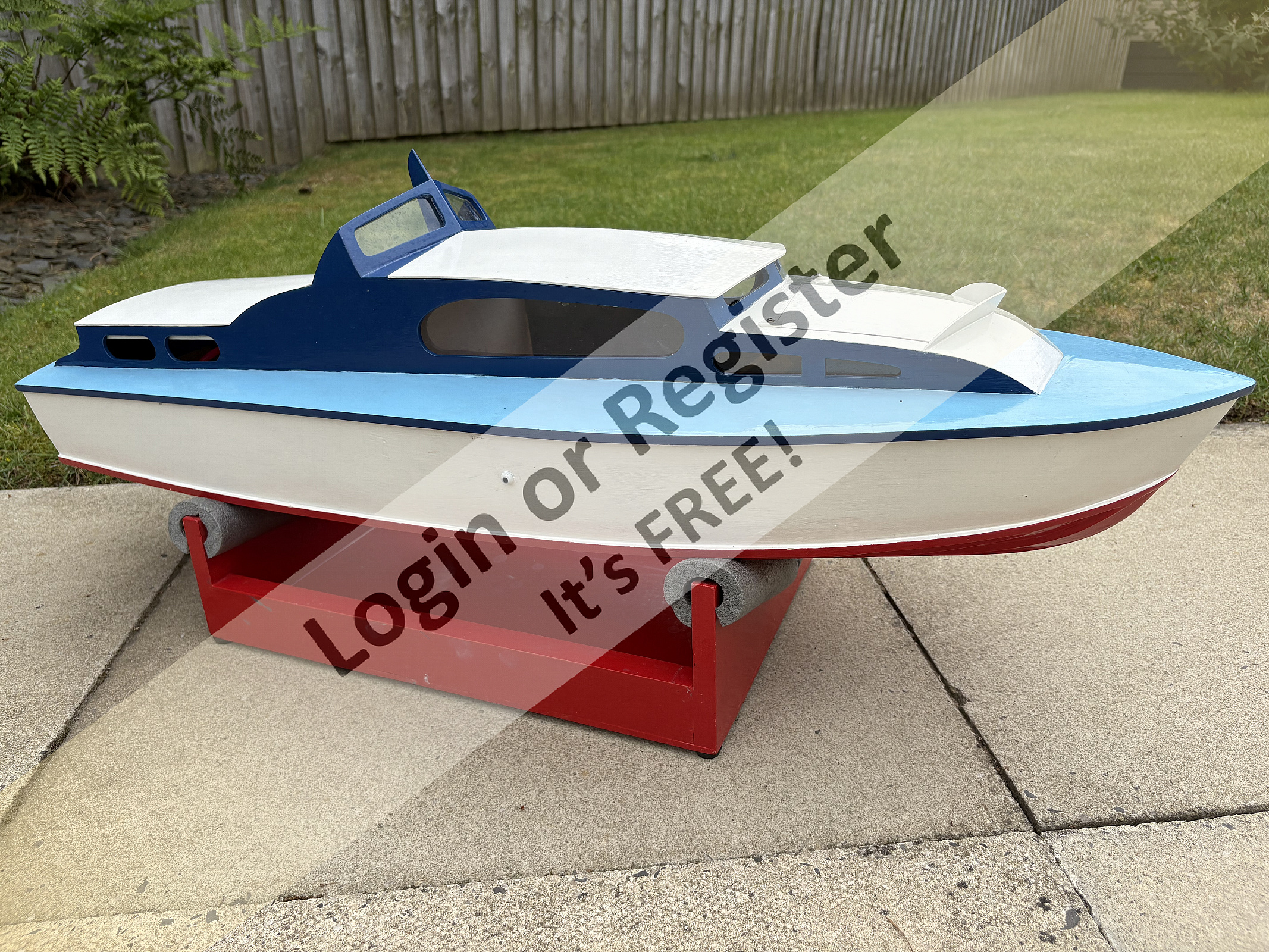

I use International with the gloss coat being an enamel. The primer/undercoat (good that it's an all in one) I use is One UP and for the top coats I use Toplac Plus. The fact that many owners of full-size Faireys use this is purely coincidental! Well, it did sway me a bit!
Another choice is Craftmaster Paints which again is an enamel.
When I first started looking at paints I was slightly concerned as neither of the above was recommended on the manufacturers' web-sites as being for below the waterline and they produce specialist paints for this purpose which are basically anti-fouling which I didn't want with my builds.
But my thoughts were as follows. Model boats aren't in the water for extended periods of time. Full-size boats, particularly the superstructure are subject to rain and standing water without problem. The Craftmaster enamels are used for steam trains and traction engines etc. and so have to resist rain and steam so a bit of lake running isn't going to bother it! Also many models have been painted with household gloss and have lasted for years without problems. These enamels are a more superior paint but the price does reflect it.
I'd be happy using either of these paints but I think Craftmaster do a wider range of colours due to their extensive use on all types of vehicles, which as well as trains and traction engines includes old cars and lorries. I might try it for a particular shade of blue I want.
As for availability, the paint can be bought online or in my case I use it as an excuse to have a drive to a chandlers and have a look at the narrowboats and other boats on the adjacent canal whilst I'm there.
