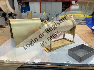

Brass should only be used if the boiler is low pressure, less than 30psi, and less than 3” in diameter. The brass will degrade over time. The best material for small boilers is copper a with silver soldered joints. Larger boilers that are structural, as in traction engines are normally steel.

Hi Algon,
As far as I am aware the major reason Brass is not used for boiler and boiler fitting construction when it is in direct contact with steam is due to the Zink leaching out into the steam which eventually leads to the Brass "crumbling". A sacrificial anode of Zink will get around this problem.

Hard to say what the reason was for his material choice. Maybe just the materials he had available to him at work.
I believe from the quality of the D10 he built along with the boiler that he was a good machinist. But maybe just not a "model engineer".
Need help identifying
I wonder if the guy that put this together was short sighted, hence the size of the pressure gauge. I agree that copper is the norm when it comes to boiler building, but on the other hand Saito have been using brass for every thing boilers, spirit burners and engines since the 1950s.
When you say "ALL brass", that would include the pressure vessel. For several reasons, thermal conductivity among them, copper is the proper boiler material. No knowledgable model engineer that I know of would construct a brass boiler. That was as true in the late 40's/early 50's, when you believe what you have was constructed, as it is today.

Well the boiler has cleaned up well. Still rounding up fittings to perform a hydro static pressure.

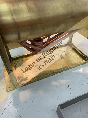

Yes, ALL brass. I think it was home built by the previous owner who was a machinist by trade. Design similar in some ways to a Stuart 501 but also with some differences.
I will post more as I get it cleaned up and pressure tested

Is the pressure vessel also brass?
Yes the safety valve looks to be Stuart but I have never seen a Stuart boiler like this. I have a couple of 501's and the 5 tubes on this one look very much like the 501. BUT this boiler is ALL brass no copper. Looks to have a couple of stay rods with nuts on either end that tie the end caps to the boiler body. Never seen one like that.

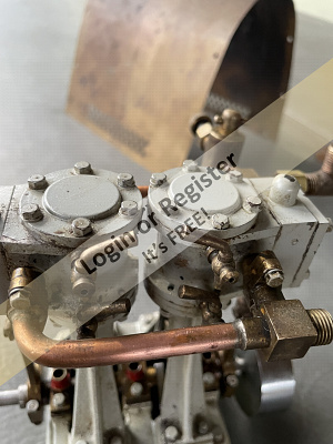

The boiler could be an early stuart judging by the safety valve...

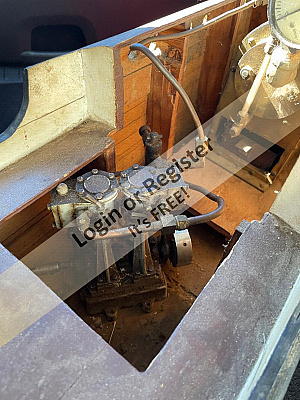

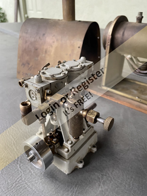

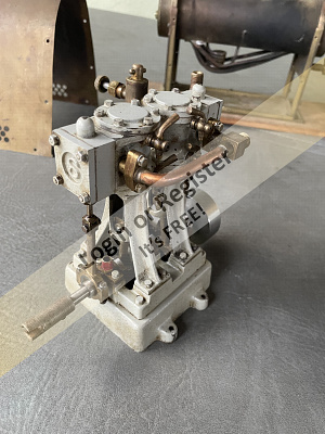

The engine is a Stuart Double 10. The boiler looks a bit dodgy, have it hydraulics tested and checked over before steaming. Brong it to working pressure in increments, ie take up to 10 psi, cool, take to 20 psi and so on until you reach working pressure. Look for numbers stamped into the boiler, usually around the burner tube, there numbers will be needed for a test certificate. The hull looks free lance...

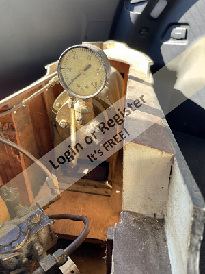

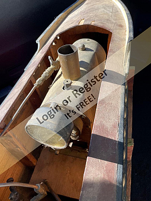

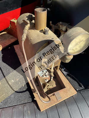

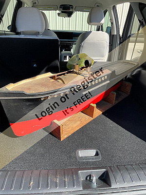

Hello all I am looking for some help possibly identifying this steamship - or steam boat. I was told it was built in the late forties - early fifties. I am not sure if a kit or more likely from plans. I believe it may have had a structure above the deck?
Engine is of course a Stuart D10. Any ideas on the boiler? It is all brass not copper. Has 5 tubes below the tank like a Stuart 501 as well as circular tube coil at the far end. Has a steel tray for fuel. Possibly a cotton bat soaked in alcohol?
