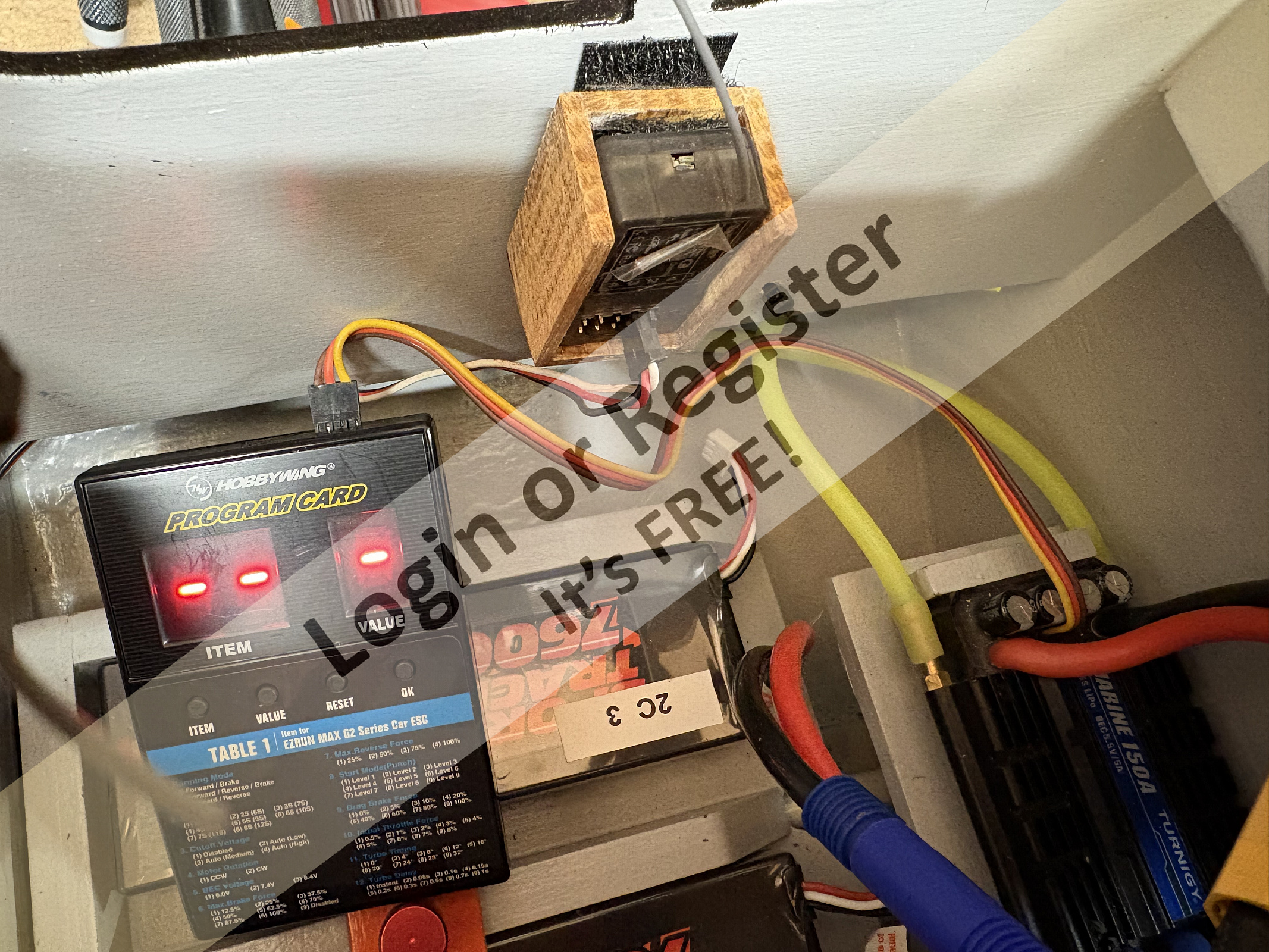

This gave me the idea of trying a mechanical connection to access a digital sequence - strange logic - but nothing else has worked...................
When these marine ESC are first fitted they are "programmed" to work with the radio when they are first connected together by using various positions of the throttle.
My ESC has been "paired" to the same radio since my Rapier 1 was first restored during the Covid lock-down.
I experimented by moving the throttle stick to the full forward position and holding it there as the ESC was connected to the LiPo , and then moving it between full throttle and neutral until the motor gave a strange tone (instead of the usual continuous beep-beep).
This is a similar sound that can sometimes be generated when an ESC enters the programming stage when the continuous beeping stops.
By experimenting with this idea I found a position that has given me a forward/reverse operation!
Getting out of this sequence and retaining the new reversing function did not work at first, but eventually I was able to get out without losing this new function.
I have returned to Rapier 1 a few times and powered it up and it has retained the reverse function!
I will not be able to get to drive this boat for another fortnight or so, but I am keeping my fingers crossed and hope that this new found function will remain as a permanent (and very welcome) addition without having to change what has been an excellent ESC.

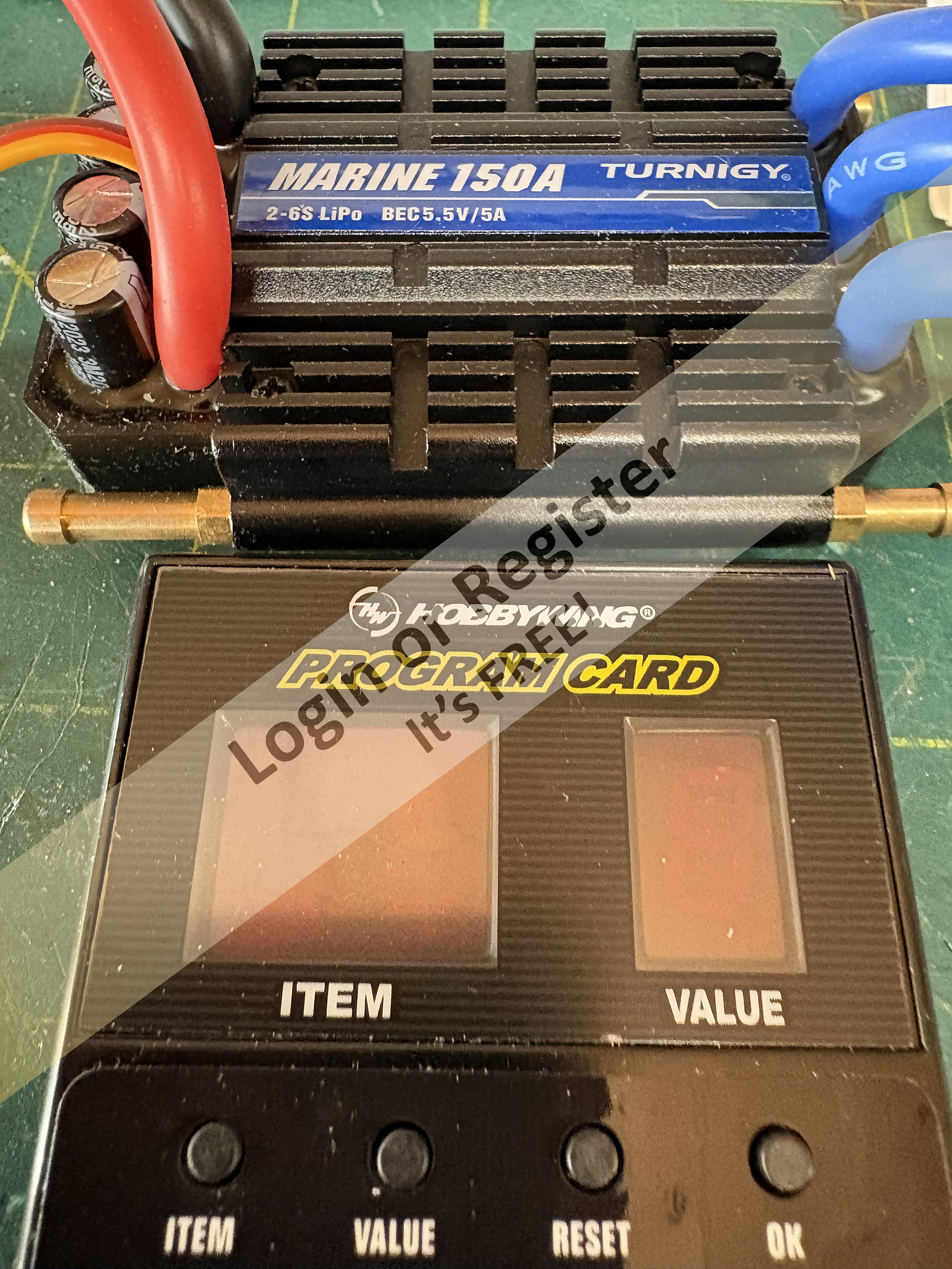

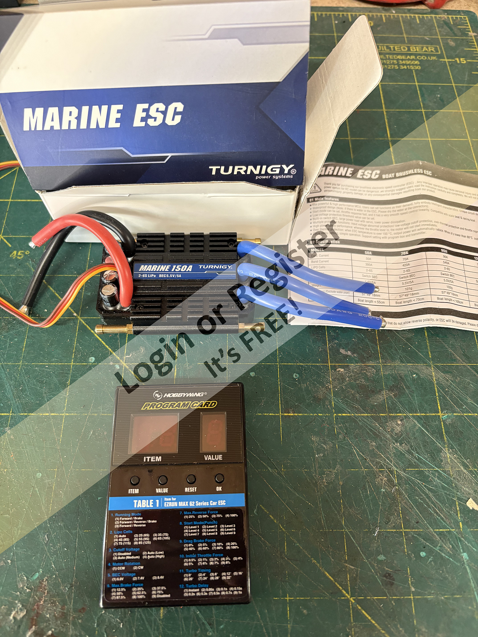

Turnigy 150amp Marine Speed Controller.
This ESC is basically a 150amp Sea King with a Turnigy sticker on it when it is sold by HobbyKing.
Today I made some time to try to programme this ESC again to see if I could persuade it to run forwards and reverse, rather than forwards only (its delivery setting).
I am aware that many of the programming cards that I have acquired over the years (mainly for model car racing) need to be updated to work with different ESC's as new versions are released - so I bought yet another new Hobbywing programming card to see if I could get it to talk with my SeaKing Marine ESC as all my others have failed to connect with it.
The new Hobbywing programe card arrived this afternoon so I checked the instructions to see if anything had changed in its operating method (none) and connected it to this ESC that has been running (forwards only) ever since the boat (Rapier 1) was restored during the Covid lock-down.
This program card can be used with a Hobbywing ESC that has a common lead for the receiver and the program card (like the SeaKing/Turnigy 150amp type I have). It does not have to be used with those ESC types that have a separate programming lead - it can work with both types.
One of the small sequence charts that come's glued onto the back of the ESC case are for use with Marine ESC and show the options that can be adjusted. (including forward only or forwards /reverse).
With the program card connected in the correct sequence it failed to register with this ESC.
The advice to reconnect after a few seconds break was tried several times, but the program card would not connect to the ESC and the motor just continue to "beep" at regular intervals waiting to respond to any programming signal........but there was none.
This is the same result that I have experienced many times since I first fitted this ESC to my Rapier, and just like the previous times, I then connected the same program card to various other ESC where it worked normally without any problem.
With this check repeated, I am certain that all of the program cards that I have connected to this marine ESC are working correctly, but none of them will connect to the Sea King Marine spec controllers that I use.

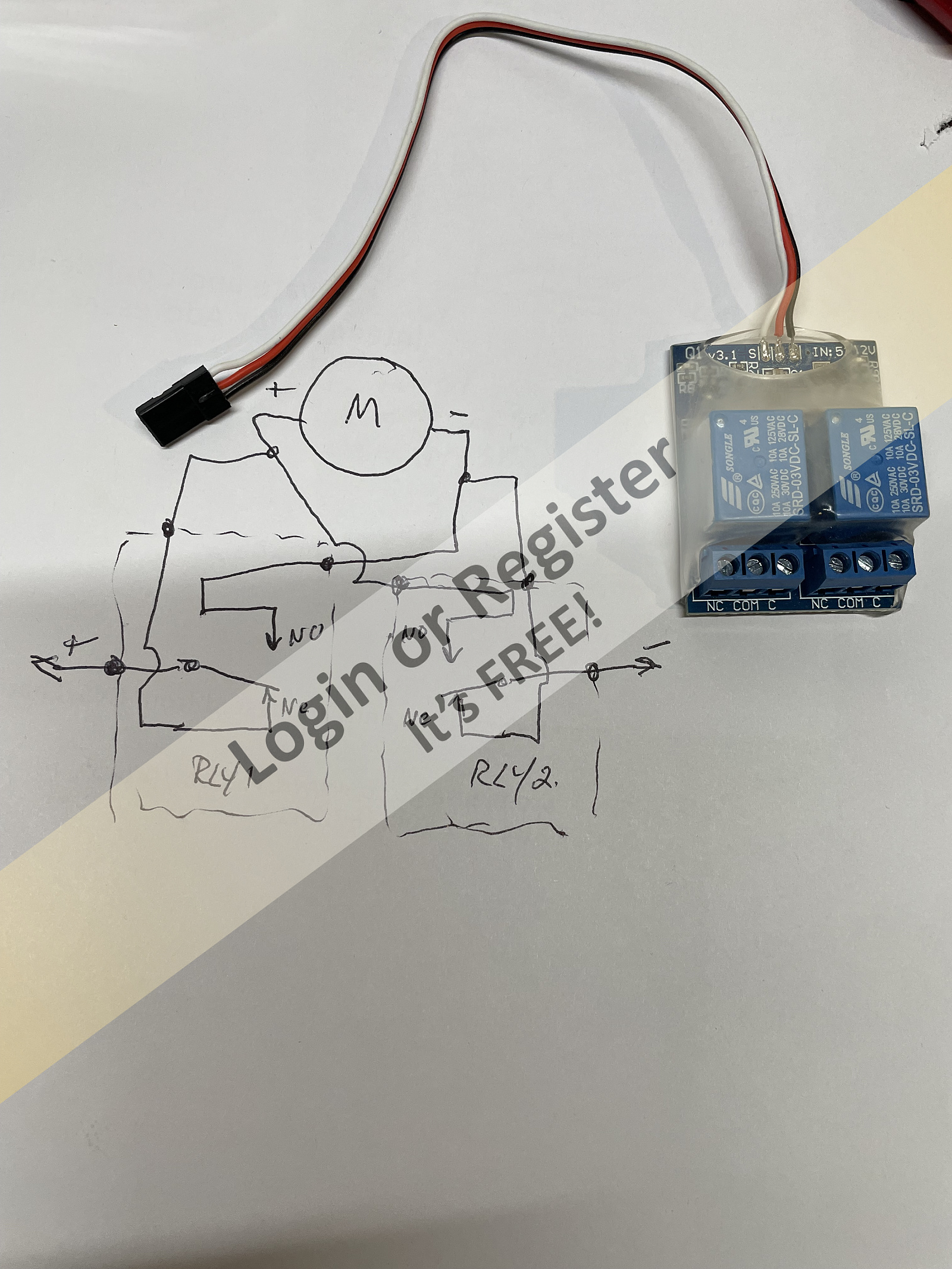

If you want to keep the (aircraft) Esc set up a reverse switch relay dpdt and switch on transmitter. It’s a channel control mechanical relay but make sure it can handle current. Other way is a servo to throw a mechanical slide switch. Used in old days to turn electric glider motor on/ off . On other thing I found is the motor control on two stick RC transmitters is they aren’t centered. I used aileron stick for motor n rudder fir rudder on my DX6 when using as ship control. If you use relay then normal motor stick is fine as low is low then flip switch n its low reverse.
I guess I’m still old school at 83. Working on multiple ships and my uncles ships to sell. See pics n on eBay. Good winter projects.
Simple schematic for engine reverse n pic of module with relays (10a 30v) takes one channel forward or reverse then motor stick used to move from stop to full in direction.
Howard hager

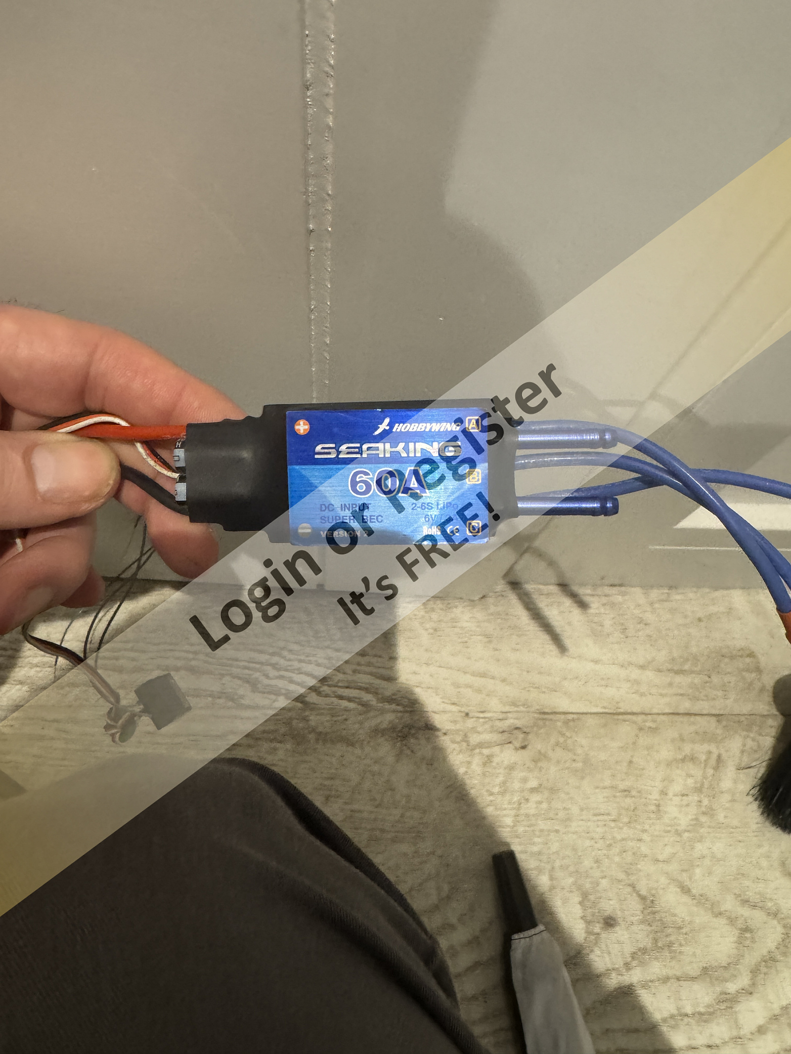

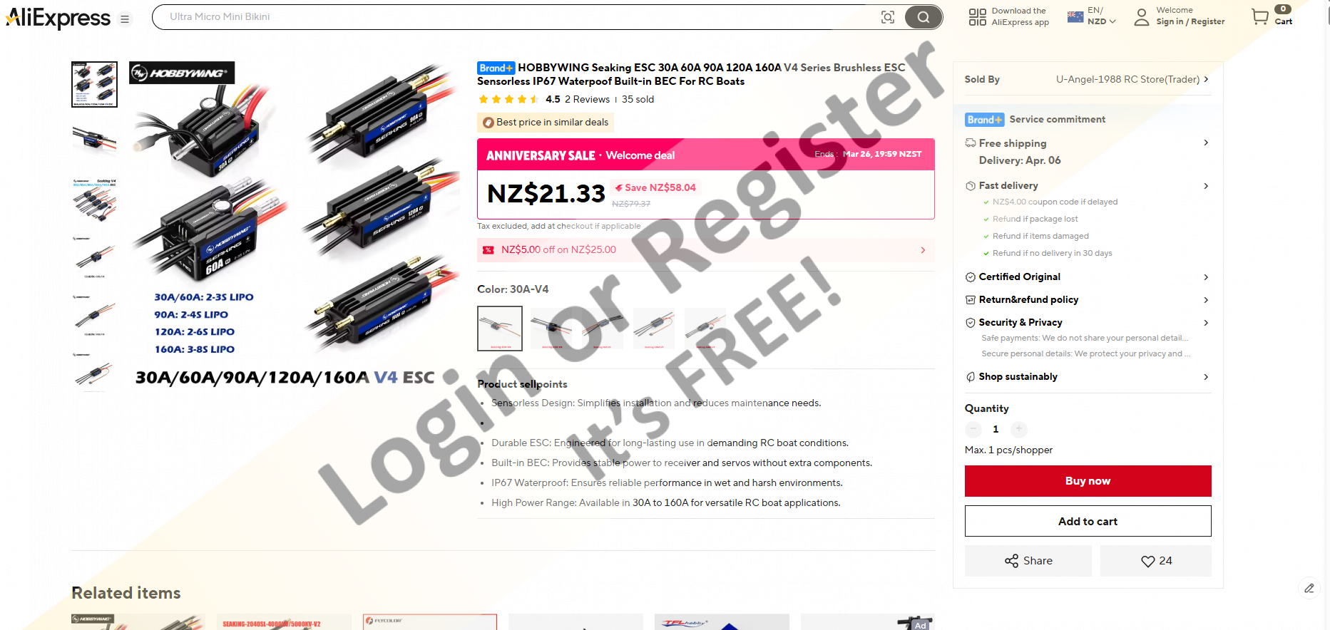

This is the picture that Eric shared with us of his ESC.
I have shown it here alongside the advert you pictured of a different type of 60amp ESC - both branded HobbyWing and both 60 amp.
They are not the same ESC, but maybe the model that Eric has can be programmed to use a reverse function if he can find the correct program card to pair with it?
Liked by EricMB and hermank

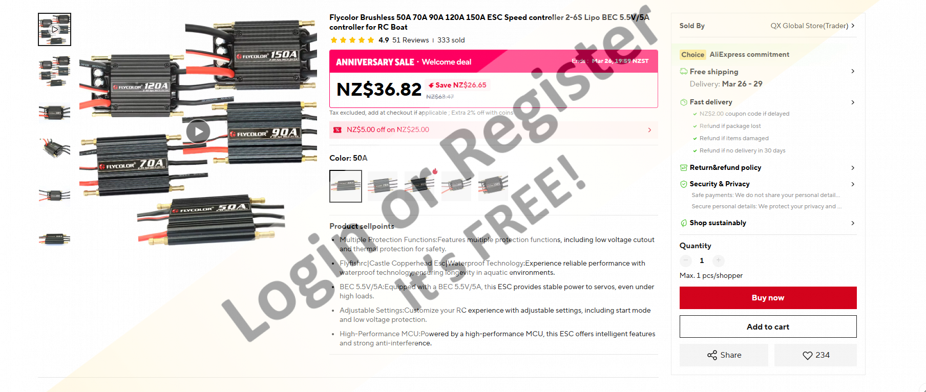

Programming a seaking brushless ESC challenges..
I have never seen that model of the Sea King before Chris - it has a reverse function! It is also shrink-wrapped, and that is different to every other Sea King ESC that I have.
None of my Sea King ESC have this reverse facility - so I am guessing it is a new model type?
I have been racing electric cars for so many years, and during that time I have acquired a large amount of programming cards to be able to adjust all of the different types of ESC that I have used (or set-up for others), and it is a very simple intuitive process.
Most of these different cards (not all) are for Hobbywing ESC.
It is surprising how many slightly different variants of these cards exist and how many of them can be updated online to accommodate small software changes that exist between seemingly similar or same looking ESC.
A specific program card for the model of ESC that Eric has will save him having to buy a Shark ESC (and matching program card).
It will be important to order the exact type of programming card that is specific to his particular ESC due to the huge variation of types made by HobbyWing.
Hi all,
Thanks for the help with my Spektrum DX6i, now having trouble programming the Seaking hobbywing 60A brushless ESC that came with the boat, it’s running in forward only mode and I can’t change it. Followed the instructions I found online but it won’t stay in forward/reverse mode.. any suggestions? Video shows the procedure I’m following.
