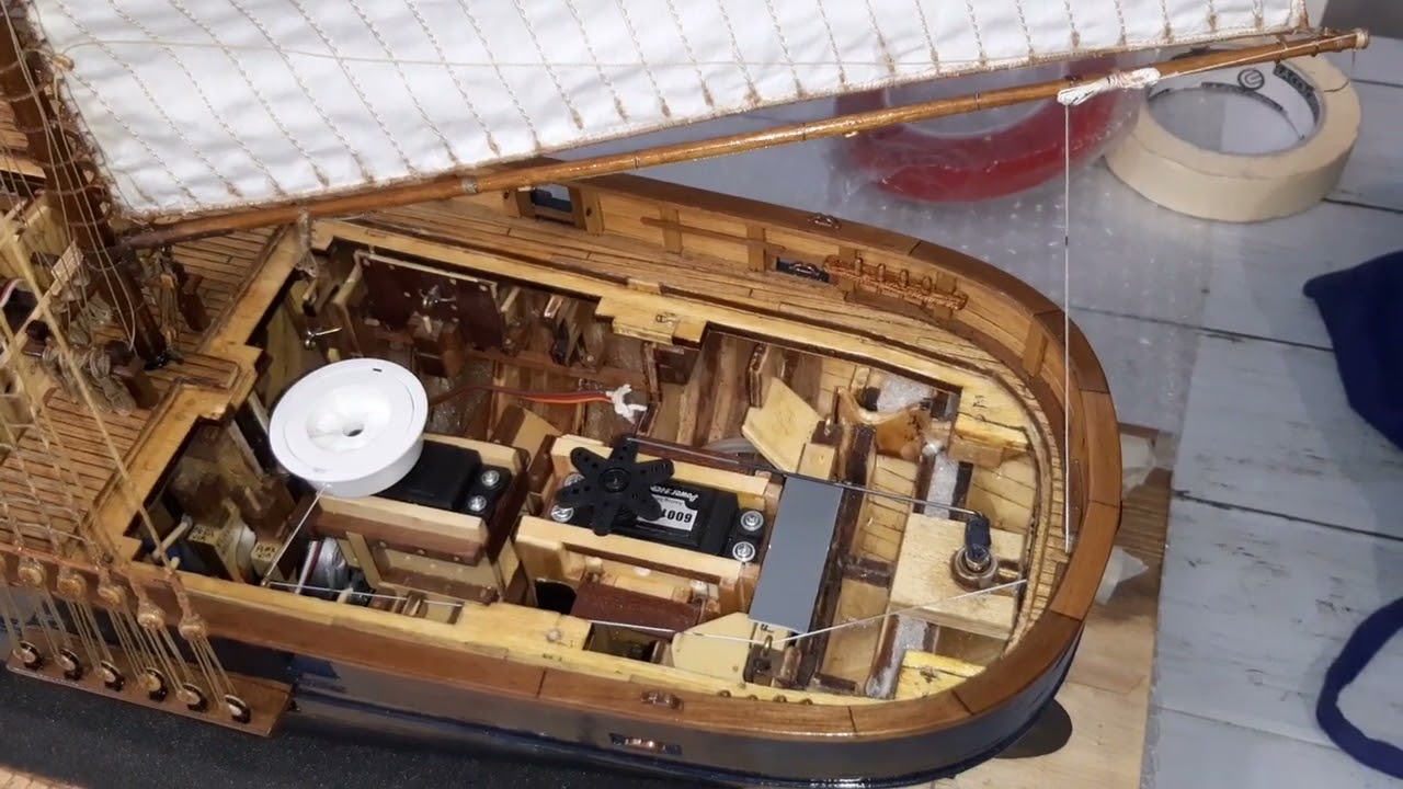

#4 42
Hi Mike, I chose a very simple system, but I don't think it's the best.
When I imagined it, I had no other examples to follow.
I furl the sheet using a winch (in my case, I used two winches to trim six sails).
The sheet is attached to the boom or to a fixed point on the deck.
When taking in the sheet (and therefore for close points, such as sailing close to the wind), I furl it.
When sailing downwind, I unfurl the sheet by letting the wind pull (and therefore unfurl).
I made the mistake of buying a winch with six turns of furling. I had to reduce the furling travel with the radio control settings.
In hindsight, I should have bought a winch with two turns.
You don't need much rope travel.
This system applies to gaff sails, not square sails.
With square sails, it's simpler: with the same winch, one reel reels in and one reel unwinds the two lines (tack and sheet) simultaneously.
To keep the boom low when sailing downwind, I installed a downhaul.
I don't know if I explained myself or if I was helpful, but for details, you can see the description, photos, and video in this thread.
I don't know if I'll adopt the same system in the future; I'm evaluating others.
If you have any other questions, please ask.
