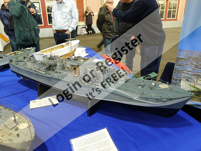

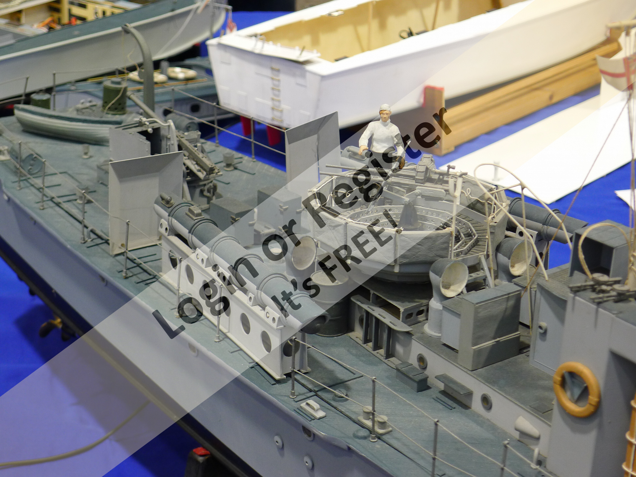

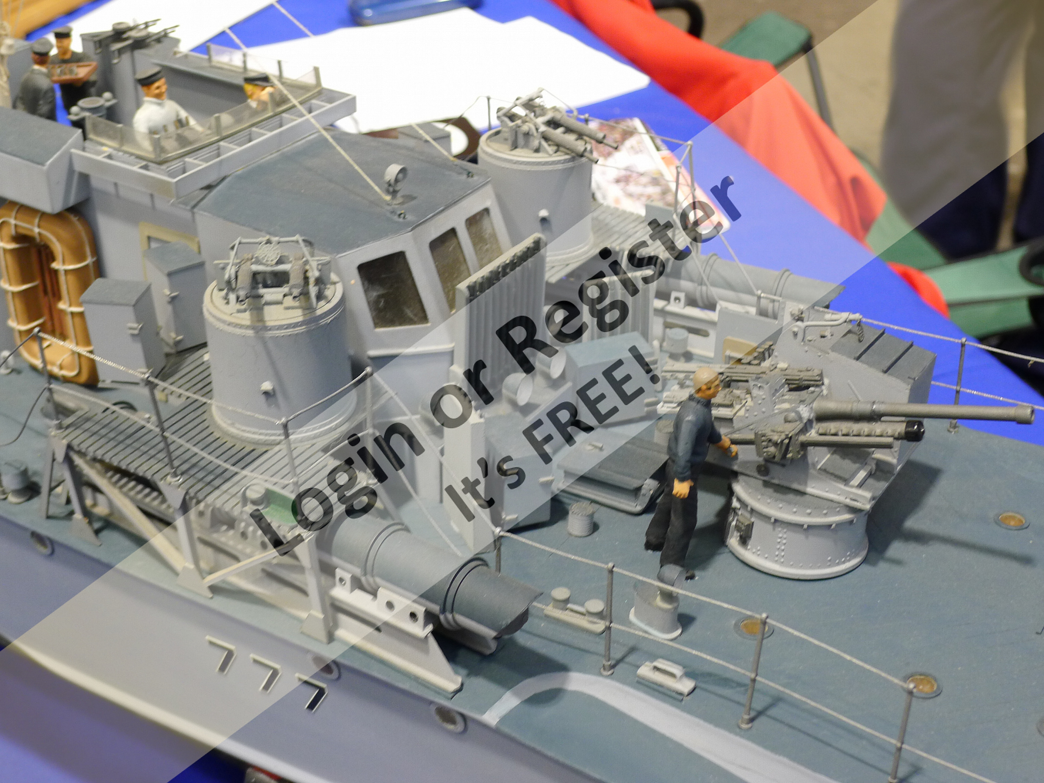

The E-boat was built and belongs to a friend of mine - Graham Smithwick. it is a fibreglass hull and he has had it for a long time. There are plenty of resources on E-boats. This is a very good one.
http://www.pt-boat.com/
I have also included some photos of his E-boat before the newer camouflage.
