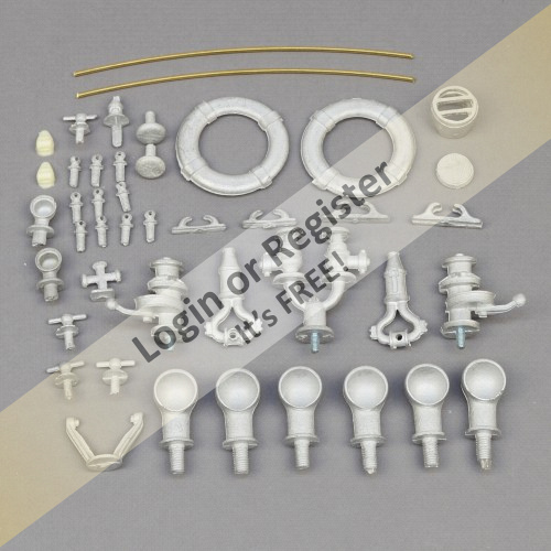

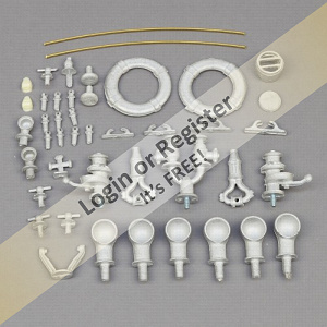

Trying to move my 36" RAF Crash Tender restoration forward- I purchased set of deck fittings etc including fire monitors. However I am struggling to find a way to attach the brass "handle" to the monitor body ( lead ?) dyecast...... I have tried araldite etc but the contact area is just too small - cross section of 1.5 mm bar onto a semi- round monitor body part.
Has anyone had a successful method to join these two parts ?
