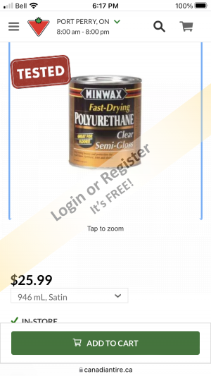

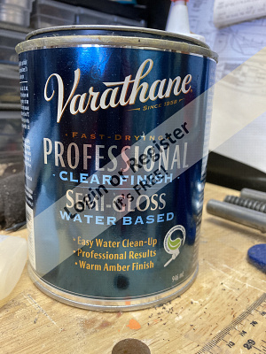

Have any of you tried Varathane, fast drying Professional clear finish? Or Minwax oil-modified Polyurethane? Both are fast drying and water clean up, low odour, super durability and even great on floors.
Agree with Roger G in sealing his boats. Along with finishing epoxy I also us EZ KOTE finishing product. The thing I like it dries in a short time and is water clean up when done but gives a solid finish. Rick
