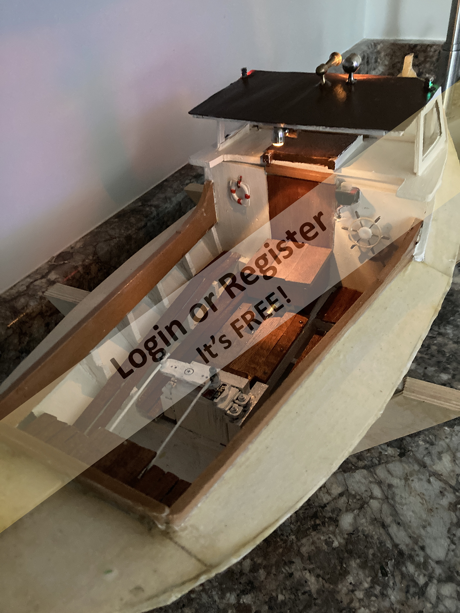

Ready to launch later this Spring. I found Happy Family figures on Facebook marketplace for $6 per figure buying 7 of them.
Gave her the name, Mrs.B, in respect of the three ladies in our family.

Tank testing showed a small leak but after applying 5min epoxy mixture along any suspicious seams, no more leaks 😁
I went back and checked the drawings from John Gardner’s book. It shows the height from cockpit floor to roof over wheelhouse is 5’-7”
My figure here is 6” which is 1”=1’ six foot person. I figure since everyone has the same toros length on average, if I shorten the legs the figure could be brought down to about 5’ 8” or 5’6” without an issue.
These are Fisher Price Happy Family doll house figures which can be found on used stuff websites such as Facebook marketplace. Average price in Canada is $8-$10 per figure.

Hull is sheeted and fibreglass cloth applied. Working on servo placement and rudder control arms. I prefer dual push rods.
Turned the mast on the lathe. Bowsprit is coming along too.

I have ordered 1/16” x 4” x 30” Basswood sheets from Great Hobbies nearest store to me. While I am waiting for it to arrive the entire model has been brushed with Varathane. Fibreglass has been applied to the fin box inside and out, along with key locations to add strength.
Unfortunately some of the birch ply had strips which tore-away after cutting but after sealing and fibreglass these areas will be just fine.

One side is sheeted, today I will begin the other side.
On another note, I have found that the Dory design is very similar from one to the next. Some where short 12 footer and others like this St.Pierre up to 28 ft. The one I have drawn up is from The Dory Book by John Gardner.

Roughly 26" LOA plus a Bowsprit this is a scratch building project of which there have been a few hic-ups along the way. I spent time this morning reworking the CAD drawings and making new pdf's. Because this will be a model that can be either sailed or powered it requires special consideration for placing the small NiHm 1200 battery pack. I do not use brushless motors or Lipo batteries.
I will remove the added cabin and roof extension.
