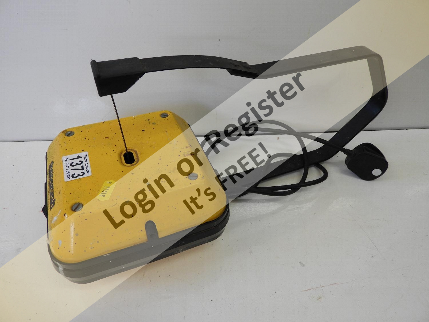

    Thanks for your thoughts Dave, but I've taken it fully apart and cleaned it up. Removing the top plate above the the electromagnetic coil is a no no! That is attached with 6 bolts with rubber shock absorbing rings.

    Looked on Google and there are several posts with similar problems from 2008. Would appear the problem lies in the electromagnet mechanism but without a detailed pic it is difficult to comment further. One post says they removed the top plate? and it worked ok. I think you need to disassemble further to find the problem- my guess would be dust or debris in the moving mechanism.

    Sometime ago I acquired a shapecraft fret saw model 1000. The blade vibrates but doesn't move up and down. I took the saw apart, cleaned it up including the contacts and still the blade doesn't move up and down. The blade is 133mm and I can't see online any longer blades -I'm assuming that's the problem as unconnected to the arm there is some movement between the plate and the electromagnetic coil. Does anyone have an answer to this problem? It goes against the grain to dump it!
