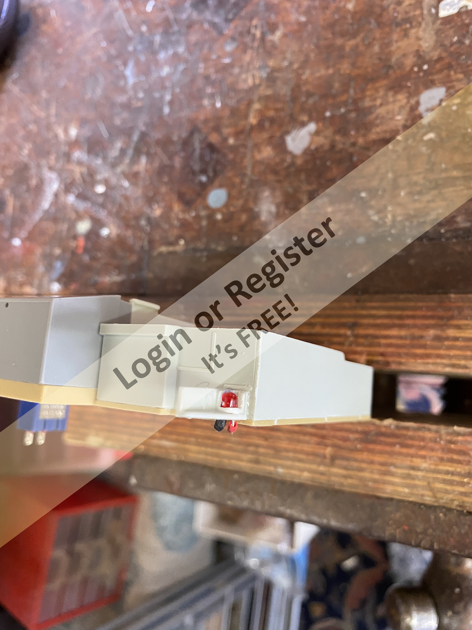

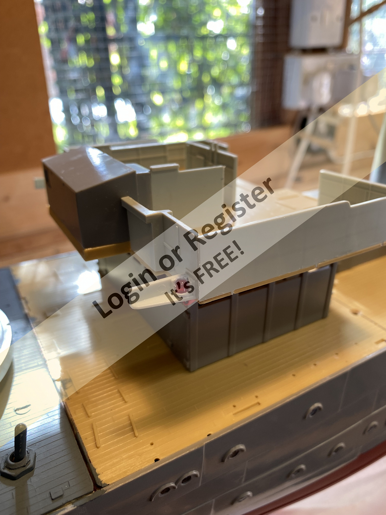

I am currently make a boat at 1:12 scale and have made my navigation lights (see photos). The red LED requires less voltage than the green, and a resistor is required to reduce the voltage so they can both operate safely on 3v. The port light has the resistor mounted in a small box immediately behind the LED.
Hope this helps 😉
