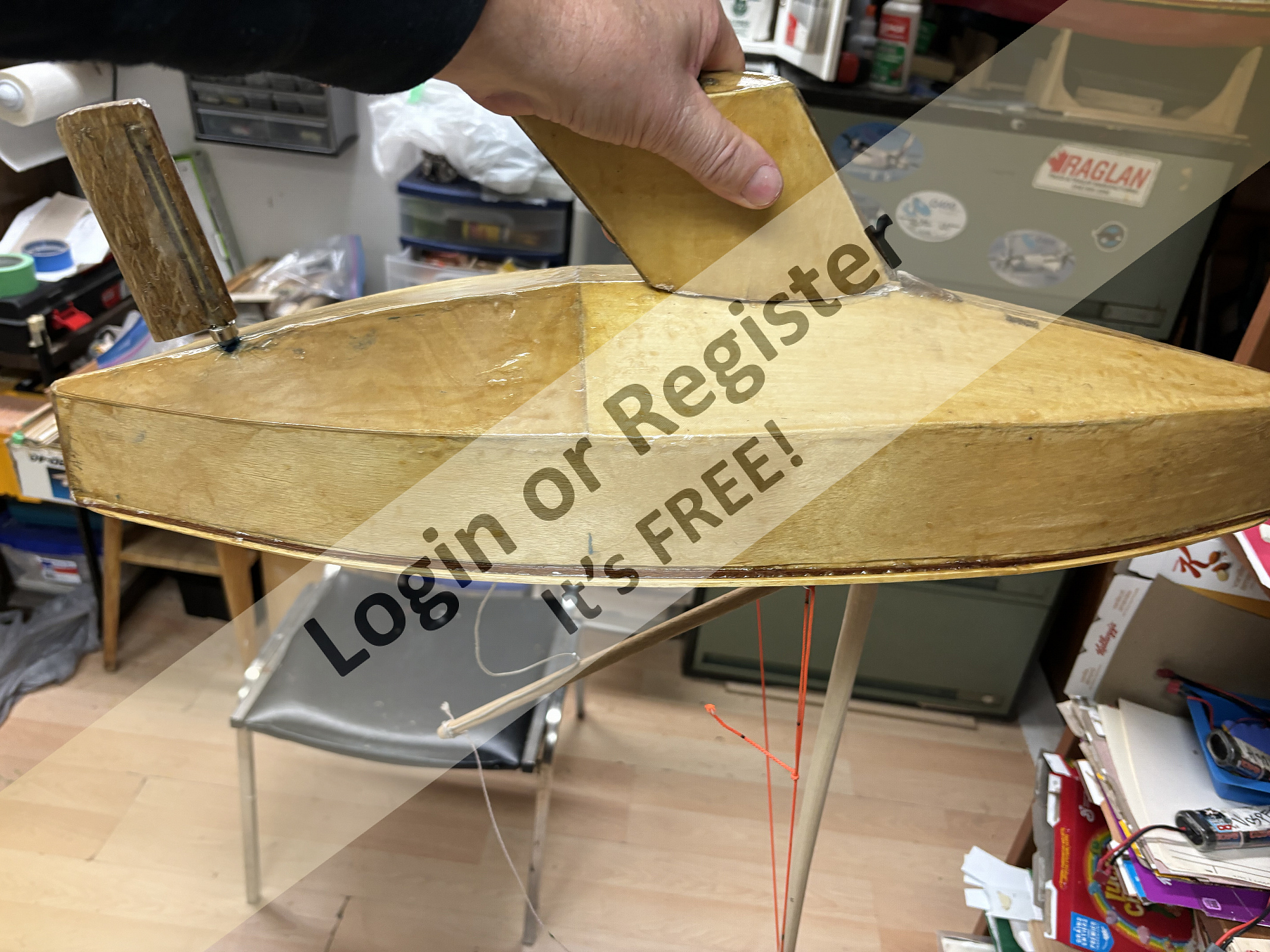

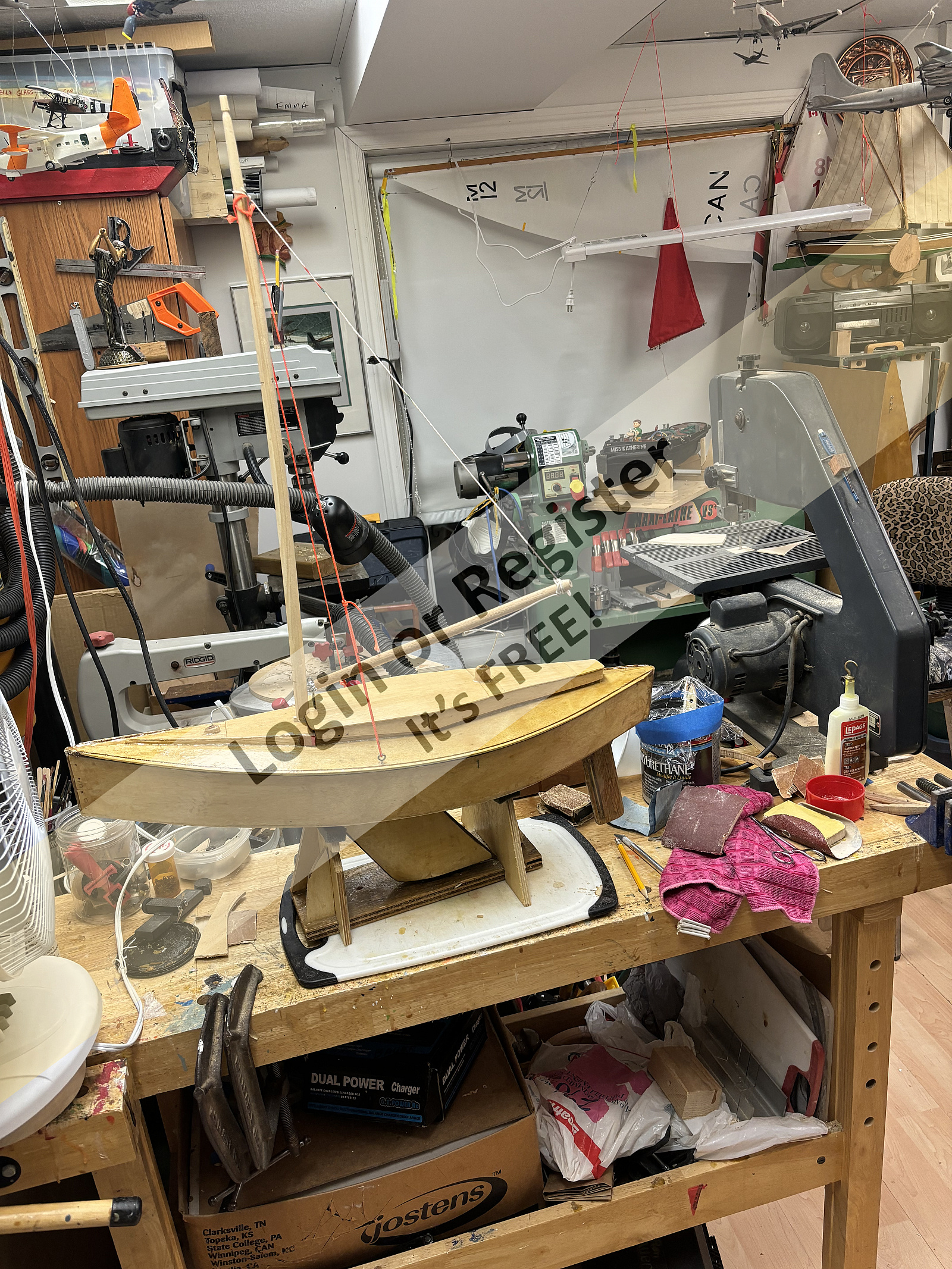

Transverse stability of ships (difference between shape stability and weight stability)

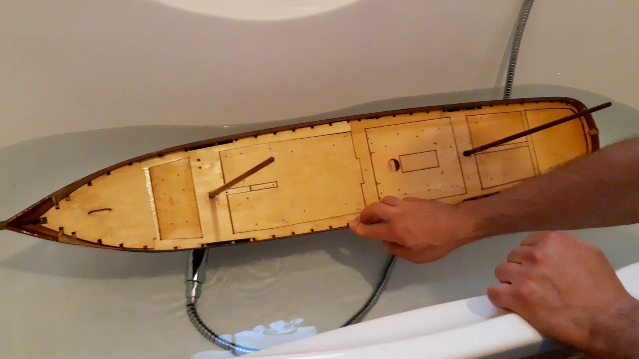

This is just for model yachts! Before I take out a newly completed model I do the upside down test.
This has the battery and all insides ready to be switched on. Turn the yacht upside down and see what happens. If all secure, including hatches as mine always lock down, then down to the water.
When I did a dinghy sailing course in a Wayfarer, we had to do capsize drill, and it was April and not very warm in the Solent!
Boat was capsized we were in the water with life jackets and then someone would stand on the exposed keel and grab the shrouds, usually me, and lean back until the boat was upright. Haul the the others on board and then we had a bailer to evacuate the water from the boat and sail back to base.
This was the last test for the basic RYA exam. I did do the advance one and also competent crew in a 36 foot yacht.
Lesson was to have everything secure so nothing floated off!
Liked by RPLedm and Peejay and

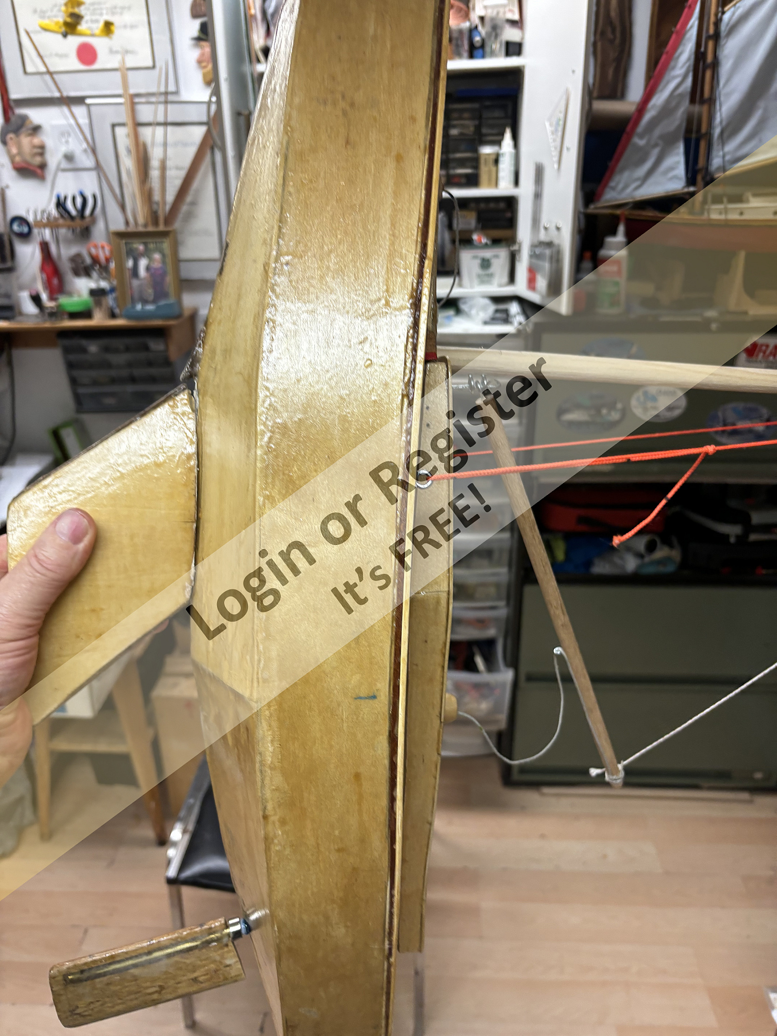

I am not sure what my angle was in this test? I am going to try and find out. I don’t like sailing my sailboats where the rail is submerged. Some will but it makes me nervous.
To me the second photo looks right.

Hi RossM, regarding your question I read Toradog and Roycv's answer (even though the latter wrote in another topic, Ron's: "Making an Emma Jr.").
Roy's suggestion is very very interesting, I really appreciated it.
You know that I don't disdain calculations (at least those I can do) and I like to know the theory (as far as I can get), yet this time I completely support Toradog who wrote: "If I lean my model over to say 60 degrees and let go and it returns to upright... it is stable. If it does not and goes the other way(the all the way over), I need waders".
Let me explain my point: Roy was very good and gave you at least a starting point, very valuable. However, I would skip the wind part directly.
Start from this: whether it is the wind or a demiurge or an unknown force, whatever it is makes you tilt (transversely) the ship.
If this happens, is the model able to return to position, will it do so suddenly or very slowly? You need to work on this.
Toradog says 60 degrees (which in real ships would be an excellent result), I say tilt it to 90 degrees or almost. Make the mast almost touch the surface of the water (after having closed the deck well and waterproofed everything perfectly).
If it returns quickly to position then you can rest assured in my opinion.
As I was saying for a naval model you can obtain weight stability (or get very close to it) that is, obtain that the G: Center of gravity is below the B or CB: Center of Buoyancy.
With a bulbous fin you can do it relatively easily.
I did this test (I don't know if you remember it), I'll put the link at the end of the text.
I repeat, Roy has given you an excellent starting point on which to do your tests.
As I already told you (but you know better than me): By lengthening the fin you can decrease the weight at the end of it or the total weight of the fin.
If you want a low draft you have to increase the weight of the bulb within certain limits (you must not exceed the pre-established buoyancy line).
Sorry if I repeated myself.
I feel like giving you two pieces of advice even if you don't need them because you know things better than me.
Do the righting test with wet sails and complete setup (batteries, electronics, anchor etc. etc.)
When you finally decide on the ideal length of the fin and weight of the bulb for you, always leave a certain margin, do not reach the waterline. Half a centimeter or a centimeter. A greater freeboard is always useful. Or it could come in handy.
Speaking of these videos, in the first one I did not bring the mast up to the surface of the water because the hull was not closed.
In the second video I didn't bring the mast to the surface of the water because the hull wasn't well waterproofed yet and because the edge of the bathtub prevented me from doing so.
It was an intermediate test because the model wasn't finished yet and the sails were dry.

Nope... I have a copy of "Fundamentals of Construction And Stability of Naval Ships" 1963.
It make for great reading in my "reading room", but, of course, most of the math is Star Trek years beyond me. I still get the gist of it though. 🤣
What I have learned: If I lean my model over to say 60 degrees and let go and it returns to upright... it is stable. If it does not and goes the other way(the all the way over), I need waders.🤣🤣🤣🤣🤣

So when I wrote "center of the hull" I meant B or CB (in Italian "centro di carena" or "centro di spinta di archimede".)
For the rest I confirm what I have already written, if something does not convince you just tell me. In this topic we can digress calmly.
In essence, I repeat, with very few exceptions, ships have a stability (which we in Italy call "stability of form" in my opinion in a very misleading way, but this is how it is written in all the manuals) in which G [Centre of gravity] is above B or CB [Centre of Buoyancy].
In this condition, common to almost all ships, (see image no. 1) the position of M [Metacenter] is important.
As long as the metacentric height is positive there will be a righting moment.
In our scale naval models (not having the real needs of a real ship) we can obtain a stability of weight (in which G [Centre of gravity] is below B or CB [Centre of Buoyancy]).
In this case the ship never capsizes, the righting thrust is always present with any angle of inclination (it will always return to the initial position).
Many modelers do not know that in real ships, not only is this condition not present but the metacentric height is not excessively high so as not to create a righting moment that is too abrupt (which would create problems for the crew and passengers, for example seasickness); in Italian we would say that we would have a ship that is "too hard". So a compromise is sought even at the expense of greater transverse stability.
If you are still not convinced, I will use your own manuals to translate the ones in Italian and illustrate the situation better.
If you want I can go into more detail and clarify the issue of transverse stability.
