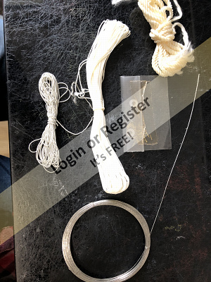

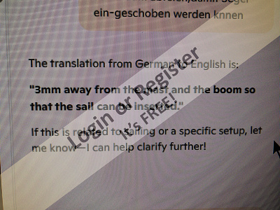

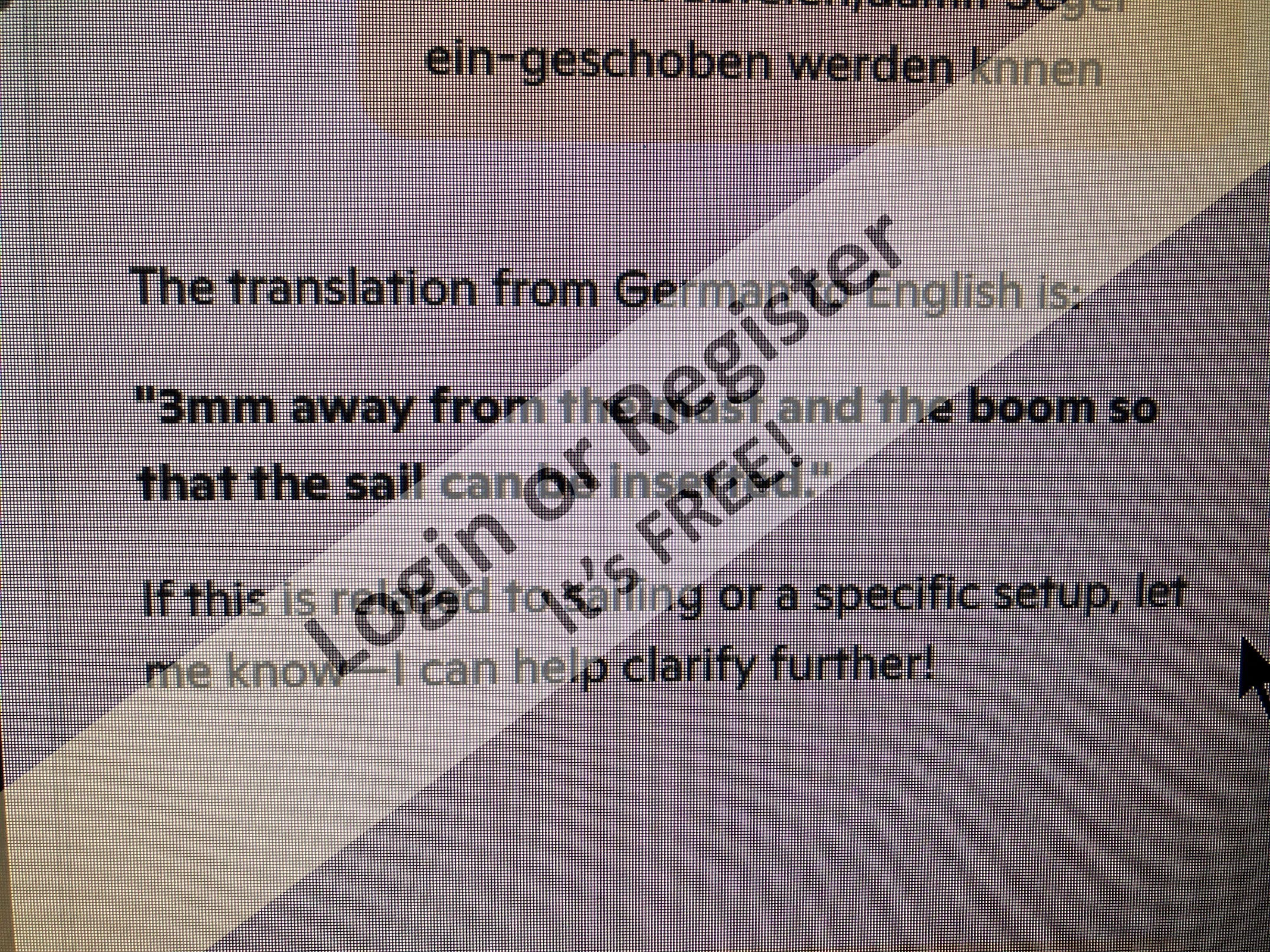

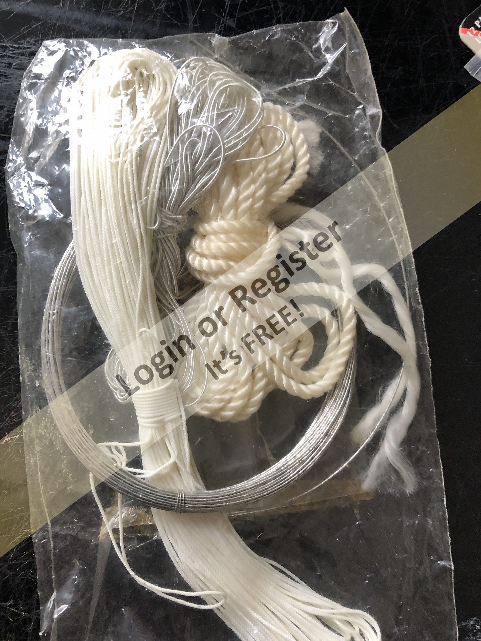

Thanks for all the support. I found a bag with a lot of goodies inside the hull. There is a wire that I think threads throw the sail. Then, the sail can be put in the groove in the mast. Print reads as photo converted from German. Sails have groments, so that part will be easy.
[{"id":"174293353831","name":"174293353831.jpg","caption":"","url":"https:\/\/model-boats.com\/media\/174293353831\/l","thumbUrl":"https:\/\/model-boats.com\/media\/174293353831\/s","isImage":true,"ext":"jpg"},{"id":"174293366397","name":"174293366397.jpg","caption":"","url":"https:\/\/model-boats.com\/media\/174293366397\/l","thumbUrl":"https:\/\/model-boats.com\/media\/174293366397\/s","isImage":true,"ext":"jpg"},{"id":"174293375049","name":"174293375049.jpg","caption":"","url":"https:\/\/model-boats.com\/media\/174293375049\/l","thumbUrl":"https:\/\/model-boats.com\/media\/174293375049\/s","isImage":true,"ext":"jpg"},{"id":"174293466789","name":"174293466789.jpg","caption":"","url":"https:\/\/model-boats.com\/media\/174293466789\/l","thumbUrl":"https:\/\/model-boats.com\/media\/174293466789\/s","isImage":true,"ext":"jpg"}]
Hi the slot in the mast is the opening to a key hole cross section running down the mast. The sail will have a sewn seem down this edge. If you find some wire or plastic with about 1mm diameter then this can be inserted down the seem and it will locate it in place and locked into the 'luff' groove in the mast.
Make sure the wire or plastic tube is long enough and trial fit it into the seam of the sail. If OK you can slide the sail with the wire in into the slot of the mast either at the top or at the lower part where there should be an entry point a bit above where the sail boom gooseneck is placed.
The sail should be held in position lightly and all the way down the mast. if it is tight then reduce the diameter of the wire or plastic used to lock it into the mast.
The sail should be on it's own string at the top of the sail and adjustable with a bowsie. This pulls the sail up.
It has to be held down loosely onto the sail boom and should also have a clew or rivet type hole at the other end of the sail to tension the sail along the sail boom.
This is how you introduce some curvature into the sail. Tighter for strong winds and a bit looser for light winds. Think of the sail as the wing of an aircraft and avoid wrinkles.
Hope that helps.
regards

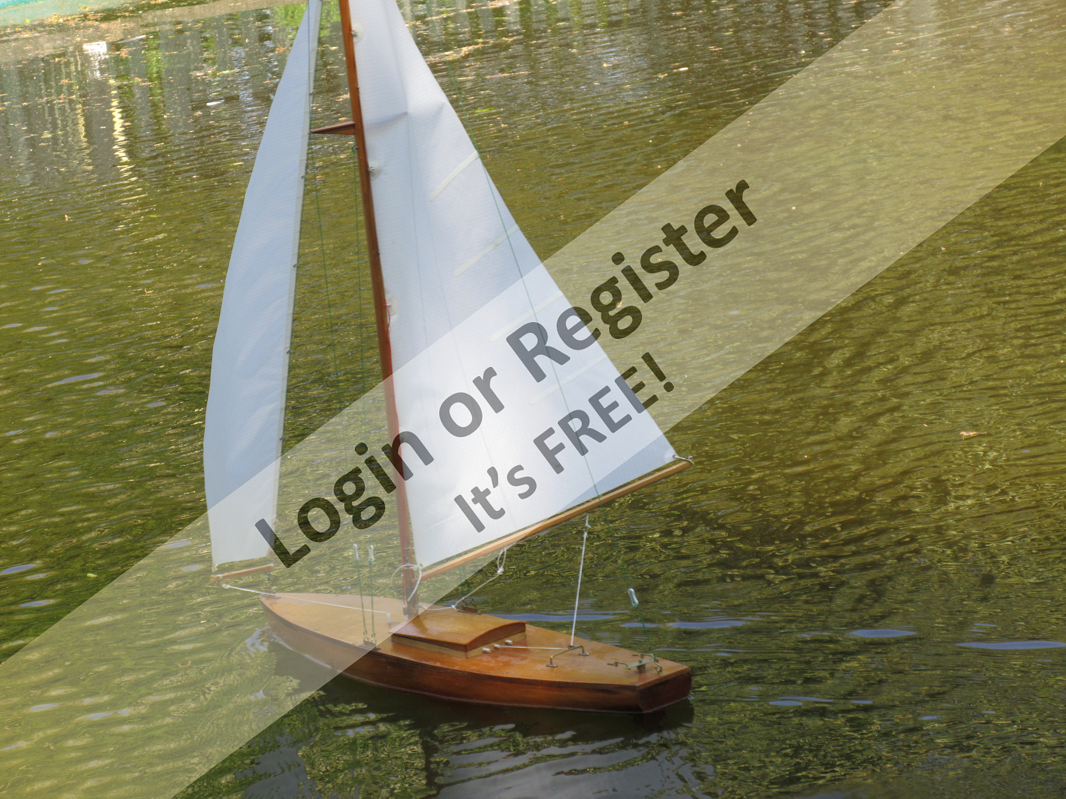

I am in a dilemma with my project Optimist sailboat. The plans don't seem to show me how the Main sail is attached to the mast my mast has a slot in it on sail side and is the sail glued into the mast slot or attached some other way
[{"id":"174291936851","name":"174291936851.jpg","caption":"","url":"https:\/\/model-boats.com\/media\/174291936851\/l","thumbUrl":"https:\/\/model-boats.com\/media\/174291936851\/s","isImage":true,"ext":"jpg"},{"id":"174291938035","name":"174291938035.jpg","caption":"","url":"https:\/\/model-boats.com\/media\/174291938035\/l","thumbUrl":"https:\/\/model-boats.com\/media\/174291938035\/s","isImage":true,"ext":"jpg"}]
