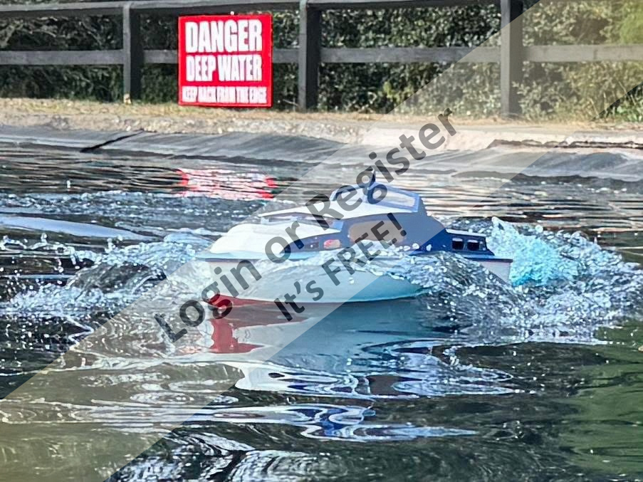

My Kopy Kommander was pictured in action at our Southport Club Open Day this week by a visiting member of the Bury Metro Model Boat Club.
Thanks for the picture Ken - that is a great action shot 👍
Photo credit Ken Mears.

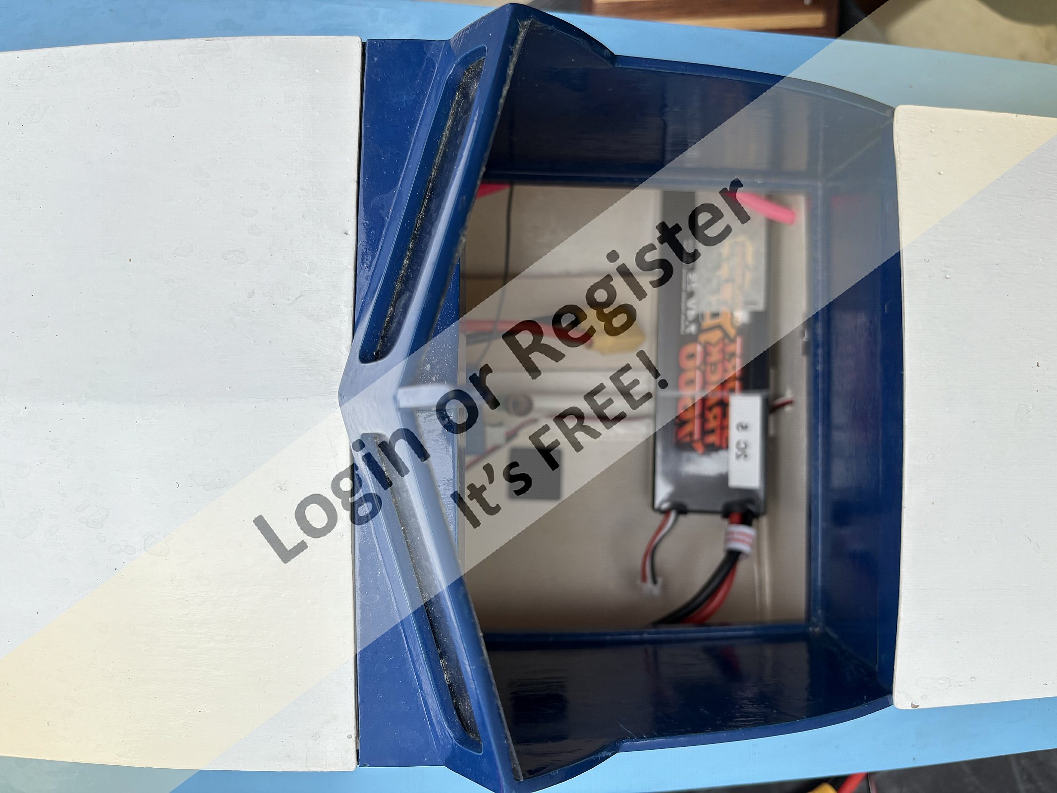

The two hard cases LiPo batteries have been moved back in the hull and are now in the next compartment under the cockpit.
I carry two batteries side by side, but I nearly always run with just the one connected.
Having one battery on each side means that the unused one acts as a counterweight for the other.
If a boat needs to carry any ballast, I like it to be useful (if possible) and not just “dead weight”, and by laying a battery on each side of the keel, I also get the weight as low as possible.
Today I will be performance testing the hull to see if the rearward shift of the batteries has stopped the boat wanting to dive when under power on choppy water following a sharp high speed turn.
I have left enough wire to also carry just the one battery across the rear of the cockpit floor, so that is another test that can be completed easily this morning to see what works best - and to find out if carrying less ballast has any improvement or detrimental effect on the boat’s performance and handling.

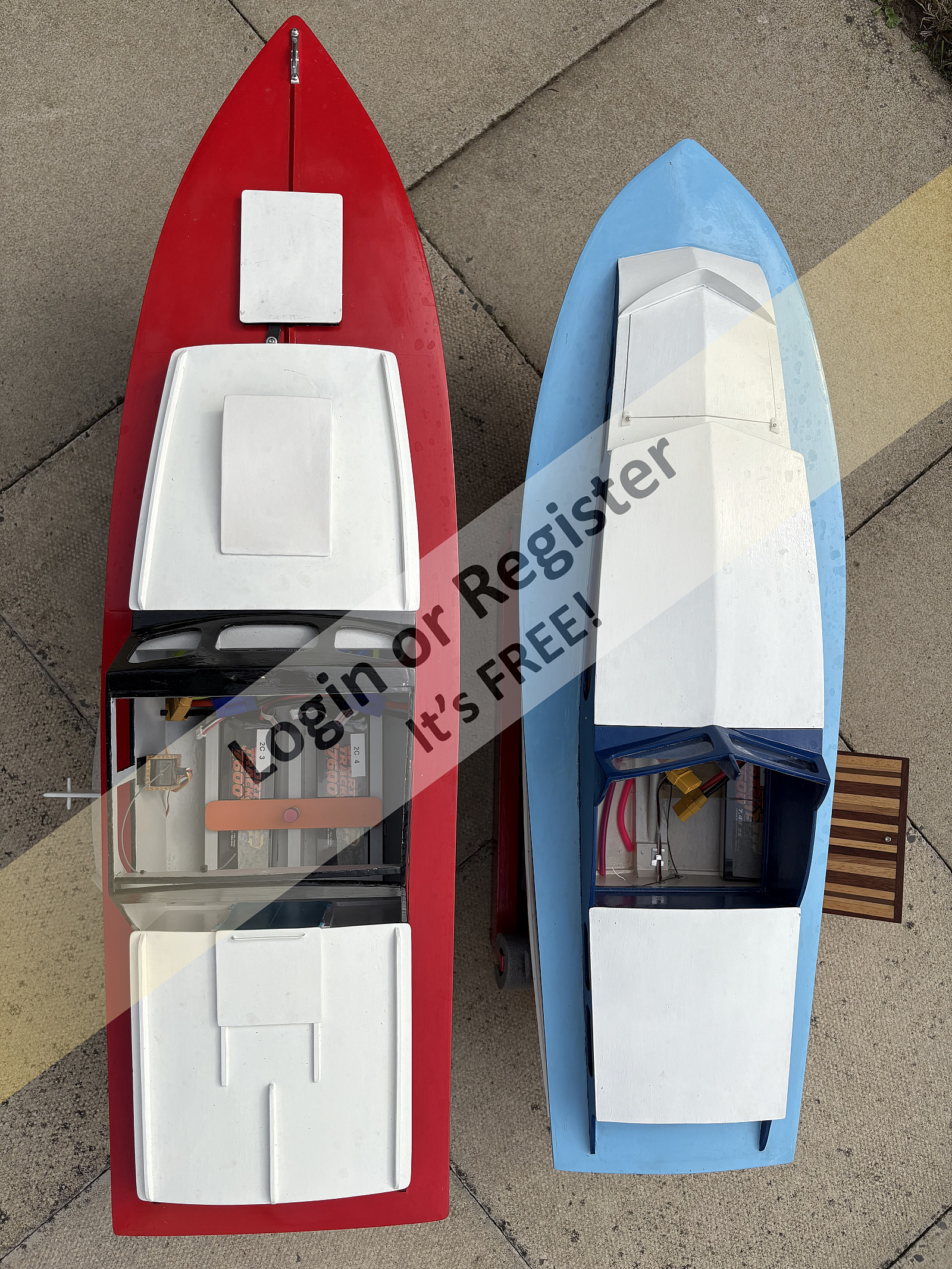

When I compared the Kopy Kommander alongside my Rapier the revised battery position makes a lot of sense.
I am not sure why I didn’t position them under the cockpit (as I usually do on my classic model power boats)in the first place, but at the time I liked the idea of housing the motor, ESC and batteries together in the “engine room”, but this has probably given a too far forward centre of gravity.
The overall size of the LesRo Rapier compared to the Kopy Kommander is interesting, but the approximate proportions are about the same, so the relocated position of the battery weight should help to balance the boat in a similar way.
The Rapier battery retaining method is shown in the picture on the left.
I may devise something like this for the Kopy Kommander as the “retaining strap” secures the batteries firmly, but is easy to unscrew and remove thanks to the threaded insert secured in the central divider.

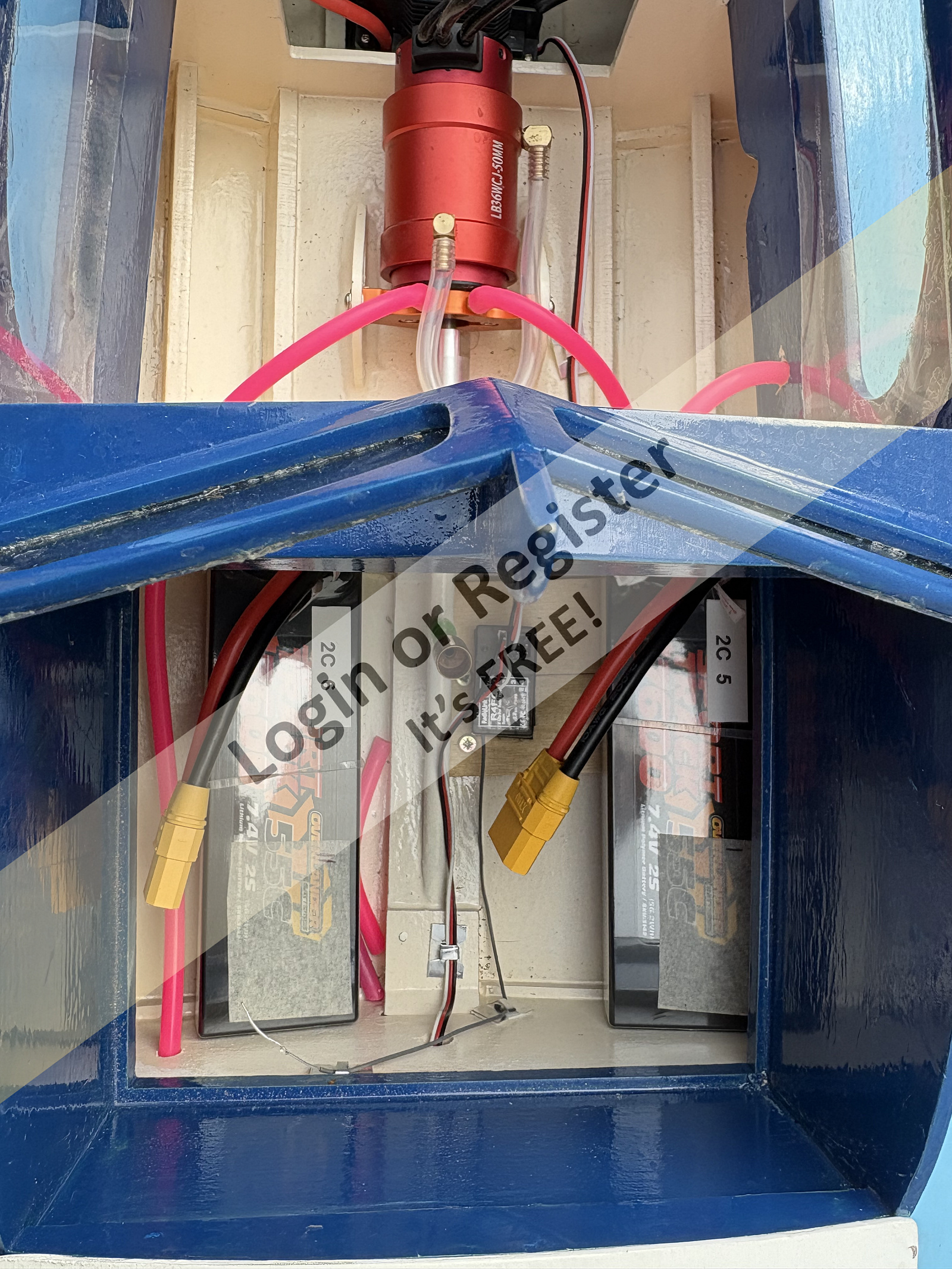

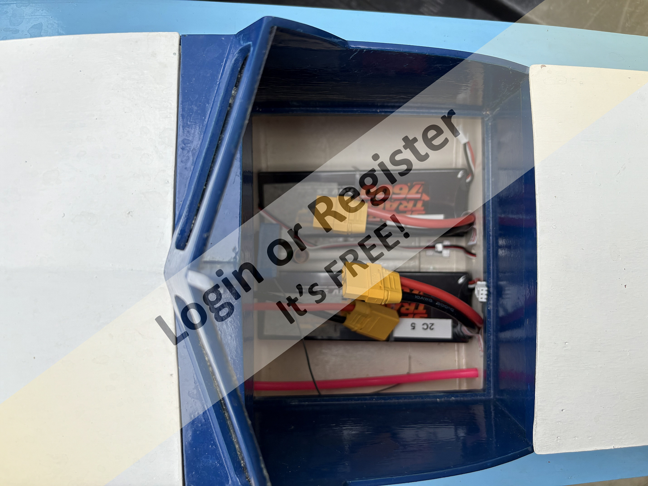

Following my worrying experience with the Kopy Kommander on choppy waters last weekend where it wanted to dive under power following tight fast turning manoeuvres I have decided to relocate the two 7600mah 2C LiPo cells to change the balance of the boat.
The picture on the left shows the boat as it is now with the LiPo batteries slotted into their “sockets”, one either side of the motor.
My plan is to move them back and out of the engine compartment and into the next rearward compartment under the cockpit floor.
This will move the balance of the boat more towardss the stern in the hope that this will prevent the boat’s desire to dig its bows into the water under certain conditions.
The second picture shows the two cells in their proposed position under the cockpit floor.

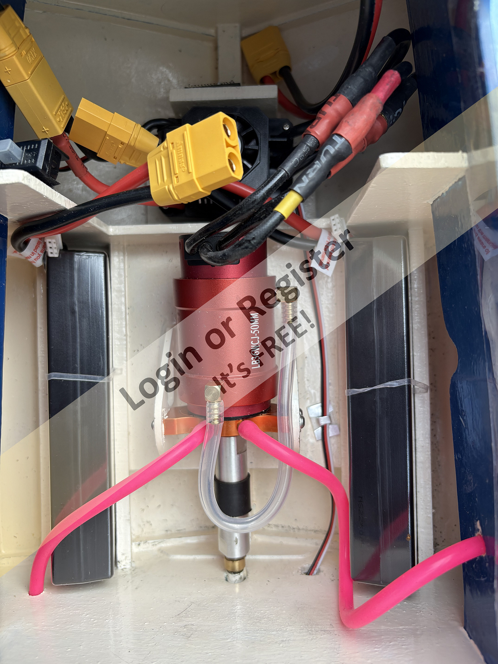

This picture shows the Surpass 150amp fan cooled ESC with the matching Surpass 3674 - 1580KV in-runner brushless motor - currently fitted with a water jacket.
Seen here fitted in the Kopy Kommander on a water cooled motor mount fully plumbed together.
The Surpass ESC provides forwards and reverse speed control but seems to “surge” a little as the throttle is opened from a fast pace to full speed.
Liked by zooma and jumpugly and

This is the first model that I have not used a water cooled ESC on Ian, and is the first one that has a reverse . I chose to use a fan cooled Surpass 150amp ESC and so far it has run cool enough.
This is also my first build using an in-runner motor. The water jacket that I slid over the motor has covered the markings so at this moment I cannot tell you what type it is other than that it is a Surpass motor.
The slide on water jacket is sealed at each end by an “O” ring that I greased with petroleum jelly to help it slide on and to help the seal remain water tight, but in practice I have found that it has a slight weep, so I re-routed the water cooling from the pick-up to the motor mount and then directly to the outlet nozzle to bypass the water jacket.
When I remove the motor to take off the water jacket I will be able to see any markings that are on the motor and let you know what type it is.
