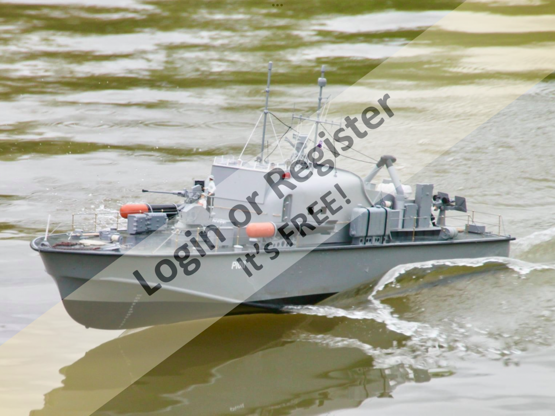

You're right, John, it navigates perfectly, and you made a very impressive video (too bad it's so short). How much does your RC model weigh?

Good afternoon AlessandroSPQR the craft has twin opposite rotating 25mm props with 3 blades and has a total weight of 3.2 kg. See photo. One other point the hull is actually a hull I built for the Brave Borderer and put to one side in favour of a commercial glass fibre hull for the Brave. Then on receiving the plans for the 2755 I superimposed the pre made hull on the plans, the size and profile matched within 3mm in beam but was I recall to long by 125 mm at the stern.this was too near to pass up, so I just cut the stern down and fitted a new transom. I now had a pre made hull that needed a deck etc fitted. So using the Braves hull has probably helped with the planing. It is after all a proven pedigree design!.but the Brave is another discussion I’d like to have with you guys at a later date, I have power problems??.

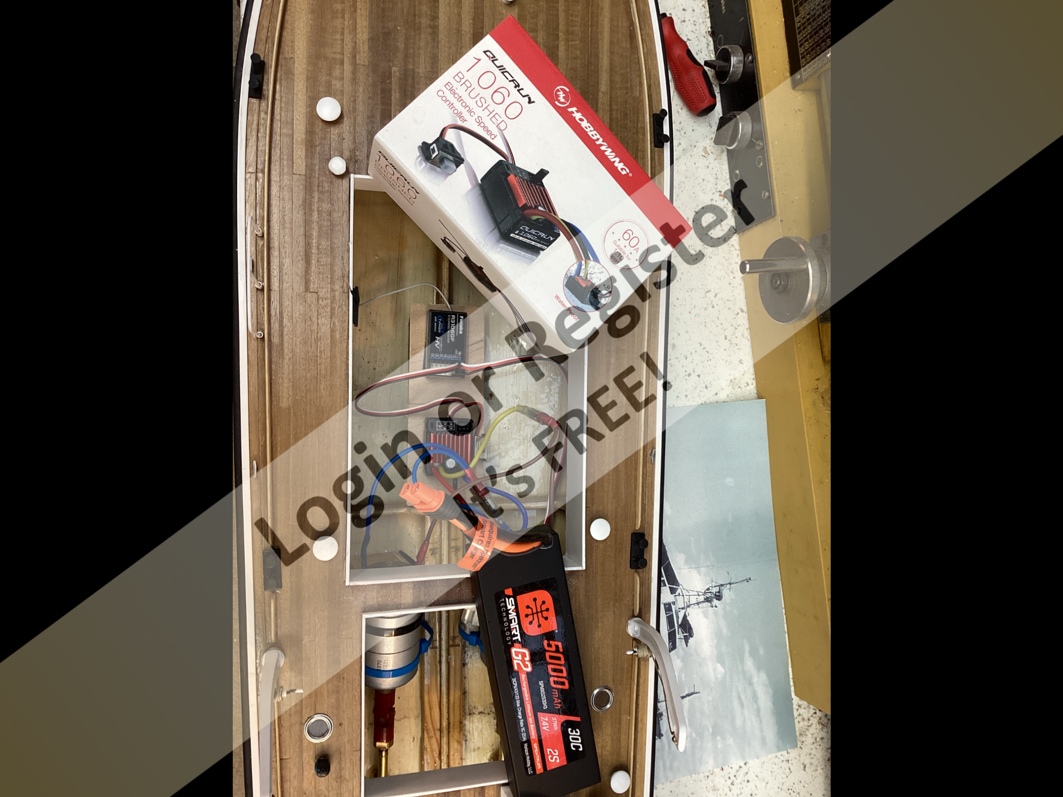

Hi there, not trying to deviate too much, however, the aforesaid motors, I believe are a stock motor from China. They are manufactured and sometimes come into the modelling stream under the name of Mabuchi and Companies buy them in and rebrand them under the Companies name who have bought them. I say this because I have some MFA motors which are identical to the one in this listing and also the ones in my Launch come from MTroniks and they are branded as Vision 600s or something like that. MTroniks seem to have the same specs. I run mine on 2 x 500 amp 7.2 volt NiCads. There is obviously a bit more weight in the Launch which I built - that is because there is a sound module an amplifier and speaker; plus there is one of the very first ACTion twin speed controllers and mixer. I will put some photographs on of the layout to give you some idea. The first photograph is the rear bay of the craft which houses the speed controller, sound module and 6 channel receiver. The 2nd photograph shows the installation of the motors. The 3rd pic shows the amplifier and the speaker and this is in the forward compartment of the boat and also there are the battery trays for the 2 NiCads and there is a 9 volt stick batter which sits between the battery trays, which supplies the power for the sound system and amplifier. I still get about 30 minutes run at a good turn of speed.

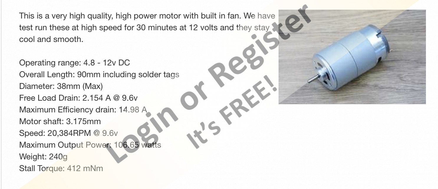

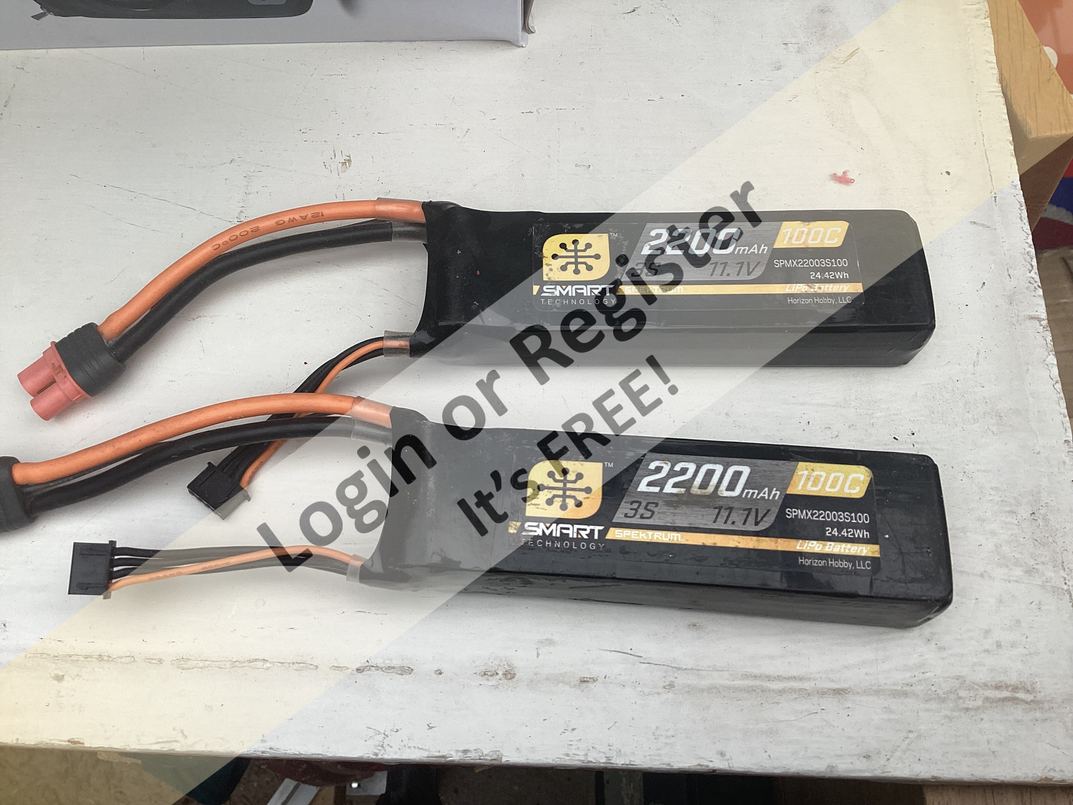

Good evening AlessandroSPQR the black battery was for test purposes only, while I waited for the spectrum 5000m/ah 7.4 v, lipo 2s to arrive. The motors I believe are as photo spec hope the info helps. I sometimes use my other battery, same make but 2200m/ah, 11.6 v,lipo 3.look forward to your thoughts.

I'd like to know how many volts and, more importantly, how many Ah that black battery you see in your message number 7 has.
Could you also tell me something about the motors? If you know and remember the code, I'll look for information online, or about maximum operating voltage, stall current, operating current, etc. etc.

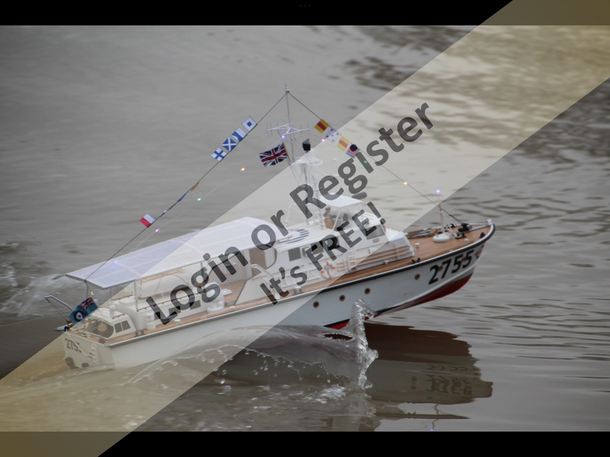

Thankyou everyone for your interest, it really makes it all worthwhile when you guys stop and take a look, especially when I see and aspire to the fantastic work that you all actually produce. He are some closer photos of the 2755, thanks once again.

She rides well Rogal, looks good👍Great build. Hat off😉
At that speed she'd sure keep the gunners on their toes!😮💥💥💥 💥💥💥 💥💥💥

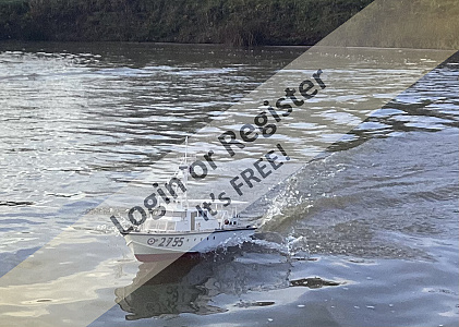

Fired up my Far Eastern version in white livery with sun shade canopy at the pond this week.heres a video of my powered run,
