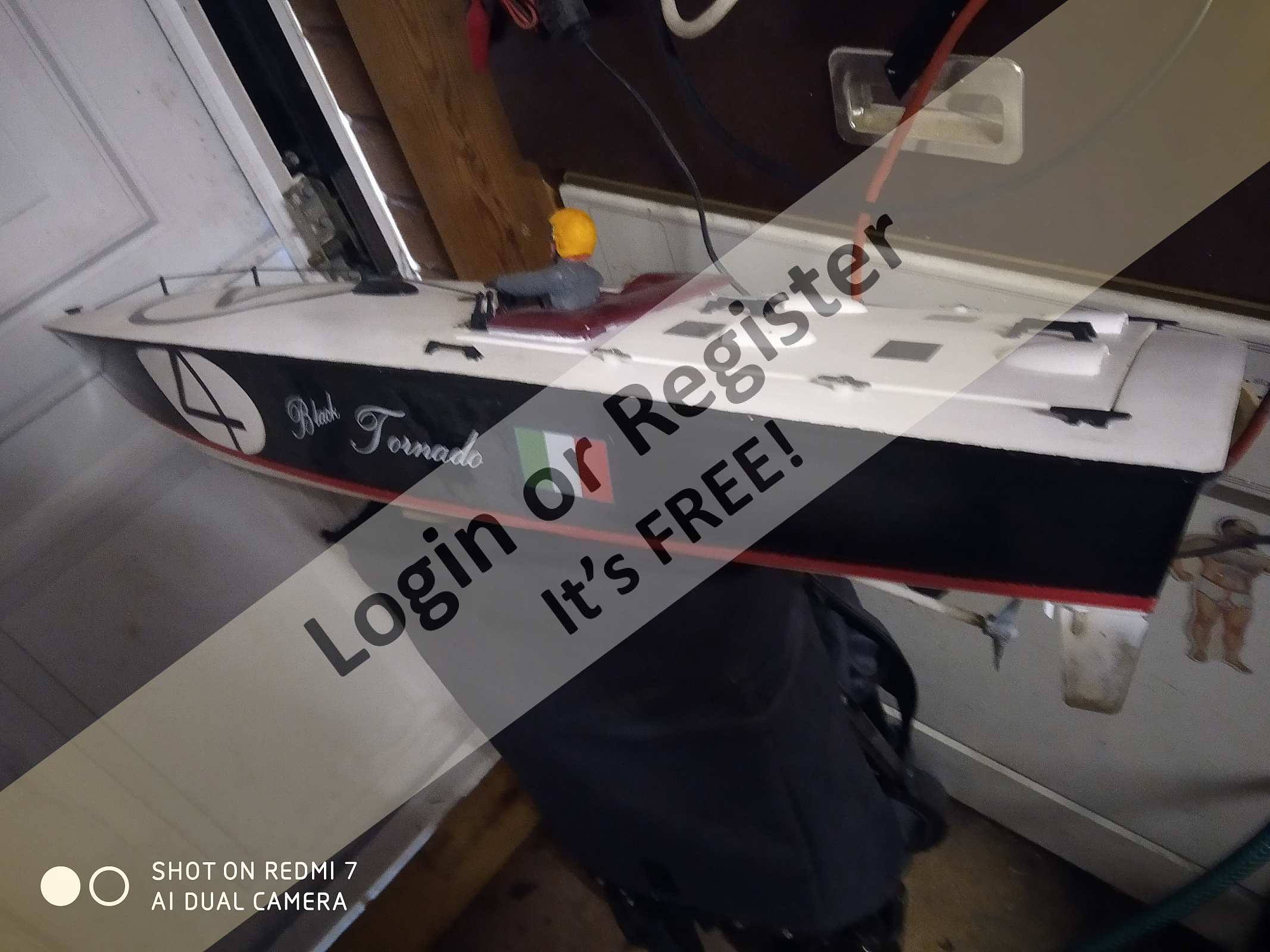

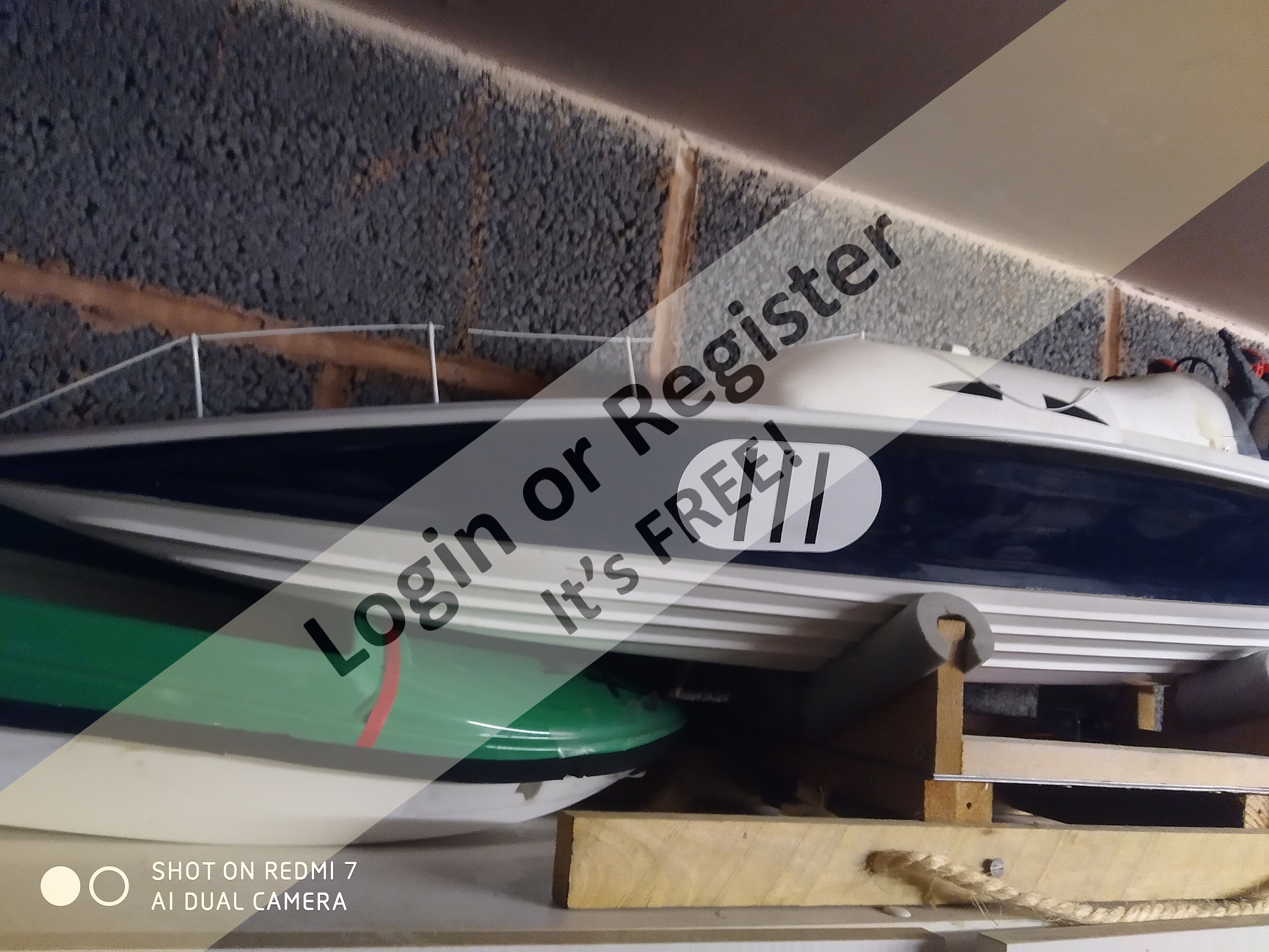

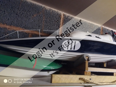

Hi Patrick,
Your Tornado is looking really slick.
Have you ever clocked or calculated its top speed? I’d be curious to know what she can do out on the water. ⚓

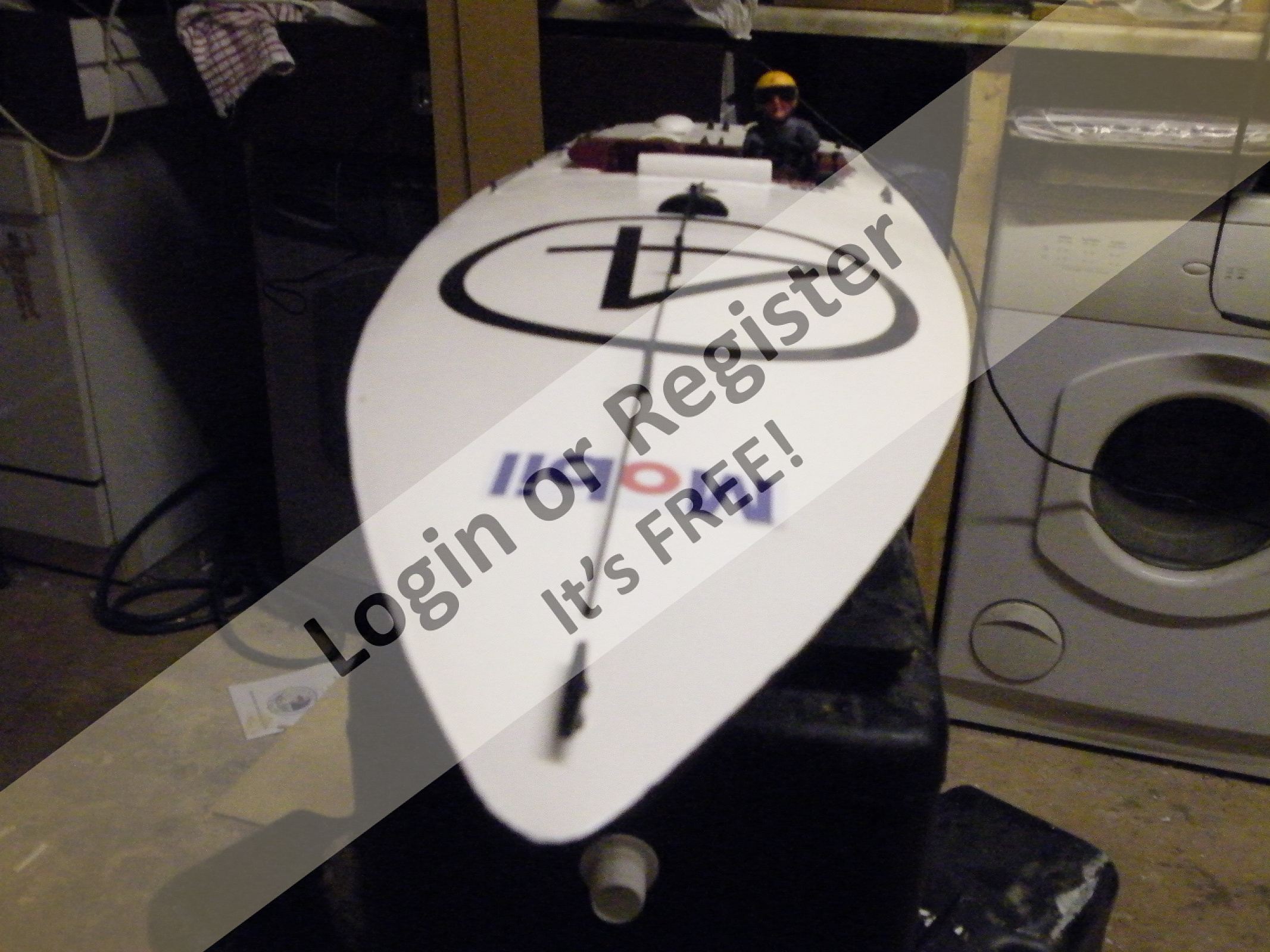

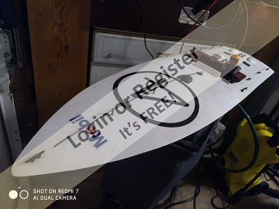

S.H.G Black tornado
I still sail my original BT but now electric brushless,2200kv 2-3 s. I acquired another Cigarette hull with Enya 40 installed, needs a new head gasket, which I might change for a new OS 30. I also have another cigarette (not SHG) and a BT variant. Look good next to my SHG Surfury.

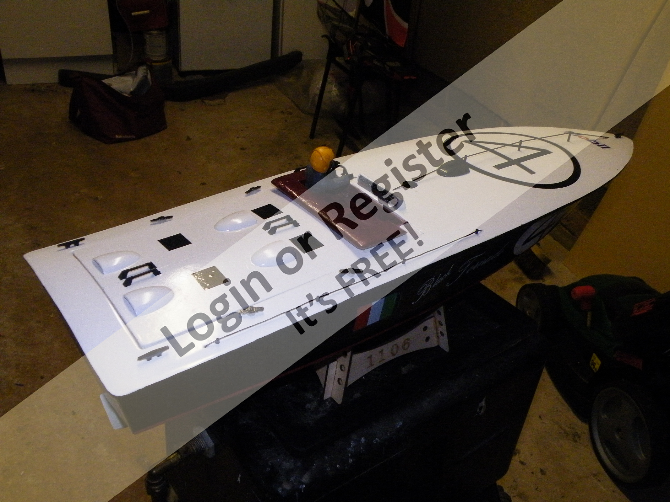

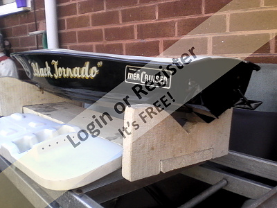

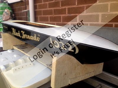

S.H.G Black tornado
looks good, not many about now, Meteor 40 should give it speed but not too powerful nor too heavy. Please keep us posted on restoration and show some photo`s of progress.

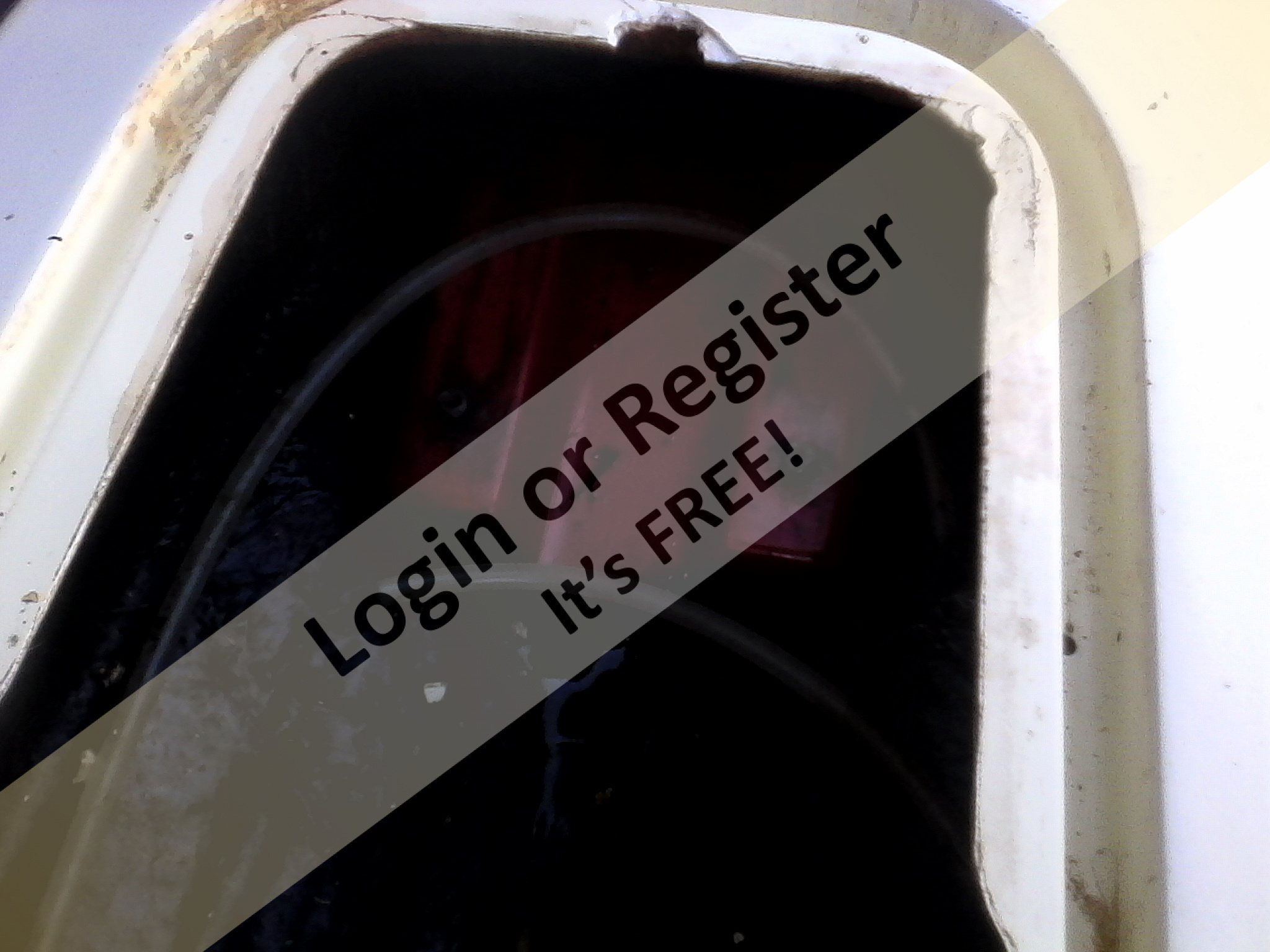

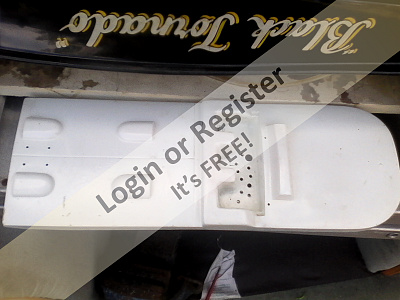

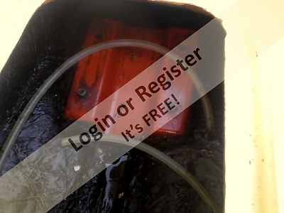

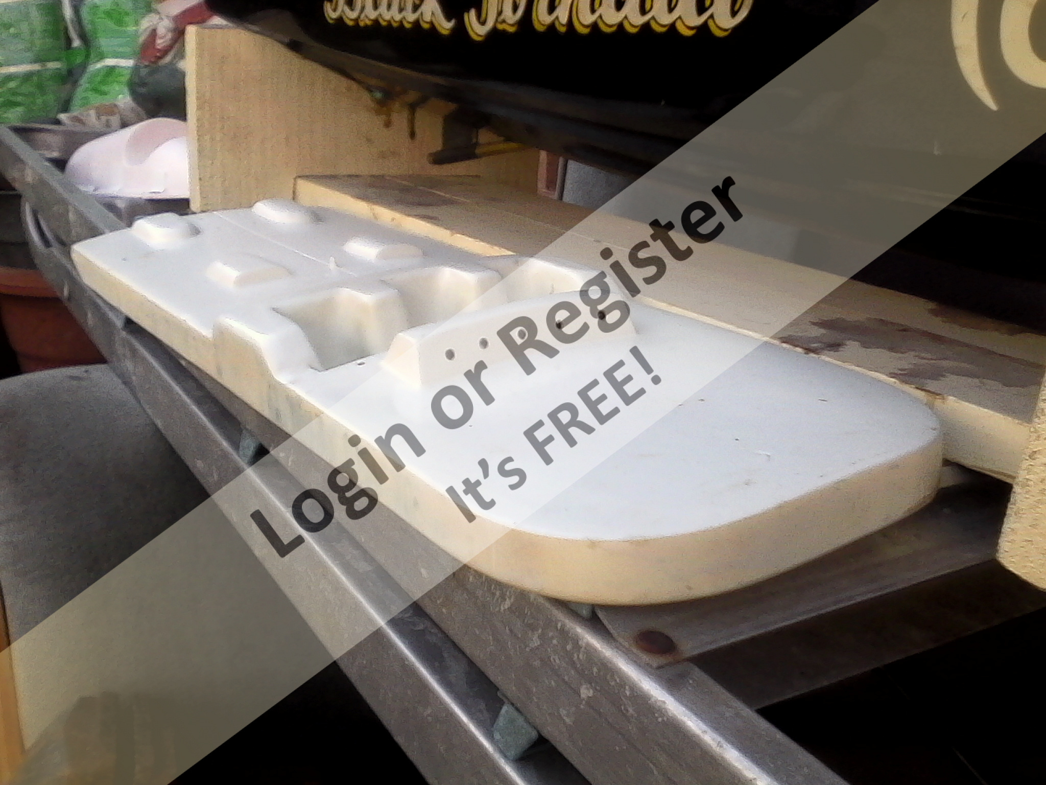

S.H.G Black tornado

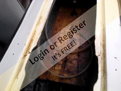

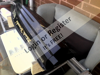

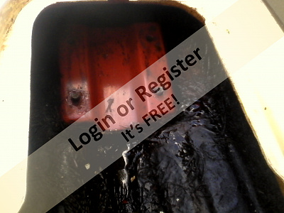

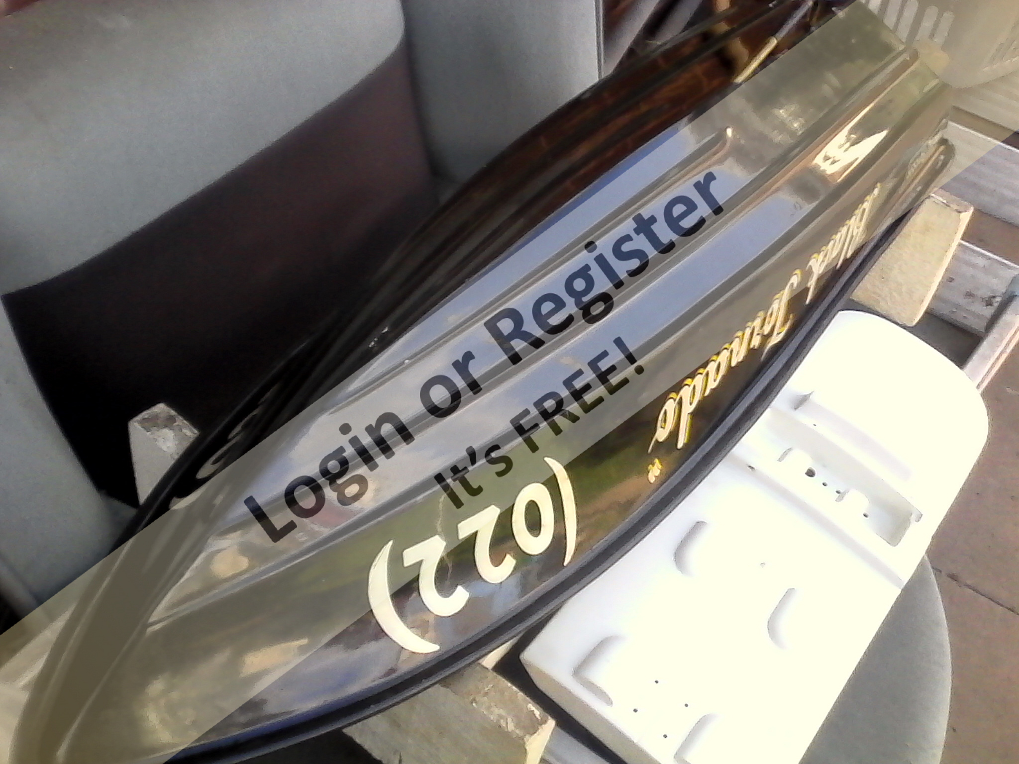

hi got this off internet not eBay!!!! going to over the winter add meteor 40 engine propshaft n' tube were already fitted as was water scoop n' outlet ,rudder , trim tabs,a 2channel Acoms r/c receiver and and 2 servos no trans. but it did all work ( all in a gooy margerine tub possibly the best part of 40 yrs worth of GOO!!!! Hull /deck look to be in good condition! will keep u informed on "resto" over the winter months regards
