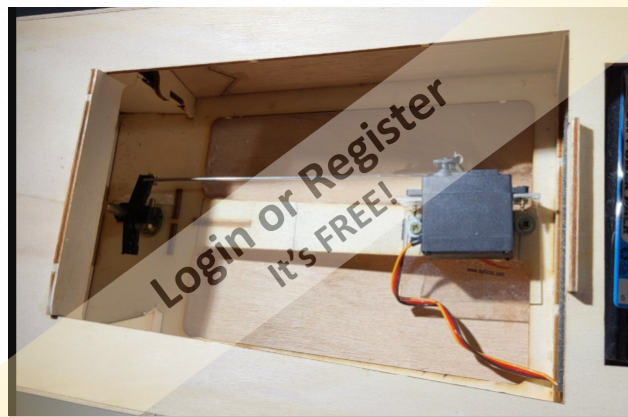

Hi Roy, yes it is shoehorned into a tiny space. I think it would have to be fitted before the decking is applied! I've seen another solution in which the servo is installed on it's side along the keel.😊

Glad I was able to clear up this explanation with the help of the photo.
All the best D

Thank you very much for the clarification Duncan and especially for the photo. I just couldn't understand. Now it's clear to me.

Hi Duncan and there you have a way to fit in the rudder servo.
