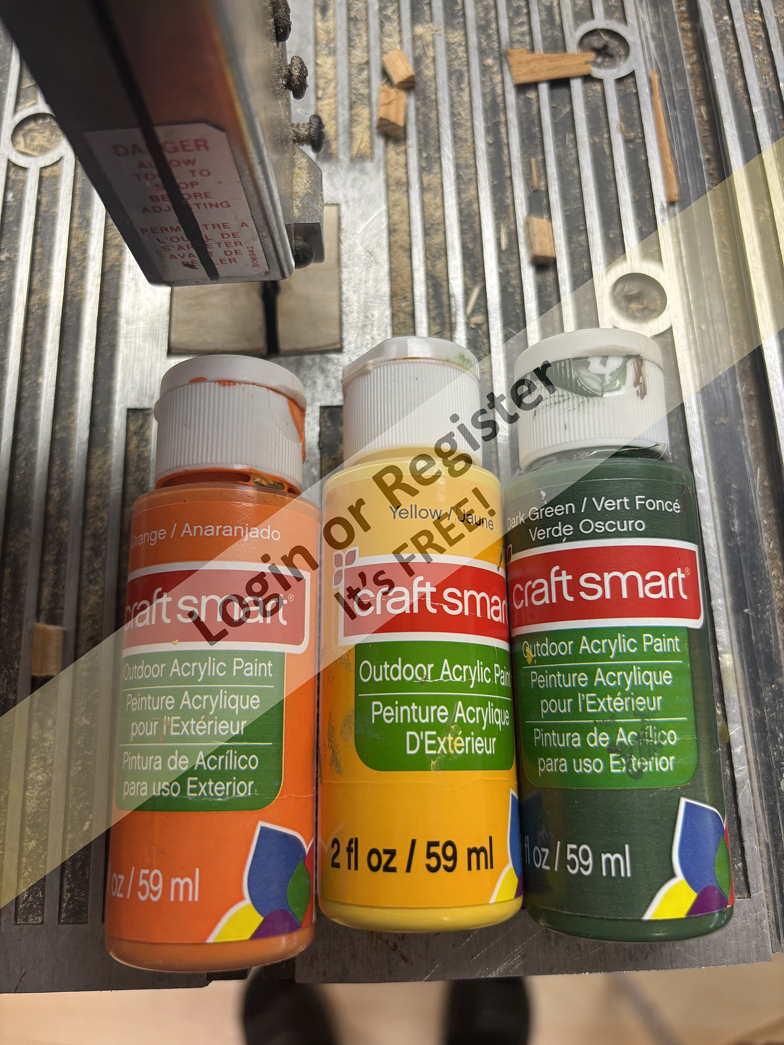

I use Minwax products to seal the interior and exterior of my models.
Minwax Clear Polycrylic Water-Based Protective Finish Satin, Semi-Satin or Gloss
I looked at Eze-Kote which is much more expensive.
When comparing the two products, they have similar characteristics but also varying pros and cons.
I did a Google search using:
“Eze-kote finishing resin vs polyurethane water cleanup minwax”
______________________________
My models are generally painted after the several coats of clear.
Depending upon the paint used, I will give a couple more final clear coat applications.
The paint I have begun using is an Outdoor Acrylic Paint from “Craftsmart” used on both these models and with a final coat of clear which protects the paint from skuffs.
