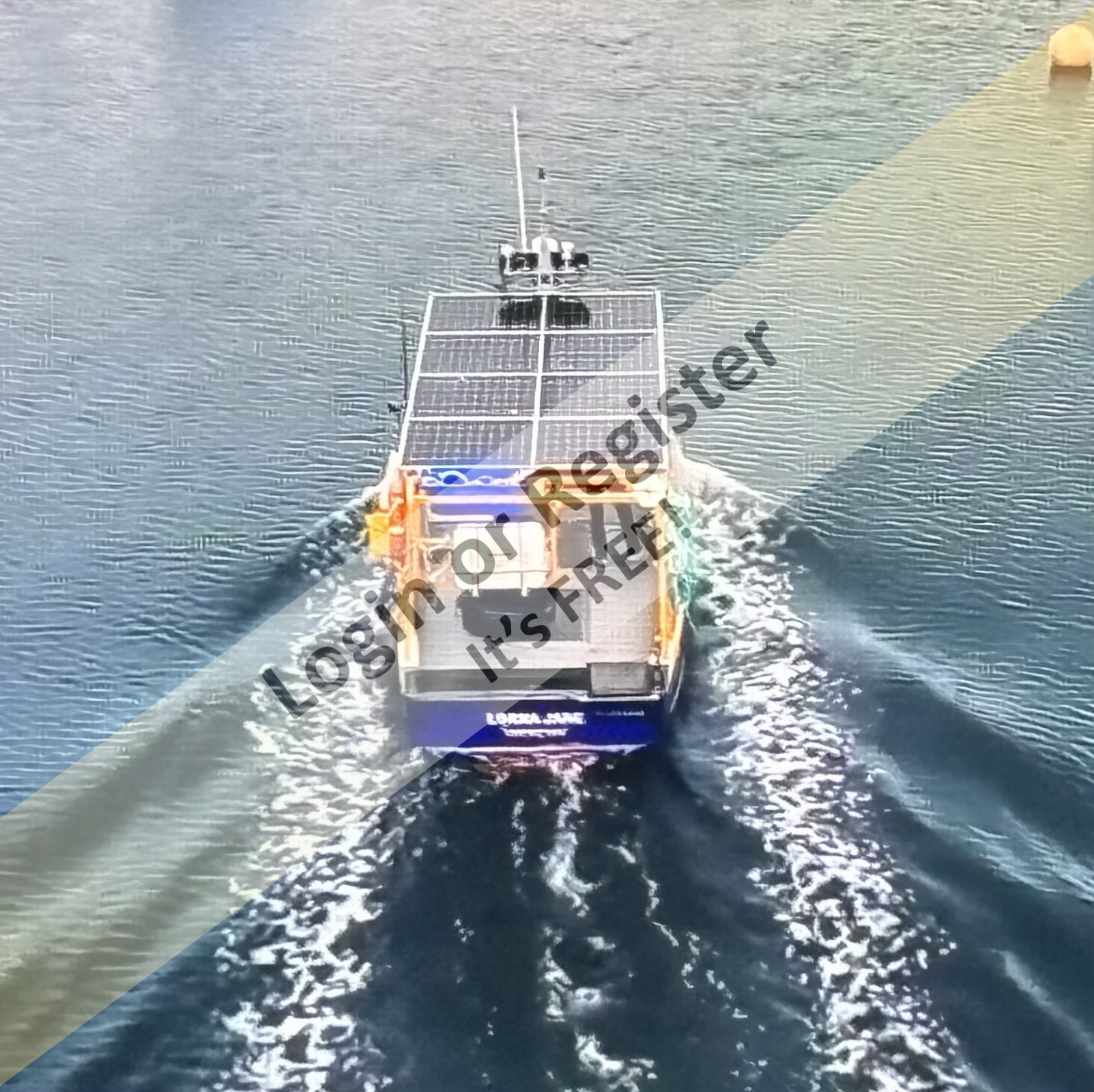

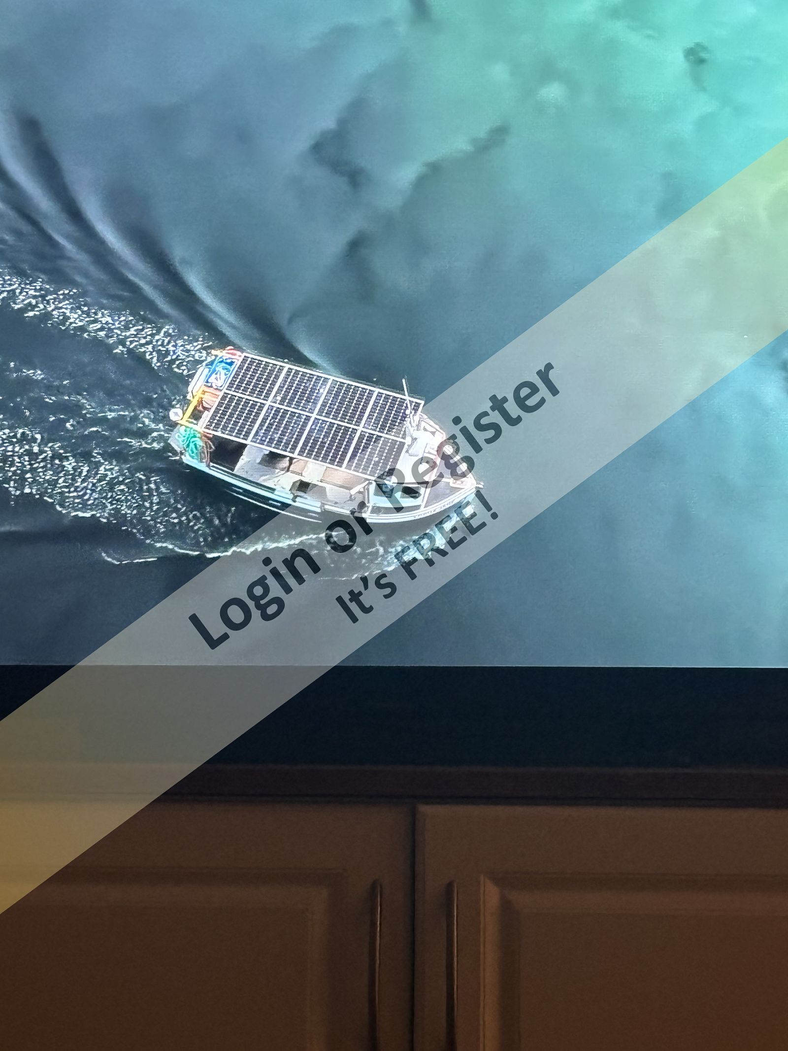

The point is, you need to consider the type, number (and configuration) of solar panels you are going to use BEFORE deciding on the scale of the model, otherwise the chances are you will not have a good fit on the available area and the performance will be poor.
In your case, I looked at the overhead photo and saw there were eight roughly square solar panels. My first thought was that 150mm x 150mm panels looked a good candidate for a model, hence the 600mm x 300mm roof area for the eight panels. But there are many different sizes available and if you can find a size that can be arrayed to fit your roof area nicely then go for it, but more likely you will need to vary the size of your model to get an optimum fit.
I see there is a 136mm x 110mm size, eight would need a roof area 544mm x 220mm, that might suit your model better. The other thing you will need to bear in mind is the electrical configuration. These panels are rated at 6v 0.33A each, so 8 of them could wired to give 12V at 1.3A or 6V at 2.66A in series/parallel (16W) for which you would get a suitable motor. Note that in this case, even if you had room for one more solar panel, it would be unusable without another one or three panels to pair it up with.
See: https://www.aliexpress.com/item/32905776528.html?spm=a2g0o.productlist.main.42.140e3293J5nhwL&algo_pvid=39ceffd8-5072-4e2b-8818-588a4721ed85&pdp_ext_f=%7B%22order%22%3A%22886%22%2C%22eval%22%3A%221%22%2C%22fromPage%22%3A%22search%22%7D&utparam-url=scene%3Asearch%7Cquery_from%3A%7Cx_object_id%3A32905776528%7C_p_origin_prod%3A
See what you can come up with juggling these three parameters.

Your solar panel recommendation:
300mm =11.811 in
600mm =23.622 in
Rounding up 12” x 24
John, the Cygnus GM21
21ft length x 8 ft beam
6.55 metres x 2.44 meters
A 1”:1’ model is 21”x 8”
If the model is to represent the one pictured, the model will need to be much larger to receive a solar panel 12x24
1.5”:1’ will equal the 8” beam
The length would be 31.5” x 12”
Scratching my head about those numbers. 🤔
