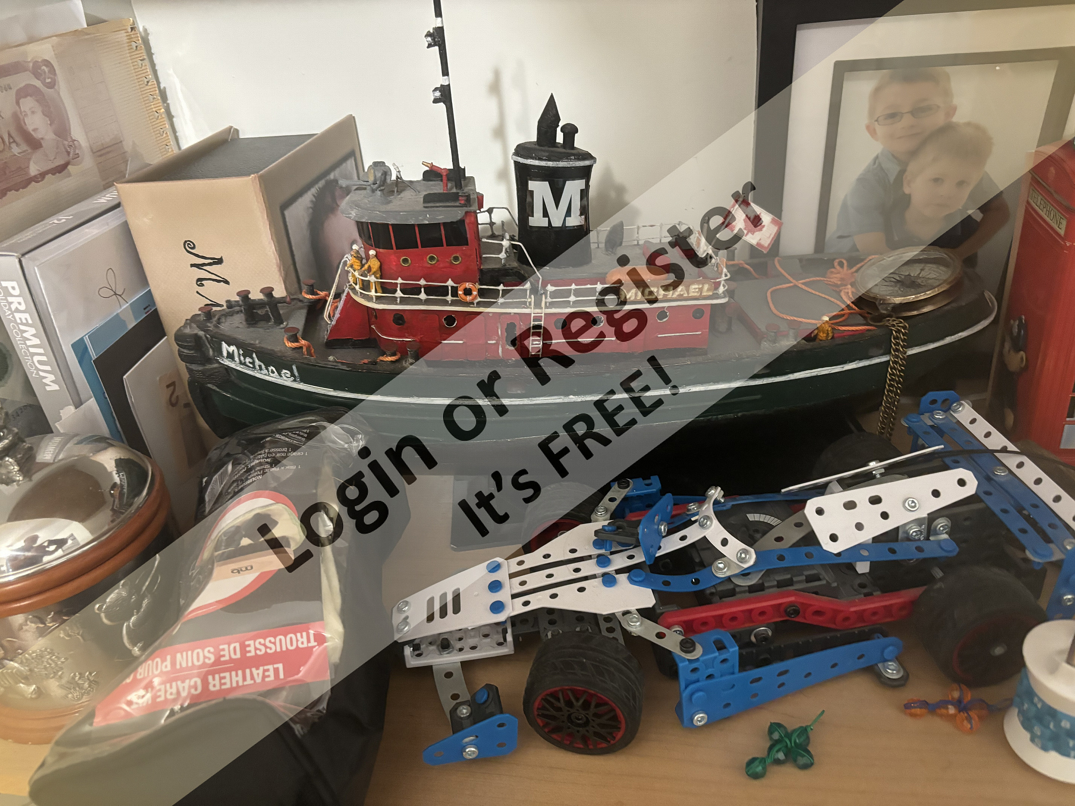

Well I hope it never happens again. It’s been said “live and learn”, and I did just on that day. I didn’t know the wheelhouse cover had drifted off as the hull sank. A man found it on the far side of the pond a couple days later and returned it to me.
After stripping the guts from the hull and resting them in containers of Rice, most of the gear was restored after a couple months.
The tugboat did sail again but it was retired from service to be a lamp in my grandson’s bedroom on a shelf along with his Lego prizes.

This incident was 10 years ago, but maybe you didn’t read that correctly.
I quickly learned the rules and have had no further issues with a boat capsizing.
That tugboat is now a lamp in my grandson Michael’s bedroom. He helped me to build and paint it, back then too when he was 5 years old. He is turning 16 on Friday this week!
