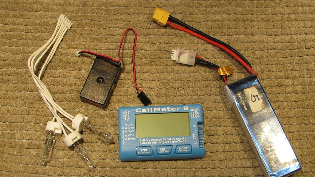

#38 83
Hi Bob
When looking at a Lipo battery you should understand how the cells work firstly. The cell is a wrap of basically two films separated by a gel allowing the voltage to be generated and stored. This is called the dyelectric and is the main cause of bloating the cell if it begins to breakdown. When you look at the internal resistance of the batter is show the health of the cell below 10 is OK. If the gel is damaged between the two films or one of the film coatings is damaged you will see the internal resistance climb.
Once the cell is bloated it is no longer considered normal and can become unstable causing gas to be released its very rare to explode (its called thermal runaway and can reach 500 plus degrees and is normally cause by internal issues or a dead short of the battery) . I would suggest being very careful with storage and charging ie not to 100 percent.
So what causes this :-
1 temperature operating outside spec which I cannot see you would have done this.
2 over voltage never take it over 4.2v on a charge or discharge below 3.2v. There is a rule for storage between 75 and 80 percent.
3 over rating current draw. Your battery is 25 to 30c which means
25 x 5000(ah capacity). = 125000 which is 125 amps which is continuous discharge. Which is higher rated than the speed controller.
4 manufacturers issues weakness. Its possible but as you have another 2 batteries with same batch number I would. Monitor them.
5 charging at low temperatures below 0 degrees which most chargers block.
I know no definitive cause is clear which is a problem. I would just monitor the bloating is does look slightly but any boating is not good. Keep them in isolation bag and only charge to 80 or 90 percent.
I terms of fixing the bloating there is nothing you can do. There are no ways to fix the battery.
Hope this may help
Adam

#37 92
Carry On (for now).
The two bloated 3C LiPo packs that I have been using in my Remora were checked and charged again this evening.
LiPo 1. Before charging the cells resistance was 3 4 2. After charging to 98% the resistance was measured again at 4 2 1.
LiPo 2. Before charging the cells resistance was 3 5 2. After charging to 98% the resistance was measured again at 4 2 2.
Both LiPo packs remained cool during a Balance Charge at 2.5 amps.
Before charging the voltage on both packs measured the same as each other (3.9 3.9 3.9 volts per cell) and were also the same as each other after charging (4.16 4.16 4.16 volts per cell) so both packs still have perfectly balanced cells.
The above readings continue to confuse, I will keep these two packs in a fireproof LiPo sack and continue to use them with caution but monitor them during use in the boat and during charging.

#36 92
Still Working Well.
Both of the “Bloated” LiPo batteries were run in the Remora again this morning and both worked OK.
Both were checked to see if they were running at all hot, but both were only very mildly warm after a full session of driving the Remora “briskly” around the lake.
I will check them again this evening as they are both being balance charged and take a resistance reading both before and after charging as well.
At the moment these cells are the cause of some concern as they are definitely swollen, but both run and charge perfectly without getting hot and both have very low resistance readings.
I am more than happy to dump them both if they show any signs (other than the swollen heat shrink covering) of getting hot when being run or during charging - or showing any high resistance readings, but it would be a shame to throw away two perfectly good working LiPos when both of them display no fault other than a bloated heat shrink covering.
#35 100
Double Bloated.
The picture I showed on here yesterday of the LiPo in the Remora hull identified it as NOT being the same LiPo as the one I noticed as being “bloated” - as it was marked Remora 2.
The “blown” LiPo that I had concerns about was marked Remora 1.
I remember when HobbyKing had an offer on these LiPo’s that their postage costs made buying one a “non-starter” (their LiPo delivery costs to the UK are very high) - so I bought 4 of them to make the cost per battery more affordable.
I marked them as Remora 1, 2, 3, and 4 although they were not all necessarily going to be used exclusively in the Remora hull, it was a way of identifying them.
I took a look inside the “fireproof” LiPo sacks that I store them inside and took all 4 of them out to be checked.
The LiPos marked Remora 3 and 4 had only been charged once - probably after delivery to check they were OK and to see if the cells were balanced. These two LiPos coverings are completely FLAT with no bloating of the heat shrink coverings.
The LiPo marked Remora 2 had only been charged 5 times, and it was found to be almost as bloated as the one marked Remora 1 that first caused me some concern after it had only been balance charged 8 times.
This does prove that all 4 of these LiPos had FLAT heat shrink coverings when they were new (I would have noticed if two out of the four had puffy coverings) and that only the two that had been used now have “blown” heat shrink covers!
The answer to keeping these particular Turnigy 5000mAh LiPos safe is seemingly NOT TO USE THEM !
This may be a bit severe and I will check the resistance of all 4 packs, but the two that have bloated have only been used in the same Remora hull so I would not think they had been put under any great strain in use whatsoever.
This does cause me some concern as I have no reason to suspect that the two unused cells will not also puff-up their coverings when they are actually used.
All of these LiPo’s have only ever been “balance charged” from new at 2.5 amps, which I don’t think is an excessive charge rate for them.
The two that have been used have powered the small Surpass C3548 1100KV out-runner drive motor via a 90amp SeaKing “forwards only” ESC and have not been allowed to run down low enough to cause the ESC to cut-in and stop the power delivery before it could drop below the terminal voltage.
After each run the Remora was always driven back to shore when still able to deliver its full performance, and when re-charged the LiPos still had around 40 - 50 % Fuel in them, so they have never been allowed to run too low.
At the moment I am thinking that I may have bought 4 “duff” Turnigy LiPo batteries, but until number 3 and 4 have been run I wont know this for sure.

#25 113
Trying to show the bulged heat shrink covering in a photo is proving to be much more difficult than I thought it would be.
When squeezing the LiPo the covering can be pushed in and out in what feels like quite a lot of movement.
The pictures don’t really show the bulging anything like as much - but here is a picture of each side anyway to show the front and the back as both are swollen
