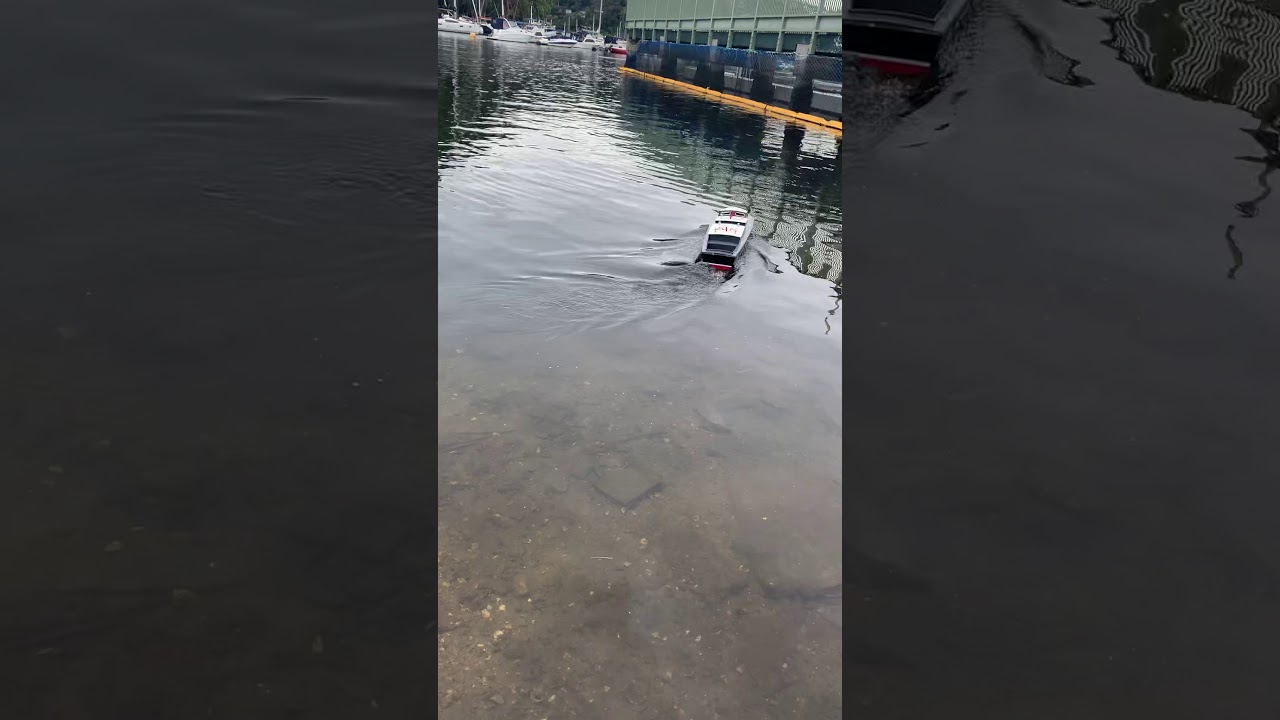

Your model looks good on the water, I have a similar problem on my old aerokits 34.5 inch version due to the fact it was originally ic powered and the angle of the propshaft is too steep, this tends to lift the stern as it pushes.
Also I found that by increasing the size of rudder helped in the turns.
In the pictures of my Norstar 34.5 inch version I have lowered the thrust angle, the prop is a 40mm 3 blade brass, and the rudder is 50mm deep, set with a 25 mm spacing to allow for the water pick up and easy prop change.
I am also thinking of fitting the rudder with a horizontal fin on the bottom to help stabilise the thrust .
Cheers Colin.

Hi Schmango
I have my two 3S 4000mah Lipos mounted each side of the rudder.
That's the only way I got mine to turn better.
The boat is not great on the turns at the best.

Hi all - finally got to sea trial this today . The most notable issue is shaft alignment which is why it sounds like a two stroke engine . The 5mm shafts are very old and have some pitting in the metal which is strange. There is a small amount of play with them which I’m guessing is causing the noise . The motors are cheap 700 size drill motors from eBay which do the job I think. Props are 45mm but I couldn’t find counter rotation in 5mm props so they are the same which isn’t a big issue.
Turning circle is terrible and it wants to nose dive even though the lead acid battery is towards the aft. Looking at other models of this boat it seems to be common though ? Is it normal to have the props and rudders a fair way apart as per the pictures?
I restored this model so I don’t know it’s history or age - it has definitely been built by an amateur and was possibly petrol powered once. I’m guessing it’s from the 1970 era .
Overall it’s a great boat and I’m happy with it .
https://youtu.be/Ac-DaFtMJgw
Cheers
The 4.8s are as good as 5s and would only require a bit of clearing out. I would run a 5mm drill in reverse through them which should make them a good firm fit or just give them a touch with a needle file. See if you can make a jig with close fitting dowels to stop them spinning and use a blunt drill to stop it biting, (you can take the edge off by gently drilling a concrete block for 1 sec) - start off with say a 4.2mm drill, then 4.5 etc and work your way up to just undersize, then use a 4mm reamer to finish it off. less chance of getting a bit off square. Bit harder without a drill press but it can be done. I'd go for a 4.8 if you can find the right diam. Use leather gloves to hold the prop, not your fingers, (you'll see why if you don't.)😮😭 The 4.8 is so it fits on the thread of the shaft,- you might find that you can just line up the shaft and screw it into the 4.8, fit a nut and that's it, - may have to only drill a small depth at the front of the prop to clear the shaft to show enough thread for the nut.
