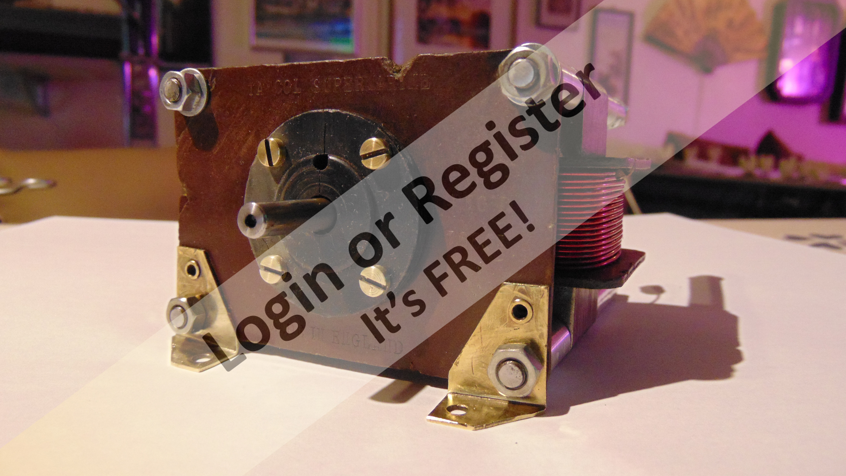

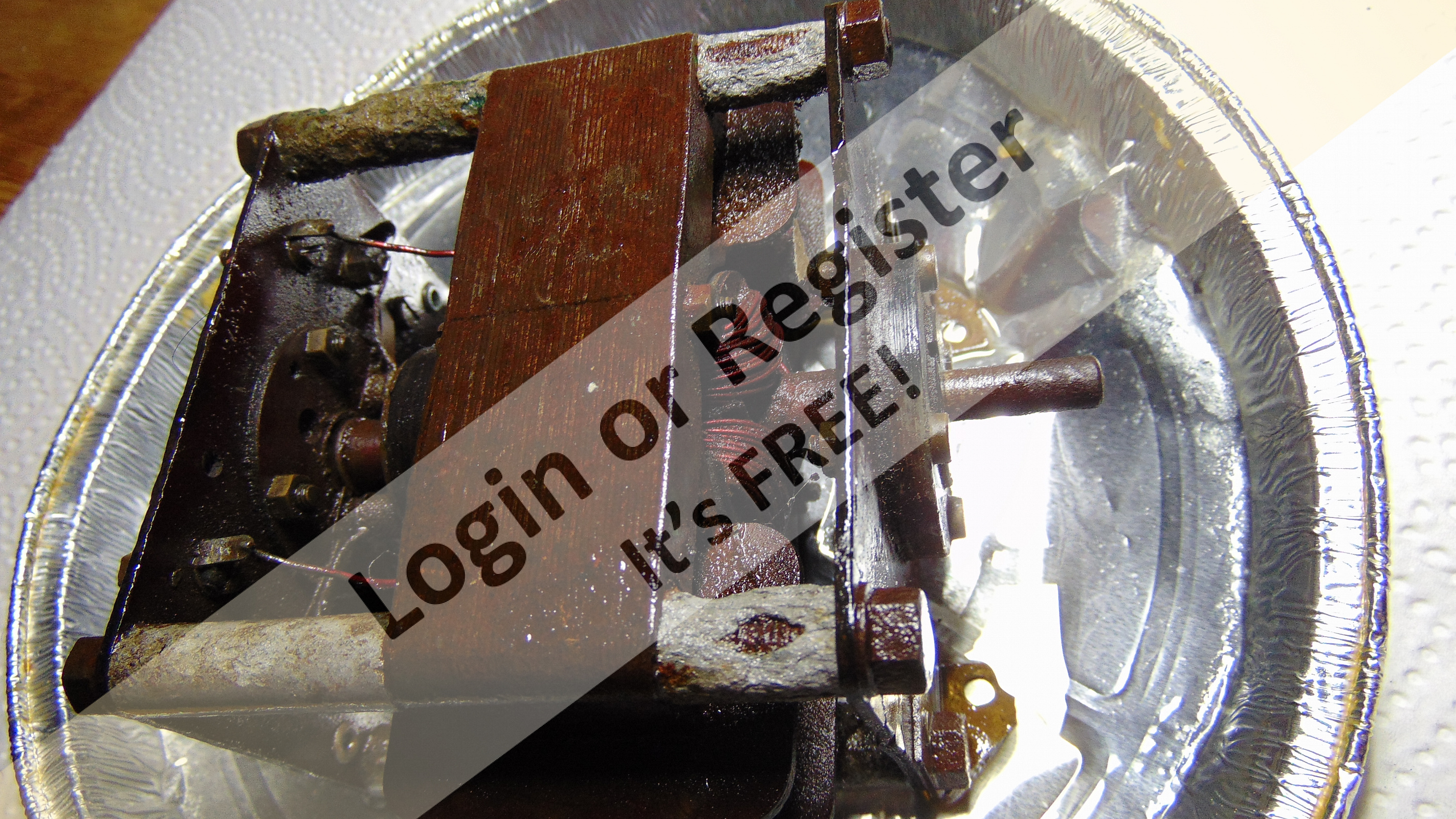

Have had a dig around and found some pics of the restoration and a short vid of a test run.
Attached a few Before and After pics.

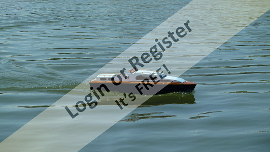

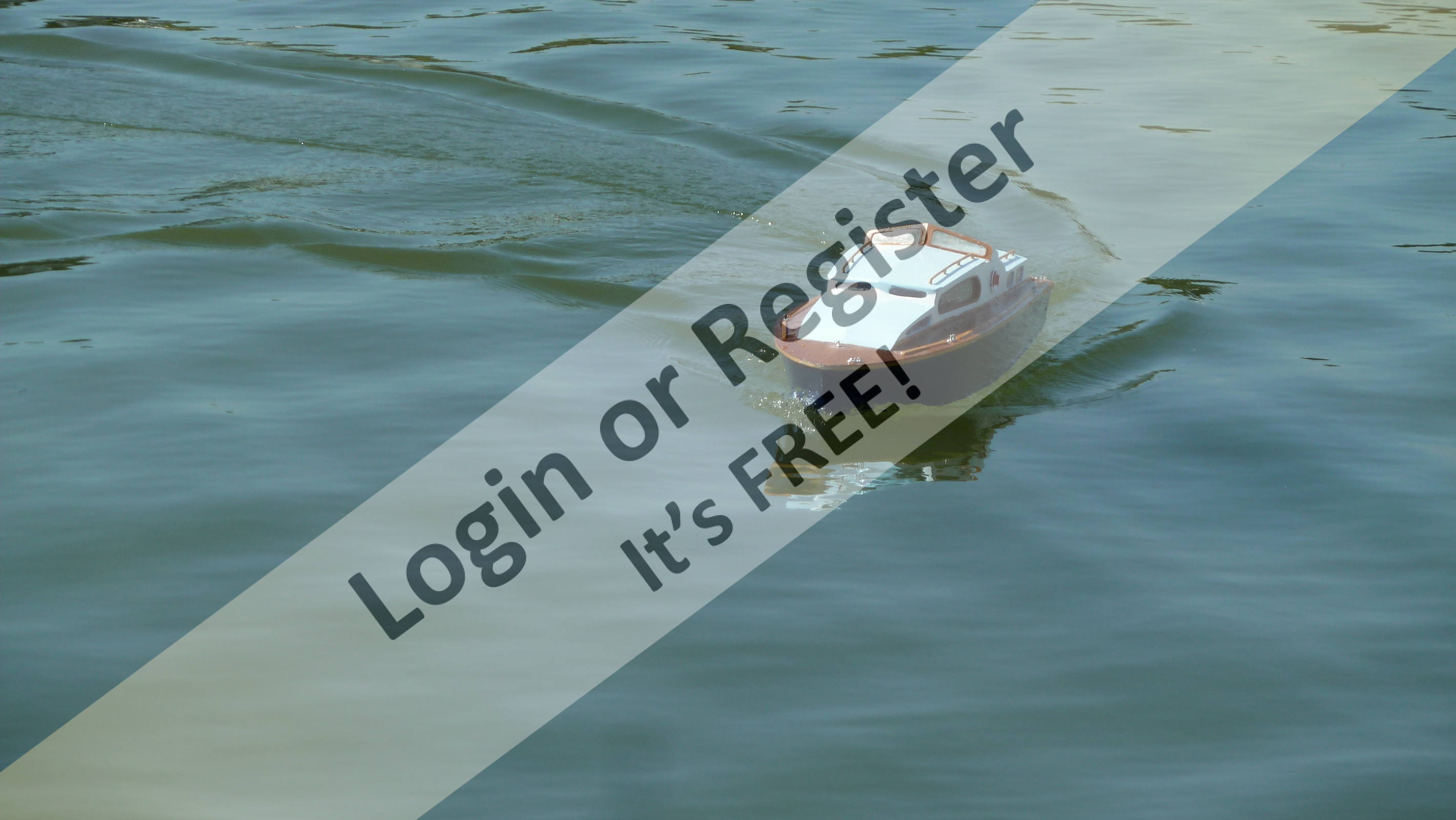

Hi Colin, great to see yet another of the classics restored and now getting some use. I hope that I am able to finish my own Sea Commander to such a good standard.
I agree with your comment regarding the battery weight. Whilst the speed may well be scale like, the boat does appear to sit fairly low in the water, so I believe that a lighter battery would definitely be a good call as it would increase freeboard.
Overall though, a great looking model, well done and time to enjoy it now. Will

Mainly, the diode bridge that I used in the reverser box (to provide forward and reverse with a standard modern ESC) suppresses the sparks😊😀
I should have a test run video and scope traces somewhere (on an old PC) that show this effect. I'll rummage around.
Also I machined and polished the commutator and brush ends for the best possible continuous contact.
I trust that the ball races I fitted will also help to reduce friction and jack up the efficiency a little and thus reduce the current drain a bit 🤞
Very happy to hear (at last!😉) that my efforts (from a corroded 'block' to a humming motor) were not in vain.

Looks really good Colin, seems to sit ok in the water, doesn't look too heavy. You are only running at displacement speed so I don't think it matters. A longer run time is probably more useful.

Good evening guys and gals, my dad's old Sea Commander finally in the water after more than 20 years waiting for my rebuild.
A big thanks to Doug over in Munich for rebuilding the ancient Taycol Supermarine motor for me, and his converter box, which allows it to run in forward and reverse, and use a modern esc and 2.4ghz rc system.
After a long wait for a chance to sail her my son offered to carry it to my local lake which doesn't have easy access, and my 7 year old grandson took the controls whilst his dad filmed it using a smartphone.
It ran really smoothly, didn't take on water, water cooling worked efficiently. My only fear is that the battery is a bit on the heavy side. So may change from 12v 7ah sla. To a lighter 4ah one.
Tell me what you think.
Cheers Colin.
Fair winds and calm waters,
COLIN.
