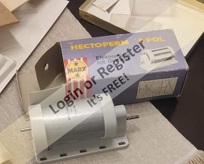

Yep it's a hectoperm same as pic.
6 or 12v still none wiser but it runs on both but a bit sluggish on 6 to fast on 12

Just to remind me did it turn out to be a Hectoperm? They made 6 volt and 12 volt versions of both motors mentioned. If you think 6 volts seems better you probably have a 6 volt version. The 12 volt versions are just a little more efficient than the 6 volt ones.
It all hinges around the brushes and the voltage drop. It is simple arithmetic, will explain if interested!

These are great gear-motors, known as Decaperms.
I believe they are rated for 12 volt, and your ESC is also rated for 12volt, they were sold in North America through Horizon Hobby
I have sold many of these over the years.

This motor I have is two and a quarter inches in diameter. Including shaft 6 inches long and has 5 screw slots each side and power connections are just pins

Hi Colin I have looked at my decaperm and the A & P line up with the V underneath. That is in agreement with your point. I am not going to contest it as there were a few variants but the diameter should resolve it.
When I think about it my old Hectoperm, long gone now, was more than 4 inches long and bigger altogether.
The Decaperm in my hand now, has 4 slotted holes each side and the pictured one has 5, interesting!
The text is DECAPERM in capitols with 6V under but central and below that max 7A

Terry, if you look at the top of your motor it has some letters left from the original label, I can see an A and P which can only be a Decaperm as none of the others have a letter 🅰️.

Hi just remeasured my Decaperm and it is 3 inches, check the diameter my one is 1 3/4 inches dia.
There are several versions of these motors right back to when the series of motors were orange and black.
I agree with the comment of being reliable though.
On the 3rd. original photo there are 5 mounting holes which does suggest the Hectoperm motor.
When the Hectoperm motor was last on sale it was £163 not a realistic price at all.

Hi I have just measured a Decaperm and if the body is 3 inches long then it is a Decaperm. If bigger then it is a Hectoperm.

The motor is a geared Deccaperm. There were 6v and 12v versions and your motor has had the voltage erased so you will have to try with both sized batteries to see which best suits your model and motor. The Esc is I suspect a 12v max 15 amp and not known for their reliability especially if used to their max rating.
Judging by the wooden tray behind the motor an SLA was probably used and my guess would be 6v 10amp.
In the 1960's and 70's the Deccaperm motors were possibly the best and certainly the most expensive motors available. They are however very early versions using technology available at the time. Modern motors use much more powerful magnetic material and modern construction techniques produce much greater power than was previously possible. The Deccaperm had a very good if noisy gearbox which greatly improved the output power of the motor.
Chances are the motor and Esc will work fine and as long as the shaft is oiled/greased and free running you could be afloat in no time.
Plank on frame can be prone to leaking, especially if they have been stored for some years, so I suggest you float in water for several hours to find any leaks before you submit to the local lake.
In its present form it is certainly a classic of its time and it would be a pity to replace the original set up for a more modern system if it is all still functional.
