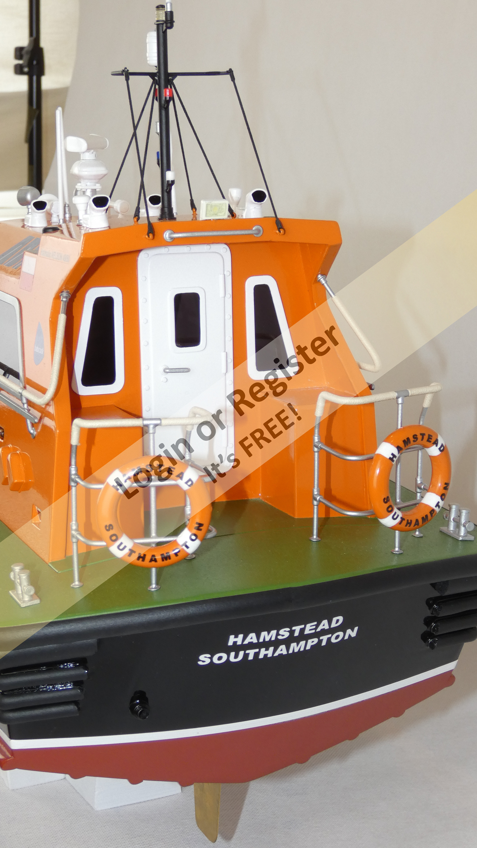

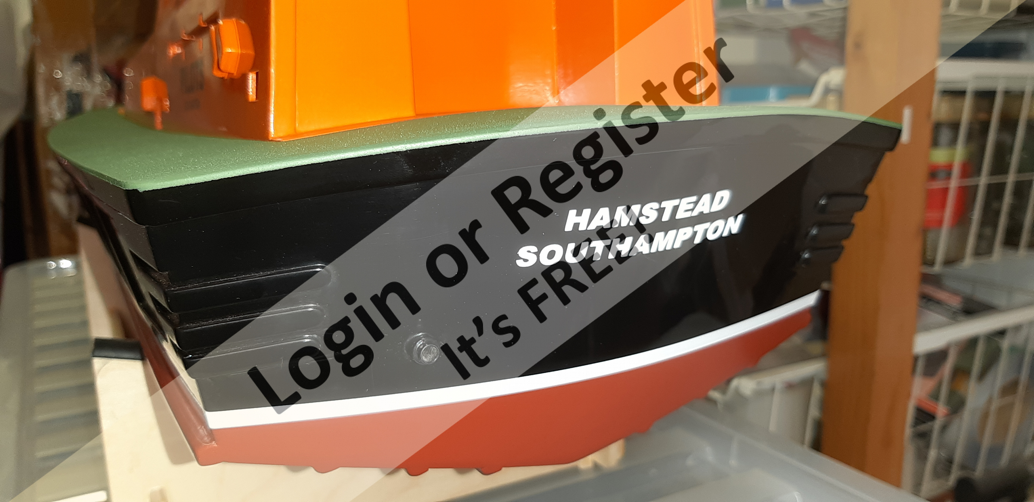

    I see that you have already ordered some stickers elsewhere but I thought you might like to know of a UK supplier that I have used for custom vinyl lettering and numbers.
    I used them for some custom lettering on my Southampton Pilot Boat and they were excellent ๐Ÿ‘.

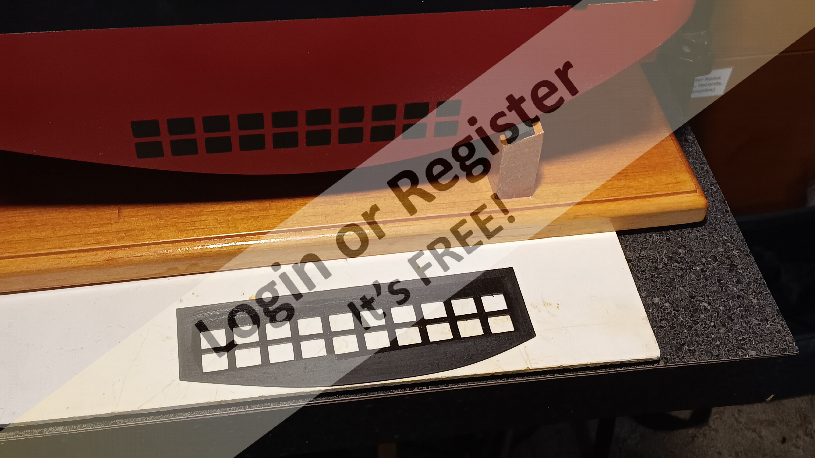

    One more method... you might not have noticed it but on my last Springer tug build I have the simulated openings for the "water coolers" by painting them on (black paint).
    After figuring out the pattern I 3D printed a mask. I then taped it on (both sides) and spray painted the pattern. Attached photo shows the mask and the finished pattern on the hull.
    This could open up an entirely new way of applying artwork. Either make the mask or I assume it is possible to actually 3D print the artwork real thin then cement it to the model. May not work in every instance, but might be worth a thought.
