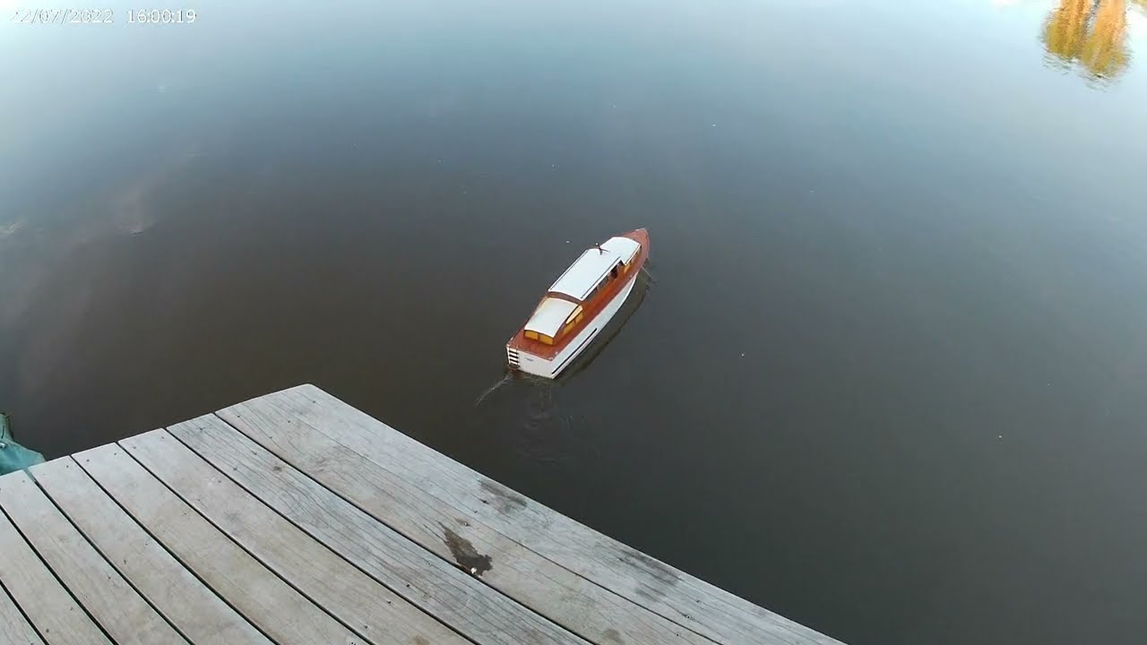

What battery are you using to give you 16.8v as that is pretty high and I reckon you should get on the plane with 11.1v/12v or even less as jbkiwi says.
I think you should be alright with a 40mm prop and I think your problem is a lack of revs. 7000rpm is too low and how are you measuring? If unloaded then definitely too low. You don't want to go too big with the prop as you will probably have overheating problems.
To plane you want around 9000 - 10000rpm loaded, so around 12000rpm unloaded.
Can't find the rpm for your Traxxas motor but I did find one on 24v that only revved to 10000rpm so I'm thinking the 16.8v doesn't rev very high either being as it is a high torque motor for off-road vehicles. Nice motor but I don't think it's suitable for your use.
I can't advise on a motor as I use brushless.
Liked by Razor1955 and PeterL3 and

Yes , want it to go much faster - at least on the plane . I have wired up a 550 mabuchi motor from a 12v drill but i need to make sure i don’t cook it with the 16.4v

Sea trials were a little underwhelming sadly . I have grossly underestimated the rpm of the traxxas titan 775 on 16.4v being 7,000rpm .
The result is a poultry speed as you can see.
So it’s back to the drawing board 🙄
I need to find a 775 motor that can spin the 40mm prop much faster on 16.4v and get it on the plane at least.
Any ideas welcome .

Sea rover cabin cruiser
Sharing a progress update on this sea rover.
I picked this boat up last year very cheap not knowing what I’d do with it.
Its had a long 60-70 year life and at least two different colours being orange then navy - now blue and various engines from ic to electric.
It hasn’t been built to a high standard so I’m having to work with what I have but I’m really happy with the colour - it was nearly bottle green but i changed my mind last minute . I had to build the rear roof as well as replaced the gunwale and installed a chine rail too.
One concern is the bilge has not been water proofed or sealed which can only be accessed by major surgery.
The motor I’ve selected is a traxxas 775 titan swinging a 40”prop . Not sure if I will need 16.8v to get it moving which is what the motor is rated too.
Cheers
