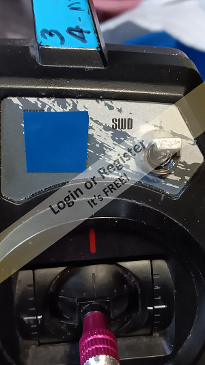

#9 119
Flysky Warning
SimpleSailor, I did it and it works. I used a solder sucker and easily removed the little pc board. I replaced it with one of the many switches I have. Unfortunately I did not have any with similar paddles. Used what I have.
Everyone should note that the Flyskys use a metric threaded switch instead of the same threads. The hole in the case is ok but the sae nuts (1/4-40) are larger than the metric ones (M6 X 0.75) requiring a little material removal on the inside of the case.

Depending on your soldering skills, you could remove the pcb from the switch.
As the old switch is broken, carefully cut the terminals off the old switch, releasing the pcb, then either remove the terminal ends, by de-soldering them from the pcb, or to make life easier, solder 3 small lengths of wire from the new switch to the corisonding pcb cut terminals, and then slip a bit of heat shrink over the pcb to stop it electrically touching anything else in the handset.
I had to change 2 of my switches from the on/off, to on/middle/off type, and had to use a bit of veroboard to replicate the pcb on the extra switches.

Hi Lew
I had to replace one of mine. I purchased the switch from Amazon and replaced it on the small attached PCB. A bit of care is required so that the PCB tracks are not damaged. The actual assembly is made by Flysky so would only be available from them.
Liked by hermank and PhilH
#1 119
Flysky Warning
As you might remember, I was a proponent of using Flysky radios. Well, one of the switches (SWC) has been broken internally for a while and I took some time tonight to repair it.
These switches seem to be different from regular toggle switches as they have a small pc board withe surface mount resistors on them.
Trying to find an oem replacement is proving to be difficult or expensive. Is the FS-i6S-X a throw away item?
The Flysky site mentions that shipments to the US are suspended.
So that spot on the transmitter is covered up. Not much of a problem right now as I don't need that many channels yet.
