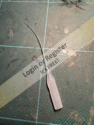

I bought a pack of 100 of those spouts, they work fantastically and prevent the cyno from drying out

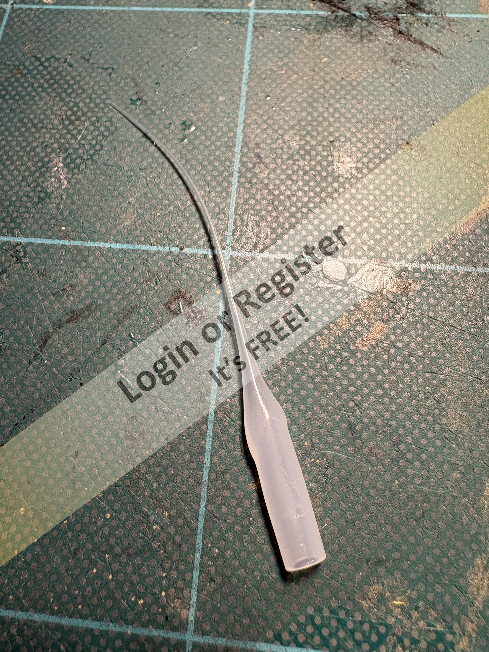

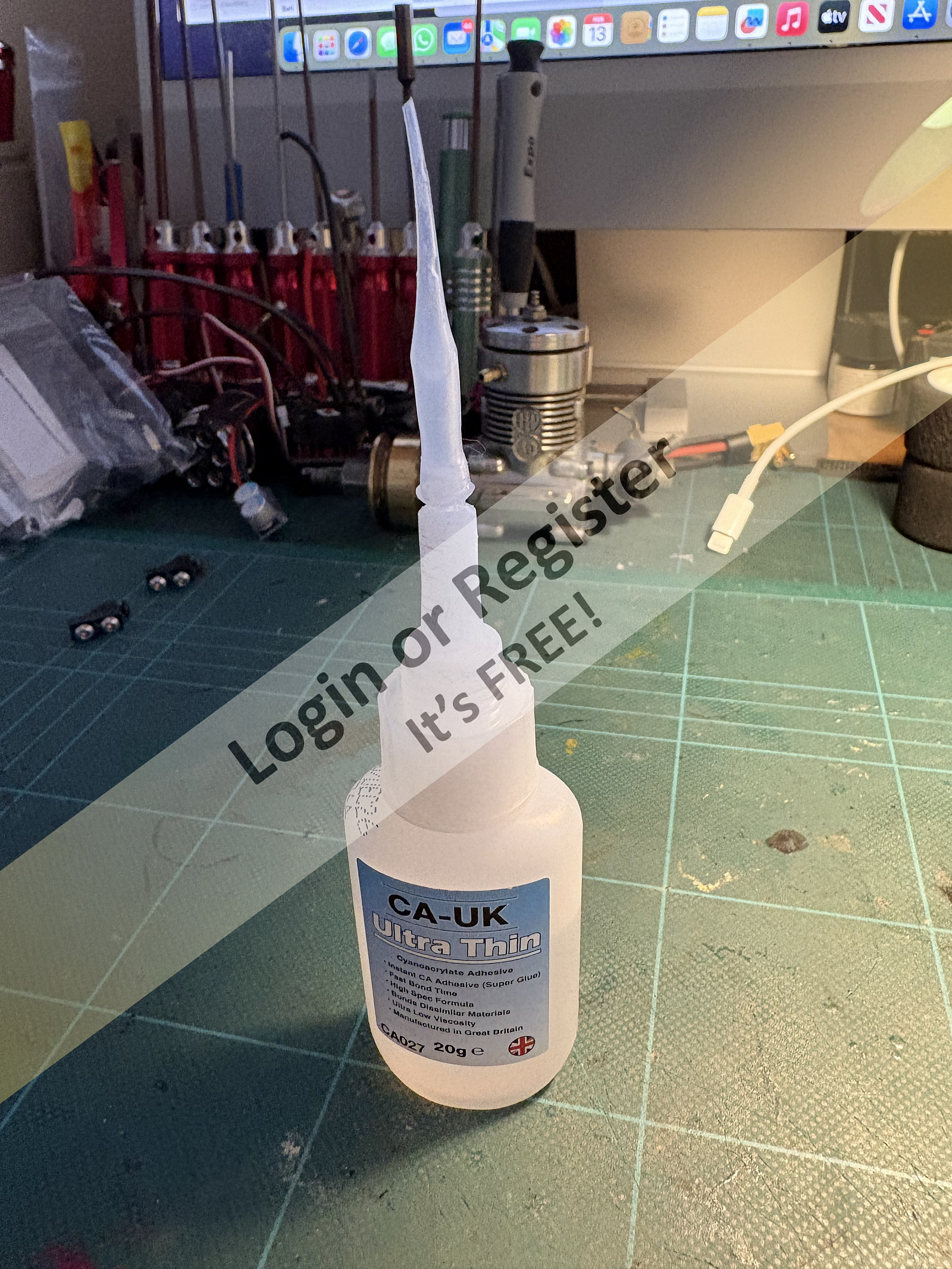

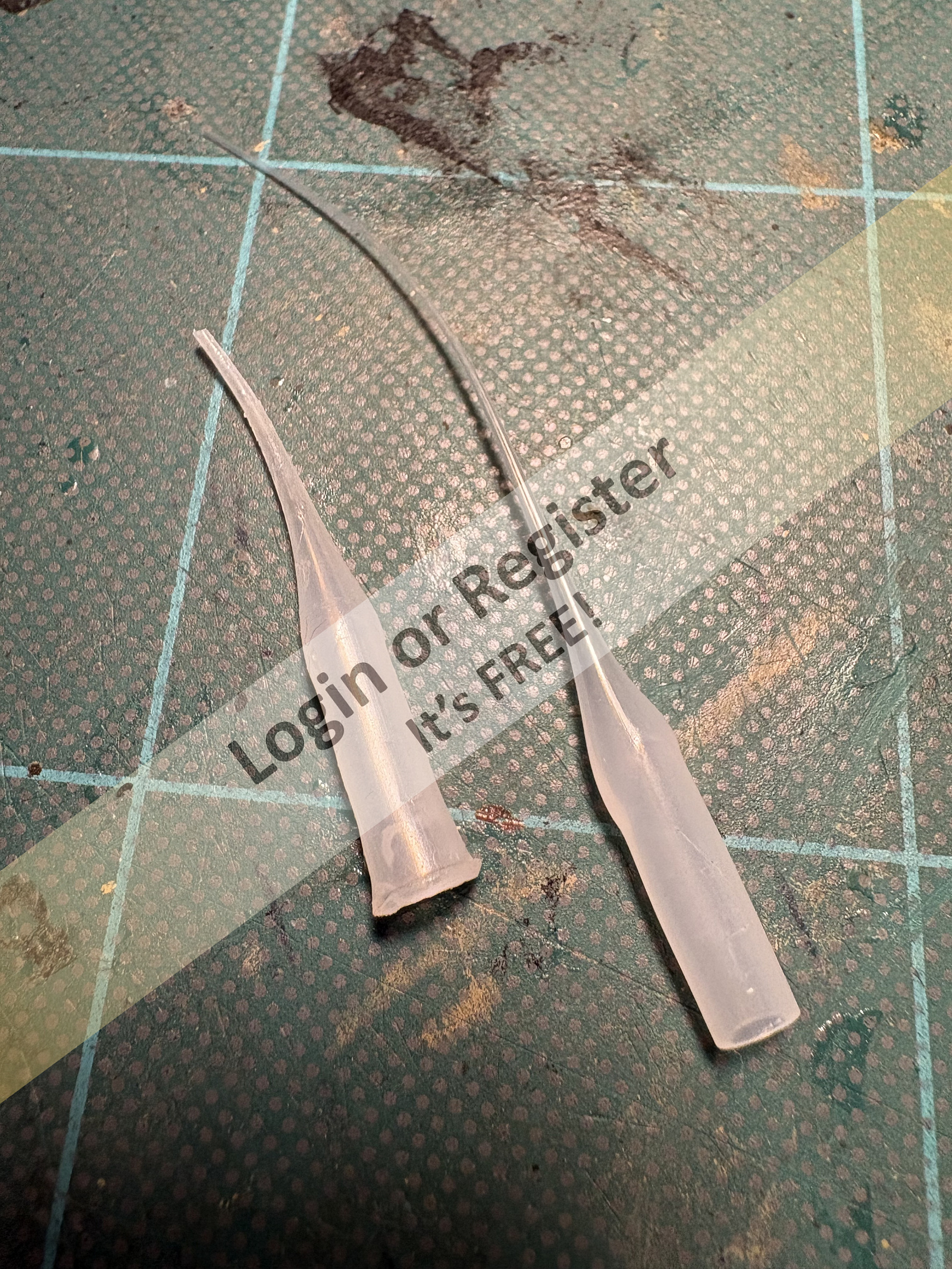

Hi Jump,
These little "push-on" spouts make it easy to control even the very thinest super-glues.
The second picture shows how much I cut off of mine to get the best control and accurate flow rate when using the thinnest glues.
I warm the end that pushes onto the glue bottle to soften it enough to push over the glue bottle's regular spout. This gives it a good tight leak-free fit.
After use, I remove these extension spouts and place them upright onto a piece of scrap card underneath it so that the unused glue runs down onto the card and effectively drains it so that it can be use several times over.
