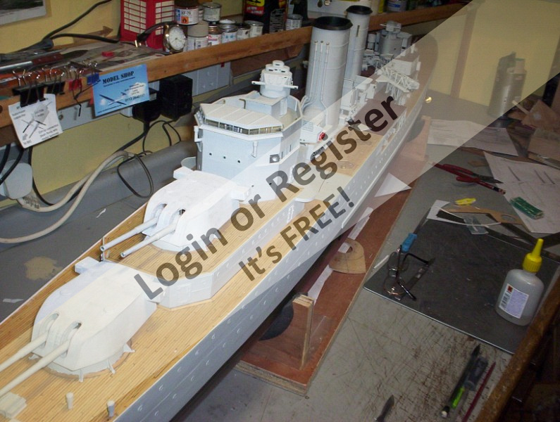

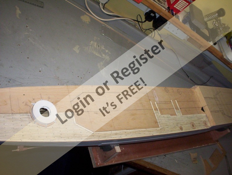

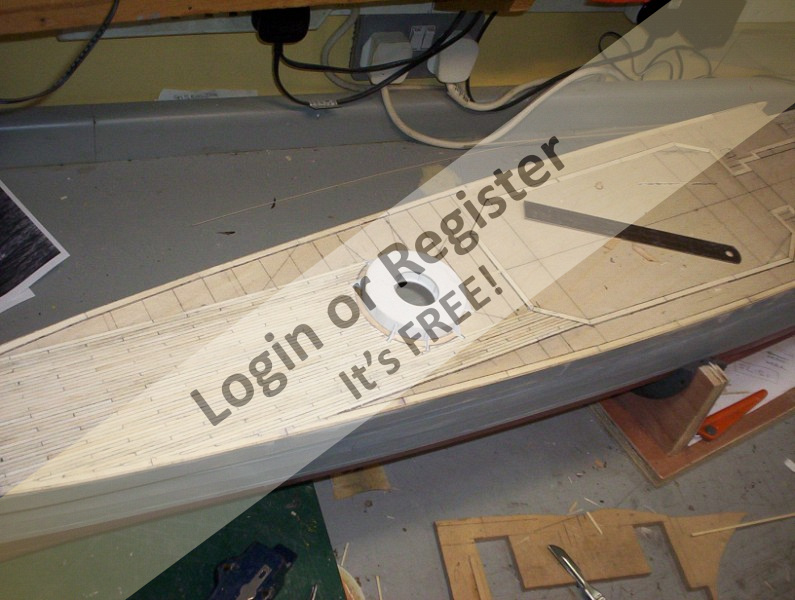

Here is a picture of my model of HMS Exeter over 1000 deck planks which I glued in place.
John

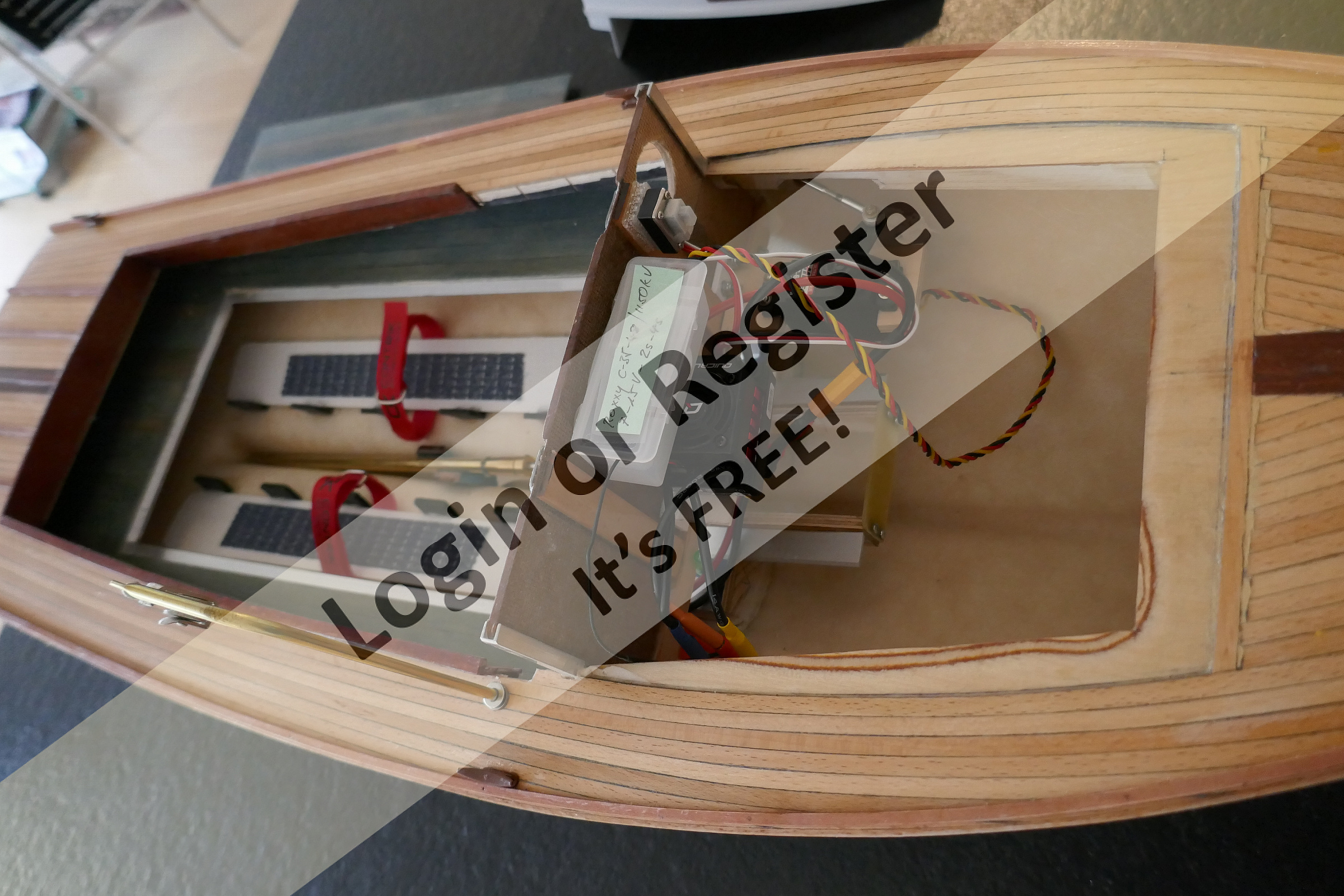

I use PVA glues for this job: UHU Express or Ponal Express. They are easy to apply, dry within 10 minutes (if the joint is stressed, I leave it for 1/2 hour) and sufficiently waterproof. Another great advantage: glue at the wrong places can be wiped away with a damp rag. To lay bended planks I jam the planks (several at a time) with some scrap balsa and weigh everything down with barbell weights (use the rubberized version, they stick much better to the underground). The deck of the lobster boat in the picture was done that way.
