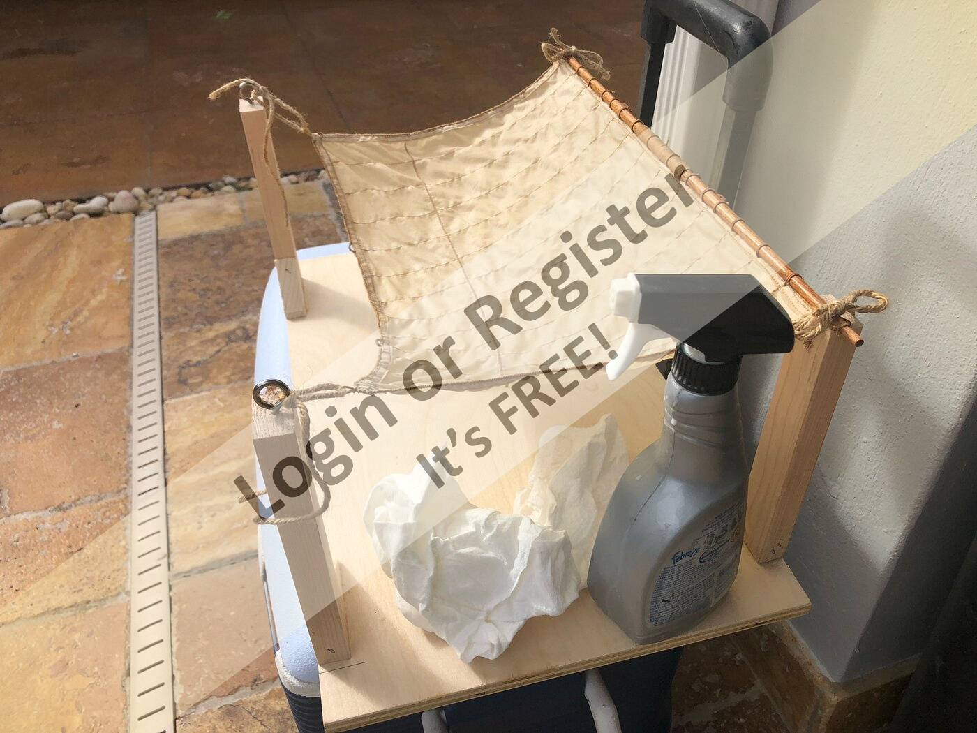

I made a sail out of real sail material that I got from a marine supplier. I ordered the lightest they had. So far it has lasted more than 40 years. Hope this helps
To stiffen the sail so it will keep the shape I wanted it, I made a 70/30 white glue solution and brushed into the cloth.
let it out in the Florida sun and it was dried in a few minutes.
After it dried front the first coat of the water/glue solution, I diluted the existing formula once again but this time to be 85% water and 15% glue.
This permitted me to spray it with a bottle in the back and front of the sail without detaching it from the jig.
I kept some paper towel to absorb the excess puddles.
I’m pleased with the final results.
