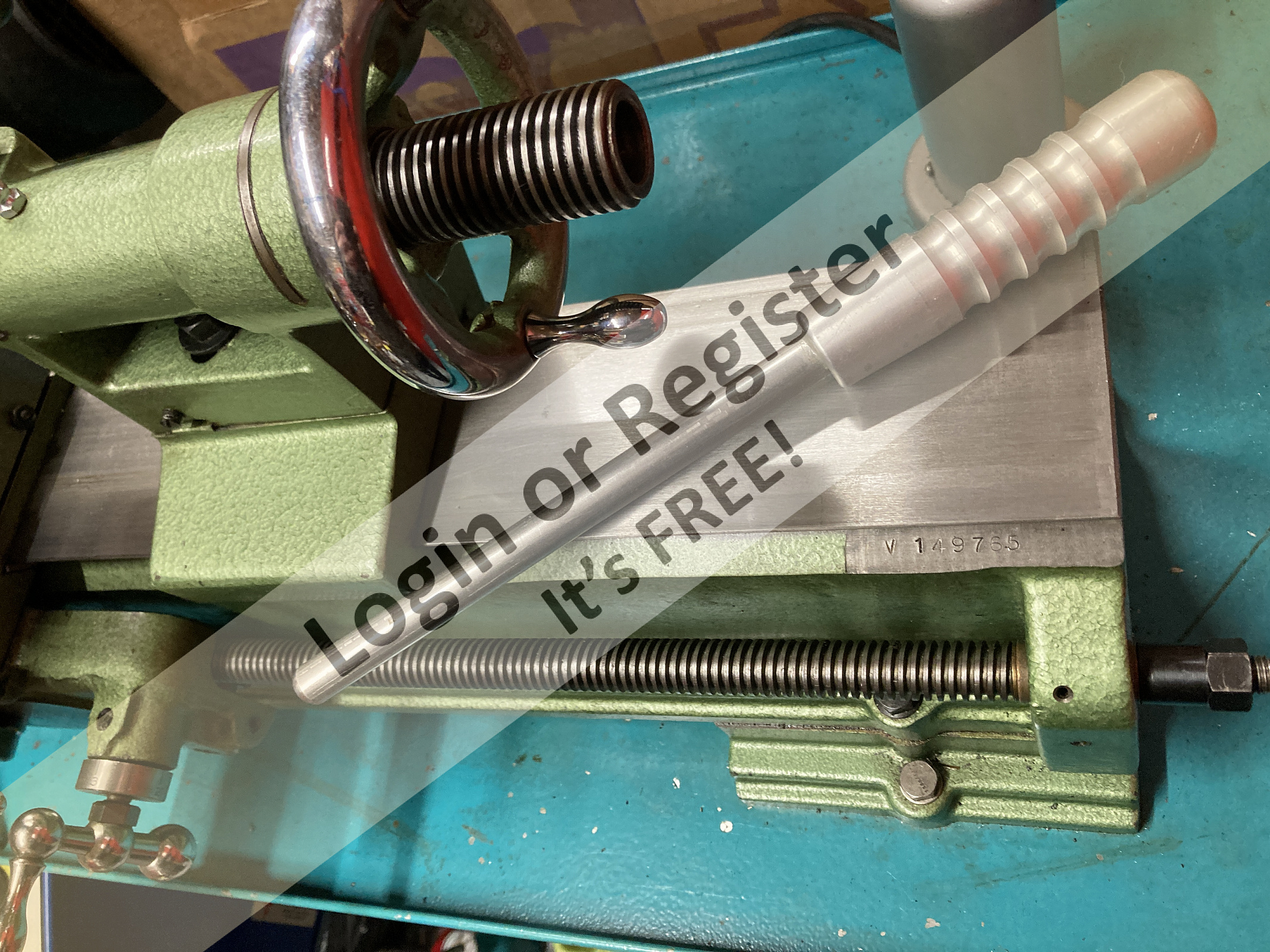

One of the small inconveniences of running a Myford ML10 (or a Myford ML7) is that the tailstock is not "self-ejecting" .
This means that the end of the taper that is inserted in the tailstock needs to be "knocked-out" with something inserted into the hollow tailstock shaft.
A little tool shaped like the ones that I have can be easily made on the lathe and only need a light (hand held) tap to loosen what ever tool is held in the tailstock at the time.
This tool is convenient to use and protects the tailstock from having "unsuitable" items being pushed into the tailstock, and the large turned handle never needs anything other than a hand held "tap" to loosen the taper grip. 👍
This idea can be used on any make of lathe that does not have a self-ejecting tailstock, and the size can be adjusted to suite the tailstock of the lathe being used.

Different metals and plastics etc need to be turned at different speeds so that they cut cleanly and don't over-heat the cutting tool (or the material being cut).
For general purpose turning the speed of the chuck can be judged without reference to any charts, and practical experience of actually using the lathe soon determines what speed you are comfortable with when machining different types and sizes of materials.
To avoid any gear changes at all, I removed the traditional motor and on/off switch and replaced them with a TESLA variable speed control and that makes turning with this machine "whisper quiet" and is a very pleasant experience.
Fitting the TESLA variable speed control system has transformed the lathe.
It has a simple (green) start button and a (red) stop button.
A knob allows you to select the direction of turn (clockwise or anti-clockwise) and another knob allows you to dial-in the speed that you would like to use.
The speed control is variable and is very precise and has plenty of power.
Simples 👍
Simples 👍
