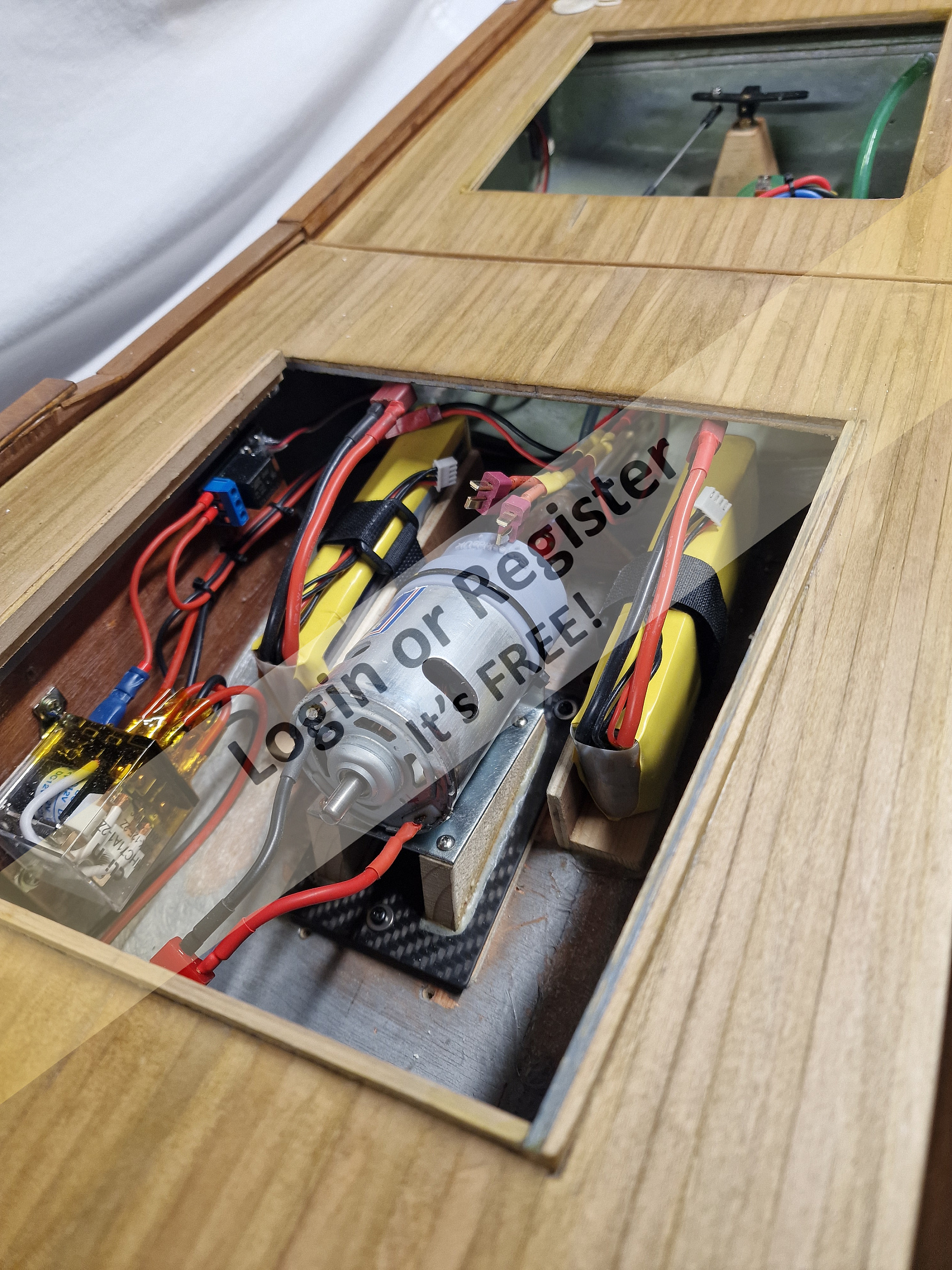

Zooma.. I had a different issue, but needing the same solution.. (I have an ESC WITH a reverse function that I disabled as I don't have a reverse throttle stick position on my Transmitter!!)
The attached photos show my solution. A 12v single throw, double pole relay, wired to reverse the polarity on the motor by flicking a switch on my transmitter. I now just view the throttle lever as an RPM device and the switch as the Forward/Reverse, kinda like a real cruiser!
BTW, this relay is a 30amp device.. (much more than the stall current on my 800 motor!)
This setup would also allow you to swap/reverse 2 of the 3 supply wires to your Brushless motor..
You might want to try a Watt meter on your setup to see what the actual peak current your motor draws.. A 150amp ESC on full load would blow the brains out of ANY mechanical switching device, in which case you SHOULD consider a Forward/Reverse Brushless ESC, providing your Transmitter will support this function on the throttle stick!!

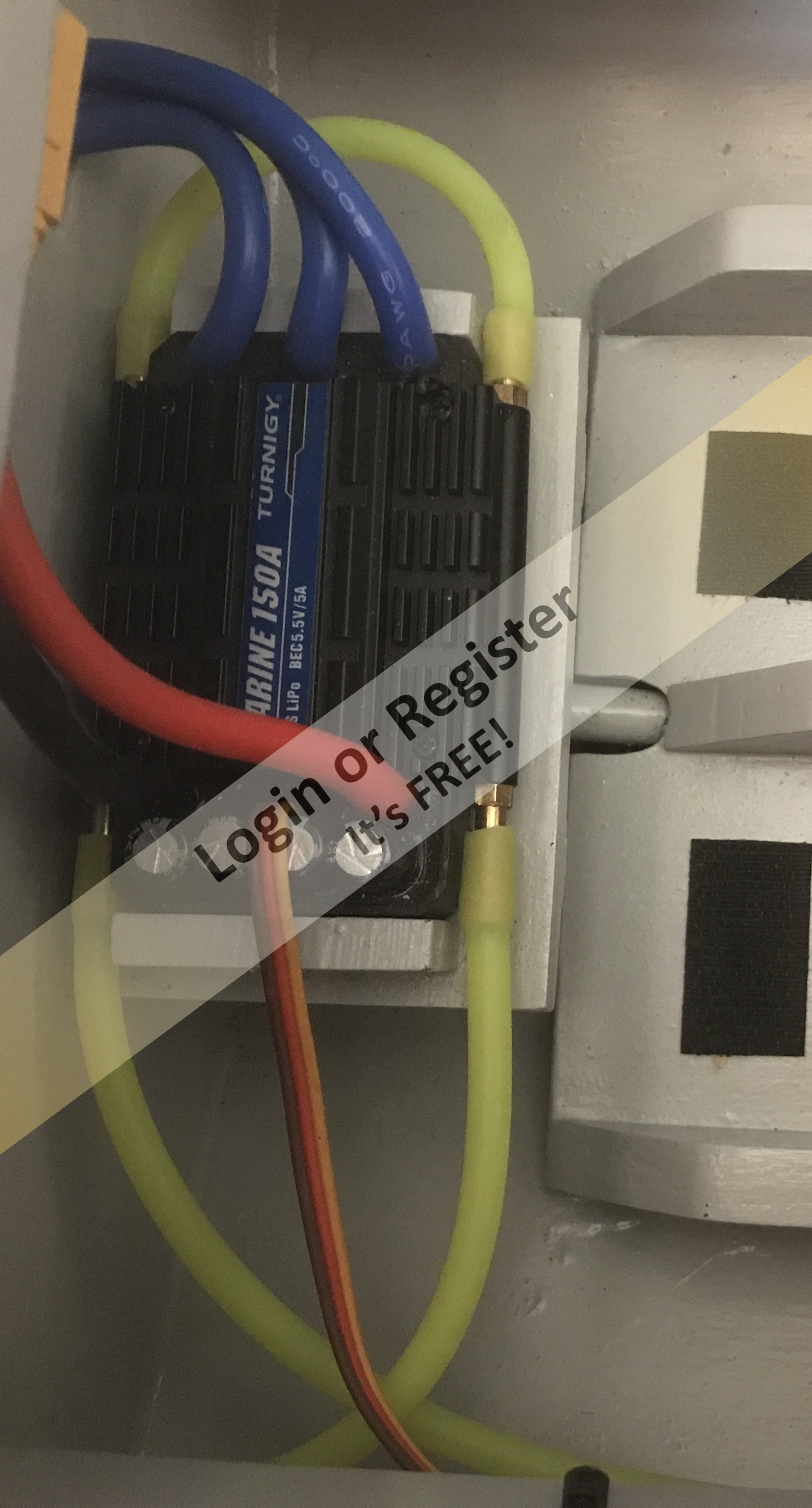

I am not too sure about that Chris.
Most of mine are branded ‘Sea King” but others have the Hobby King brand on them - but they are all water-cooled ‘forwards only” ESC from the same manufacturer.
Pictured is the 150A ESC that I have in my Rapier, and that one is branded Turnigy as it is sold by HobbyKing, but I have the same ones branded Sea King which I believe is the manufacturers own brand name?
When I get home I can picture some of them and the two different branded boxes they came in.
